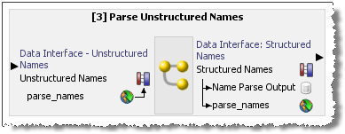

First create the job and drag the process onto the Canvas:
Then double-click the input and output Data Interfaces to select the Mappings.

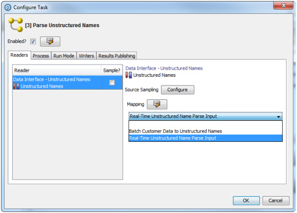

For the input Data Interface, select a web service input that has been mapped to the Data Interface:

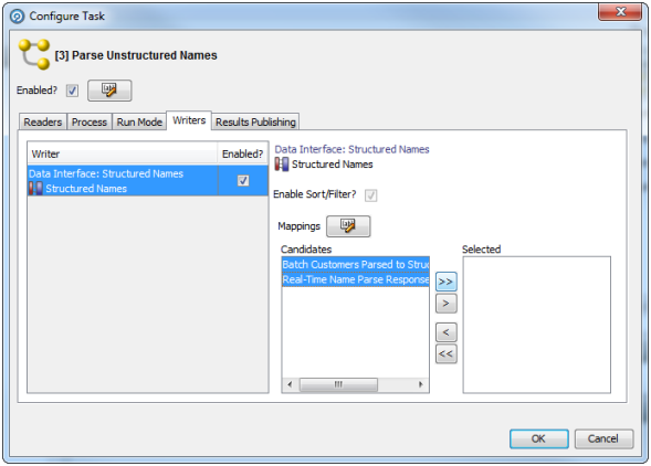

For the output Data Interface, select both a 'Batch' (staged data) mapping, and a 'Real-Time' (web service output) mapping using the dialog below:

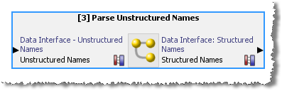

Click OK to save. The job appears as follows, and is now ready to be run or scheduled:
