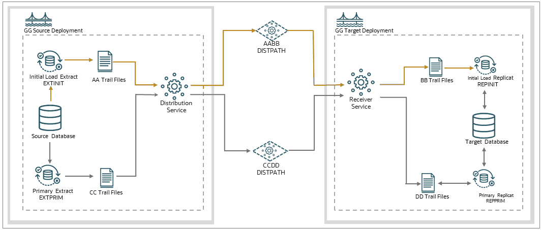

The initial load method is highly suitable for instantiation in the following scenarios:
  • Loading target database with a small set of tables from the subset of the source database.
  • Loading data in a heterogenous environment
The initial load Extract works by reading data directly from the source tables and writing it into an EXTFILE. It directly connects to the database and fetches the changes. As shown in the following diagram, there are two phases when performing an initial load instantiation. The EXTINIT Extract is the initial load Extract and the EXTPRM is the primary Extract. The EXTPRM process is set up but not started for continuous replication. After the intial load Extract completes instantiation, then the continuous replication process is started from the point when the intial load was initiated.
To configure this Extract, you'll require a combination of file-based initial load and change data capture (CDC) processes. The instantiation process using the initial load Extract includes the following tasks:
  • Add and configure an Initial Load Extract: This Extract is used to copy the existing contents of one or more tables from the source to the target database.
  • Configure Change Data Capture: Used to copy transactional changes from the source to the target database.
Microservices Architecture doesn’t support loading data with an Oracle GoldenGate direct load.
File-based initial load process is the preferred method for performing data replication in MA. It’s key components are:
  • Initial Load Extract and Replicat: Replicates the existing content of the database tables.
  • Primary Extract and Replicat: Replicates change data from the database tables.
  • Distribution Paths: Transfers trail files to the target system.
Before you begin, make sure that the database credential alias (USERIDALIAS) is created.
You can use the Oracle GoldenGate web interface, Admin Client, or cURL commands to set up this configuration.

Step 5: Create the Distribution Paths
Create two distribution paths (AABB and CCDD) for copying the local trails to the remote host from the Admin Client:
