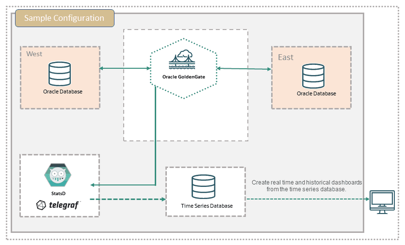

Oracle GoldenGate generates metrics in StatsD format and transmits them directly to a network daemon that supports ingestion of StatsD-formatted metrics.
The following diagram shows the Oracle GoldenGate side and the enterprise side where the StatsD server is hosted. The performance metrics data is transformed by the Oracle GoldenGate container application and it is written to the StatsD server.
StatsD Server aggregates performance metrics data sent by the Oracle GoldenGate Application in the StatsD format.

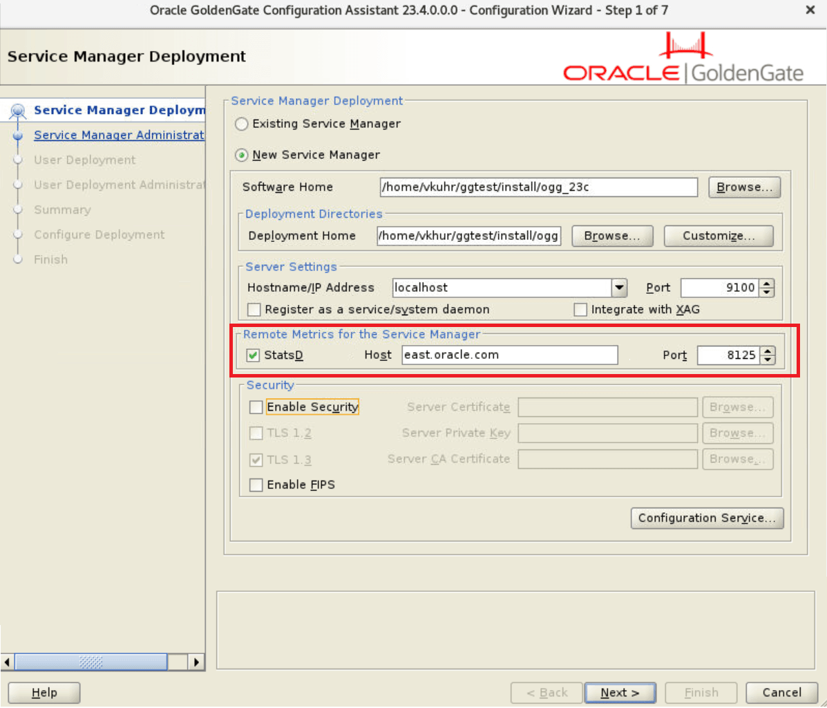

StatsD can be enabled using the OGGCA utility, while configuring the Service Manager and deployments. When you run the OGGCA utility, the option to enable StatsD is available in the Service Manager Deployment screen and in the User Deployment screen, as shown in the following images:
OGGCA Service Manager deployment screen with the StatsD option enabled

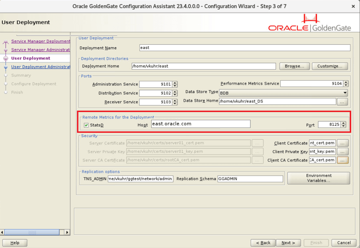

You can use the same host for setting up StatsD for the Service Manager and deployment. The following image shows the option to enable StatsD in the User Deployment screen.
The option to enable StatsD in the User Deployment screen in OGGCA.
You can set up a Telegraf host on the same machine as the Oracle GoldenGate installation or you can set up a remote server to host Telegraf and receive the Oracle GoldenGate metrics from StatsD.
For details about using OGGCA, see Add a Deployment.

Disable StatsD using OGGCA
To disable the StatsD service for an existing deployment, run the OGGCA configuration wizard and perform the following steps:
  1. Deselect the StatsD option from the Service Manager Deployment screen.
    OGGCA Service Manager deployment screen with the StatsD option enabled. This option needs to be disabled to disable the StatsD server.
  2. Click Next and finish the steps in OGGCA wizard.
