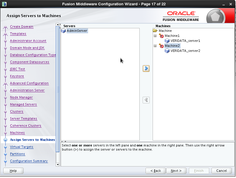

  9. In the Assign Servers to Machines page, assign the managed servers to the respective machines, and click Next.
    Assign Servers to Machine page
