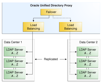

3.2.3 Configuration 3: Failover Between Data Centers
When you configure failover between data centers, you are essentially deploying two levels of load balancers within the proxy. This enables you to enhance the high availability.
Let’s examine a failover scenario. In this deployment topology, the data centers are replicated and the remote LDAP servers within the data centers are also replicated. The first load balancing element of the deployment can be either failover or saturation. The example assumes failover algorithm is selected for the initial load balancing element.
As illustrated in Figure 3-3, all of the requests are routed by the failover load balancer through the main route, to a second load balancing element, which sends the request to a server within Data Center 1. Here, LDAP Server A...L is a server that holds entries for users whose names start with A through L. If Data Center 1 goes down or is degraded, then the traffic is routed by the failover load balancer to the backup route, to a server in Data Center 2.
The requests are routed to the remote LDAP servers within the data centers based on the load balancing algorithm set. The load balancing algorithm can be different for each data center. For example, you can set the load balancing in Data Center 1 as proportional
, while the load balancing algorithm in Data Center 2 is set as saturation
This type of deployment is typically used when deploying in two geographical areas. This adds high availability of data to a simple load balancing deployment, since not only are the remote LDAP servers replicated, but the data centers are also replicated.
Typically, you would have the two data centers in two different geographical locations. This way, if there was a problem in one location, the data center in the other location would act as backup. Another example would be setting the first load balancer to saturation
. This way, if Data Center 1 in one geographical location (for example in one time-zone) becomes saturated, the other data center can pick up the excess traffic.

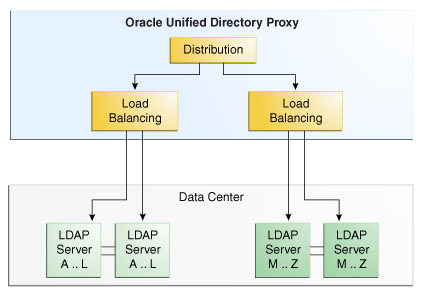

3.2.4 Configuration 4: Distribution with Load Balancing
When you configure distribution with load balancing, data is split into partitions. In addition, the data is replicated on the remote LDAP servers.
In such a situation, the requests sent to the proxy are first distributed to the partition in which the data is stored, then the request is routed to one of the remote LDAP servers, depending on the load balancing algorithm set. The remote LDAP servers holding the partitioned data are replicated.
As illustrated in Figure 3-4, when the proxy receives a requests, it is filtered by the distribution to the correct partition. Here, LDAP Server A...L is a server that holds entries for users whose names start with A through L. Similarly, LDAP Server M…Z holds entries for users whose names start with M through Z. For example, a request for entry with a cn such as Garry
would be forwarded to partition 1, to the servers with data from A..L
. The load balancer then forwards the request to one of the replicated remote LDAP servers.
Figure 3-4 Distribution with Load Balancing
Description of "Figure 3-4 Distribution with Load Balancing"
The requests are routed to the remote LDAP servers within the data centers based on the load balancing algorithm set. For more information about the different load balancing algorithms, see Overview of Load Balancing Using the Proxy.
The advantages of this deployment are the speed of the updates, because of the distribution of data, and high availability of the data.

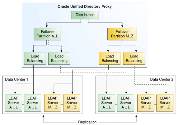

3.2.5 Configuration 5: Distribution with Failover Between Data Centers
You can configure a topology that includes distribution with failover load balancing. In such a scenario, data is split into partitions between two data centers, where each partition is managed through a failover load balancing route.
Consider the following scenario. As illustrated, in Figure 3-5, not only are the remote LDAP servers holding the partitioned data replicated within the data center, but in addition, the data centers are replicated, with one of the two acting as the backup. Here, LDAP Server A...L is a server that holds entries for users whose names start with A through L. Similarly, LDAP Server M…Z holds entries for users whose names start with M through Z.
Figure 3-5 Distribution with Failover Between Data Centers
Description of "Figure 3-5 Distribution with Failover Between Data Centers"
In other words, requests sent to the proxy are first distributed to the partition in which the data is stored. For example, a request for entry with a cn such as Garry
would be forwarded to partition 1. The failover load balancer then forwards the request through the main route, depending on the load balancing algorithm set, to one of the one of the remote LDAP servers holding the data for A..L
In the deployment illustrated in Figure 3-5, Data Center 2 acts as a backup, and is only used on failure of the first data center. However, this same deployment could be configured to use saturation
, rather than a failover load balancer. This way, if Data Center 1 in one geographical location (for example in one time-zone) becomes saturated, the other data center can pick up the excess traffic.
The advantages of this deployment are the speed of the reads through the distribution algorithm, and the high availability offered since the remote LDAP servers are replicated, and one data center acts as a backup.

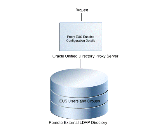

3.2.6 Configuration 6: Enterprise User Security
When you configure the proxy for Enterprise User Security (EUS), the configuration details are stored locally in the Oracle Unified Directory directory server, and the remote external LDAP directory contains only the Enterprise Users and the Enterprise Groups details.
As illustrated in Figure 3-6 the remote external LDAP directory contains only the Enterprise Users and the Enterprise Groups details.
The requests are routed to one of the remote LDAP servers based on the load balancing algorithm set during deployment.

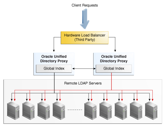

3.2.7 Configuration 7: Multiple Replicated Proxies
You use a hardware load balancer to manage multiple proxy instances on separate physical machines or in different geographical locations.
To prevent a Single Point of Failure, you should ensure that your deployment is redundant. Typically, this can be done by installing a third party hardware load balancer, as illustrated in Figure 3-7.
This example illustrates how to use a hardware load balancer to manage multiple proxy instances.
When running multiple proxy instances in a distribution deployment with a global index catalog, the global index catalog should be replicated. For more information about replicating the global index catalog, see Replicating Global Index Catalogs.
To configure this proxy deployment, see Setting Up Oracle Unified Directory as a Proxy Server section in the Installing Oracle Unified Directory.
