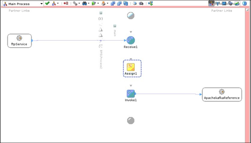

Produce Messages to an Apache Kafka Topic
You can configure a SOA composite application to read records using the FTP Adapter and stage file read action and publish them to an Apache Kafka topic using the Apache Kafka Adapter produce operation.
The following integration provides one example of how to implement this pattern:
- A SOA composite application with a project.
- A BPEL process to perform appropriate source-to-target mappings between the SOA composite and the FTP Adapter.
- An FTP Adapter to fetch files (records) from an input directory and put them in a download directory.
- A stage file action configured to:
- Perform a Read File in Segments operation on each file (record) in the download directory.
- Specify the structure for the contents of the message to use (for this example, an XML schema (XSD) document).
- Perform appropriate source-to-target mappings between the stage file action and an Apache Kafka Adapter.
- An Apache Kafka Adapter configured to:
- Publish records to a Kafka topic.
- Specify the message structure to use (for this example, an XML schema (XSD) document) and the headers to use for the message.
- A BPEL process to perform appropriate source-to-target mappings between the Apache Kafka Adapter and FTP Adapter.
- An FTP Adapter to delete files from the download directory when processing is complete.
The completed SOA composite application looks as follows:

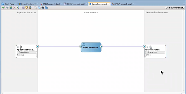

Consume Messages from an Apache Kafka Topic
You can configure a SOA composite application to use the Apache Kafka Adapter to consume messages from an Apache Kafka topic.
The following use case provides one example of how to implement this pattern:
- Consume records from a Kafka topic.
- Specify the consumer group to attach. Kafka assigns the partitions of a topic to the consumers in a group.
- Specify Read latest as the option for consuming messages. The latest messages are read starting at the time at which the SOA composite is deployed.
The completed setup looks as follows:
