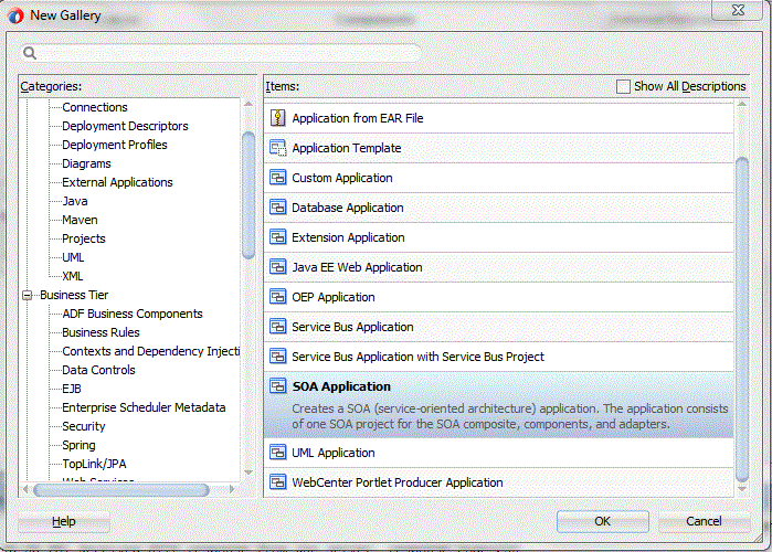

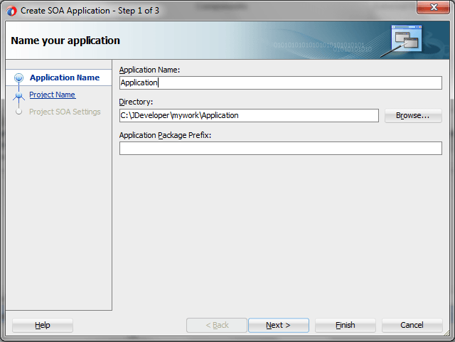

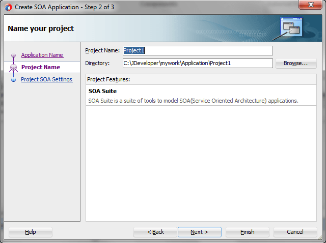

In the File menu of JDeveloper, click New and select Application.

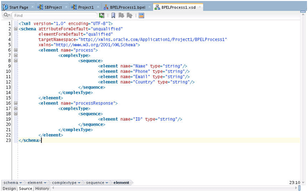

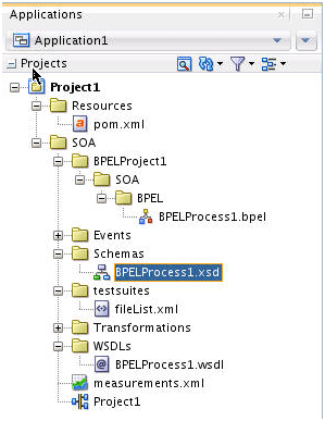

In the Application Navigator, under the Schemas folder, Oracle JDeveloper displays an XML schema file with the name BPELProcess1.xsd after BPEL process creation.
Edit this schema file as your business needs require. It is the responsibility of the front-end application to enforce data validations and to ensure that the input sent to the Oracle RightNow Cx Server from SOA is error-free.
The structure of the schema used in this use case is as shown below.
