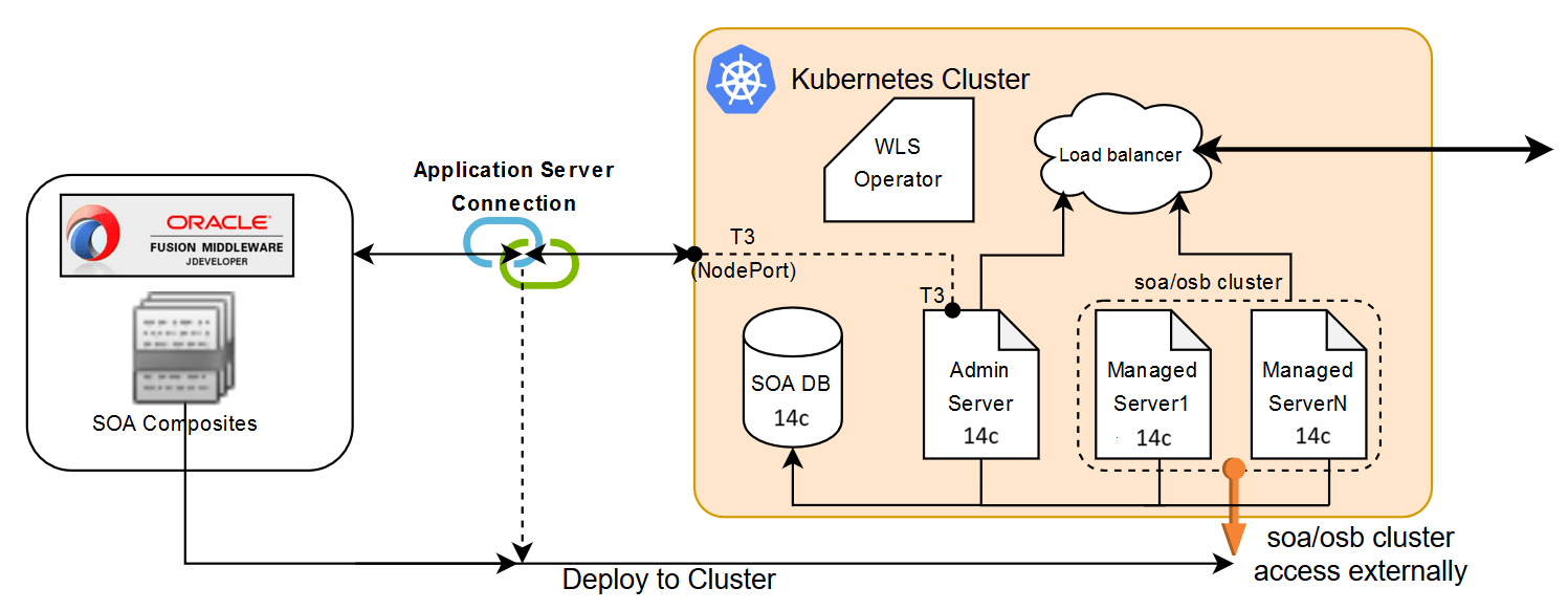

To deploy Oracle SOA Suite and Oracle Service Bus composite applications from Oracle JDeveloper, the Administration Server must be configured to expose a T3 channel. The WebLogic Kubernetes Operator provides an option to expose a T3 channel for the Administration Server using the
exposeAdminT3Channelsetting during domain creation, then the matching T3 service can be used to connect. By default, whenexposeAdminT3Channelis set, the WebLogic Kubernetes Operator environment exposes theNodePortfor the T3 channel of theNetworkAccessPointat30012(uset3ChannelPortto configure the port to a different value). -

JDeveloper needs to access the Servers during deployment. In the WebLogic Kubernetes Operator environment, Administration and Managed Servers are pods and cannot be accessed directly by JDeveloper. As a workaround, you must configure the reachability of the Managed Servers:

- Decide on an external IP address to be used to configure access to the Managed Servers. Master or worker node IP address can be used to configure Managed Server reachability. In these steps, the Kubernetes cluster master IP is used for demonstration.
- Get the pod names of the Administration Server and Managed Servers (that is,
<domainUID>-<server name>), which will be used to map in/etc/hosts. - Update
/etc/hosts(or in Windows,C:\Windows\System32\Drivers\etc\hosts) on the host where JDeveloper is running with the entries below, where:<Master IP> <Administration Server pod name> <Master IP> <Managed Server1 pod name> <Master IP> <Managed Server2 pod name>Sample /etc/hosts entries looks as follows, where
X.X.X.Xis the master node IP address:X.X.X.X soainfra-adminserver X.X.X.X soainfra-soa-server1 X.X.X.X soainfra-soa-server2 - Get the Kubernetes service name of the Oracle SOA Suite cluster to access externally with the master IP (or external IP):
kubectl get service <domainUID>-cluster-<soa-cluster> -n <namespace>For example:
kubectl get service soainfra-cluster-soa-cluster -n soans -
Create a Kubernetes service to expose the Oracle SOA Suite cluster service (<domainUID>-cluster-<soa-cluster>) externally with same port as the Managed Server:
kubectl expose service <domainUID>-cluster-<soa-cluster> --name <domainUID>-<soa-cluster>-ext --external-ip=<Master IP> -n <namespace>For example:
kubectl expose service soainfra-cluster-soa-cluster --name soainfra-cluster-soa-cluster-ext --external-ip=X.X.X.X -n soans
