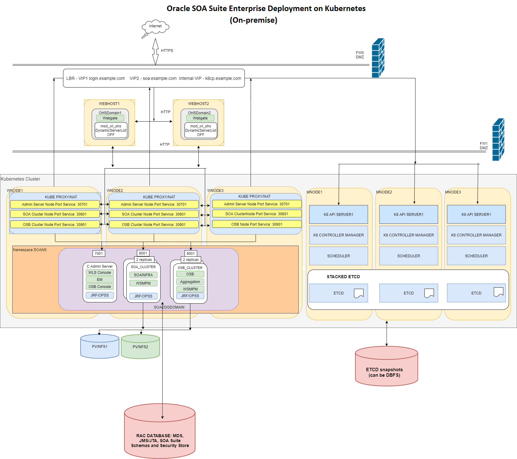

Topology diagram
Figure 10-1 Topology

Control plane
The control plane consists of three nodes where the Kubernetes API server is
                deployed, front-ended by a load balancer (LBR). The LBR exposes the required virtual
                IP address (VIP) and virtual server (VS) for both the Oracle SOA Suite and the
                control plane itself (although an internal-only VS can also be used). This URL must
                be site or data center agnostic in preparation for disaster protection. The control
                plane and worker nodes must be able to resolve this hostname name properly AND
                SHOULD NOT USE IPs for it. As explained in the assumptions section, the etcd tier is
                stacked with the kube-api servers. Each control plane node runs Kubernetes
                    kube-api, kube-controller,
                    kube-scheduler, and etc  instances pointing to local etcd
                mounts. The etcd has been tested by the Maximum Availability Architecture (MAA) team
                on DBFS, NFS, and local file systems. No significant performance differences were
                observed between the two options for an Oracle SOA Suite system. However, this
                decision may require additional analysis in each customer case depending on the
                usage by other apps in the same cluster. Using etcd directly on DBFS allows shipping
                etcd directly to secondary data centers and allows flashing back quickly to previous
                versions of the control plane using DB technology. However, it creates a dependency
                between etcd and the database that is discouraged. The etcd snapshots CAN, however,
                be placed on DBFS to simplify the continuous shipping of copies to secondary regions
                and leaving it to Data Guard. These are the options that will be applicable or not
                depending on the customer needs:
- Place etcd on root or local volumes, ship snapshots with regular rsyncs over reliable networks.
 - Place etcd on NFS, ship snapshots with regular rsyncs over reliable networks.
 - Place etcd on NFS or local volume, copy snapshots to DBFS for shipping to secondary.
 - Application tier.
Application Tier
Oracle SOA Suite internal applications and custom deployments on SOA (composites) and WebLogic (ears, jars, wars) are run on three worker nodes in the Kubernetes cluster. The typical allocation on Kubernetes places the WebLogic Administration Server on the first node and each of the servers in the Oracle SOA Suite and/or Service Bus clusters in the other two. This can vary depending on the workloads and kube controller and scheduler decisions.

The OHS/DMZ tier routes to the back-end WebLogic clusters and Administration Server, using a precise node port available in the different nodes.
External subsystems: LBR, OHS, and Database

OHS routes to precise node ports for the SOA Cluster, OSB Cluster, and Administration Server. This is based on the fact that Oracle SOA Suite exposes very few services, which do not change much through the system’s lifecycle. This also avoids overhead and dependencies on ingress and additional third party controllers. The OHS configuration is similar to a standard on-premises configuration, except that it disables the Dynamic Server list and uses the list of worker nodes with the precise node port for each cluster.
