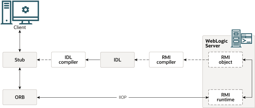

IDL Client (Corba object) relationships
Learn how the IDL takes part in the RMI-IIOP model.

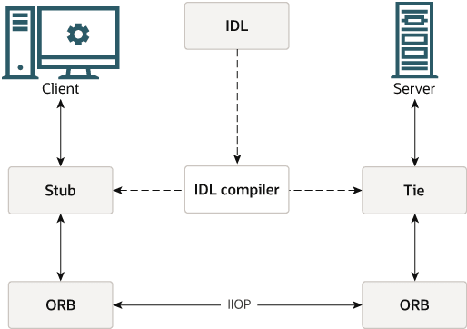

WebLogic RMI over IIOP object relationships
Learn about the object relationships when using RMI-IIOP to connect a client and server.
Figure 4-2 WebLogic RMI over IIOP object relationships
Description of "Figure 4-2 WebLogic RMI over IIOP object relationships"
