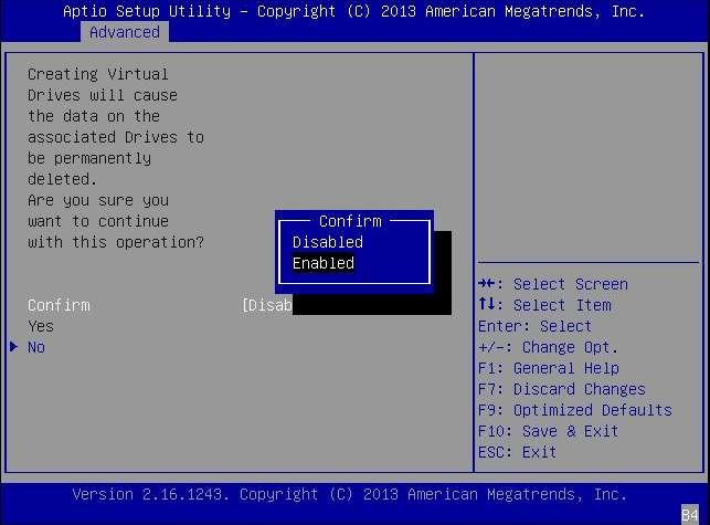

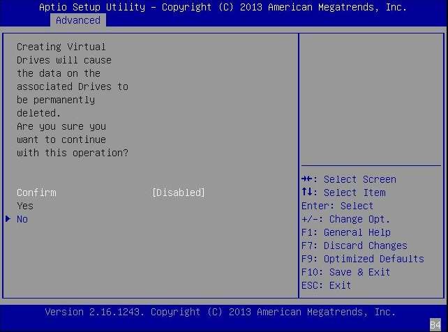

    1. Use the arrow keys to navigate to the Confirm field, and press Enter.
    2. From the popup window, change the value of the Confirm field to Enabled, and press Enter.
      Graphic that shows how to enable the confirm field

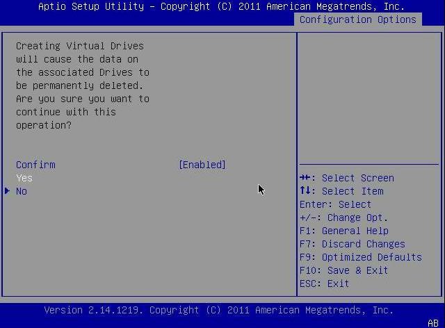

    3. Use the arrow key to navigate to the Yes field, and press Enter.
      Graphic that shows how to confirm the creation of a logical drive

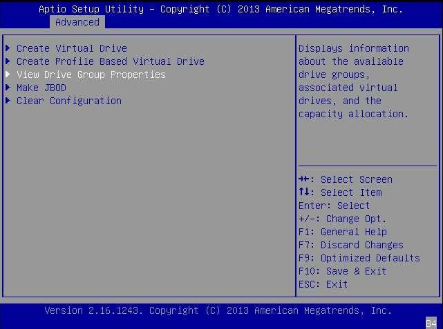

  4. To verify that the logical drive (virtual drive) was created, press the Esc key to return to the Configuration Utility menu, use the arrow keys to navigate to the View Drive Group Properties menu option, and press Enter.
    graphic that shows how to view the new virtual drive properties
