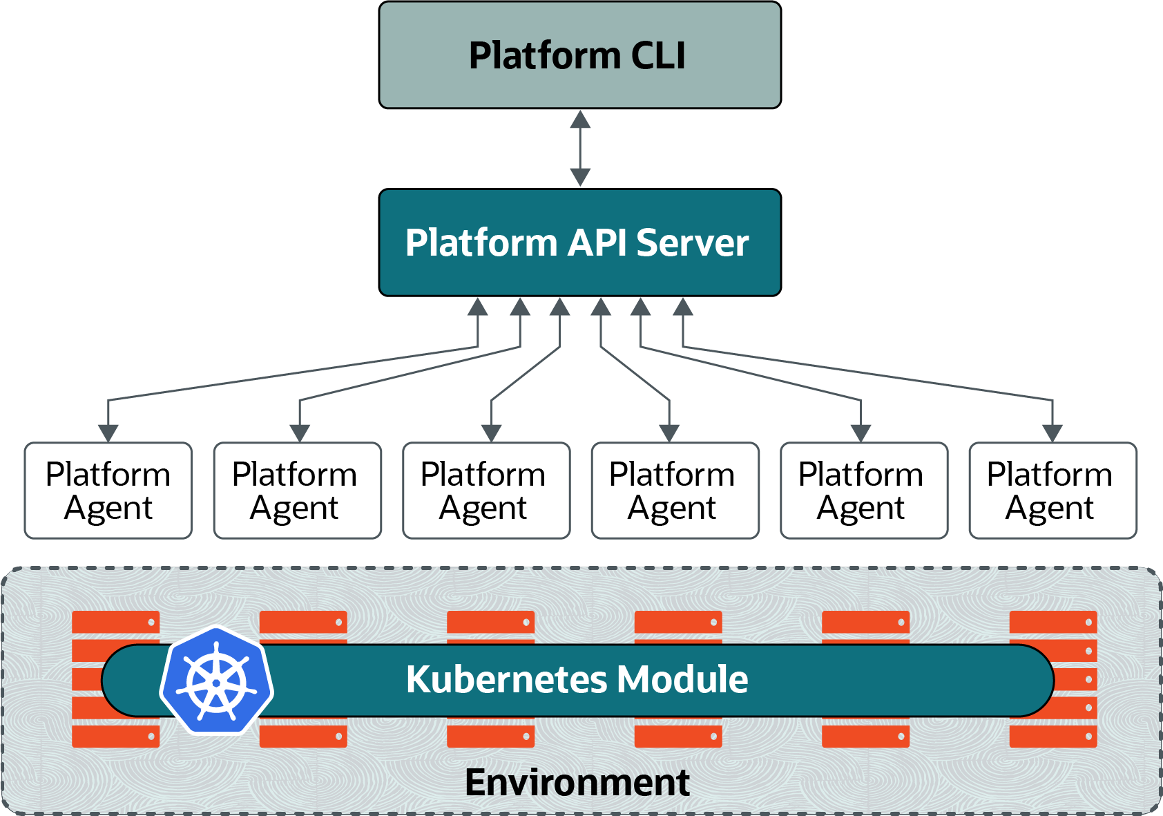

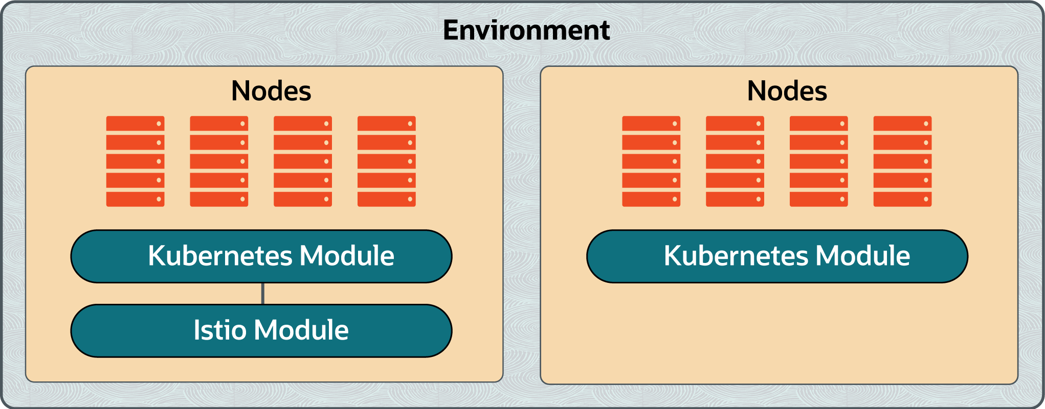

Environments
An environment is a namespace that encapsulates the software installed and managed by Oracle Cloud Native Environment. Each environment contains at least the Kubernetes module.
The Platform CLI lets you create and manage many deployments. Each deployment contains an environment, and each environment might contain many modules. This lets you create many Kubernetes clusters using the same Oracle Cloud Native Environment installation. Each Kubernetes cluster must have dedicated nodes, a server can't be used in two clusters, or environments.
Figure 4-1 Environments
This figure shows an environment, which contains two Kubernetes clusters, one of which also has an Istio module deployment.

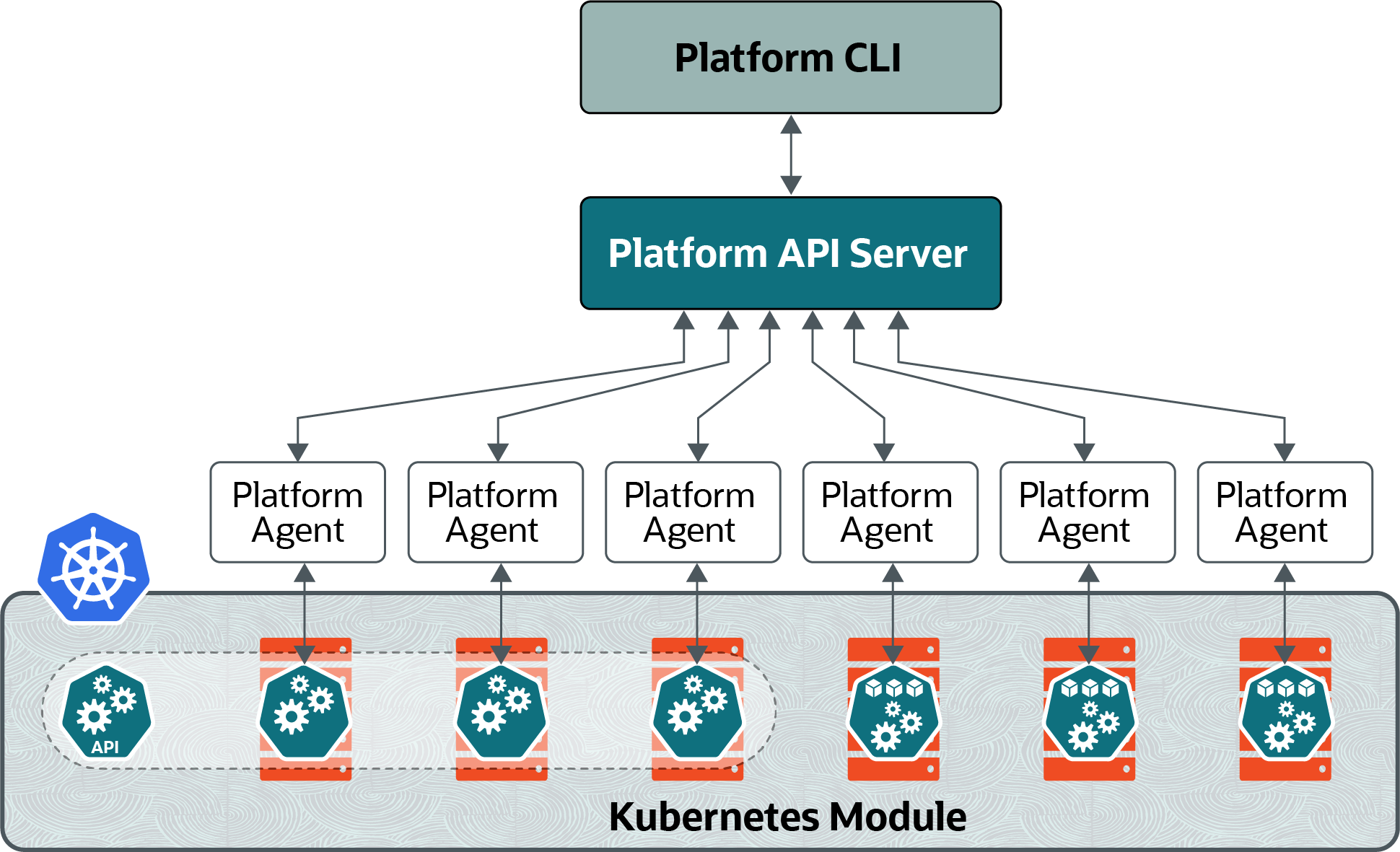

Kubernetes Module
The core module in Oracle Cloud Native Environment is the Kubernetes module. The Kubernetes module is used to deploy a Kubernetes cluster in an environment.
Figure 4-2 Kubernetes module
This figure shows a Kubernetes module deployed to nodes.
The Kubernetes module installs and configures Kubernetes on the nodes and sets up the cluster.
Figure 4-3 Kubernetes cluster
This figure shows how the Kubernetes cluster is deployed to the nodes.
