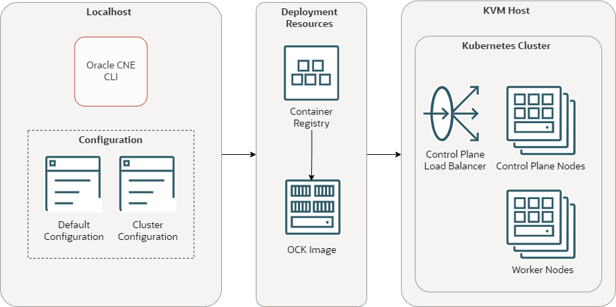

Figure 3-1 libvirt Cluster Architecture
This diagram shows the architecture of a Kubernetes cluster created using the libvirt provider. The CLI pulls the OCK image from the container registry and uses that to deploy a cluster on a KVM host.
The libvirt cluster architecture has the following components:
  • CLI: The CLI used to create and manage Kubernetes clusters. The ocne command.
  • Default configuration: A YAML file that contains configuration for all ocne commands.
  • Cluster configuration: A YAML file that contains configuration for a specific Kubernetes cluster.
  • Container registry: A container registry used to pull the images used to create nodes in a Kubernetes cluster. The default is the Oracle Container Registry.
  • OCK image: The OCK image pulled from the container registry, which is used to create Kubernetes nodes.
  • Control plane load balancer: A load balancer used for High Availability (HA) of the control plane nodes.
  • Control plane nodes: Control plane nodes in a Kubernetes cluster.
  • Worker nodes: Worker nodes in a Kubernetes cluster.

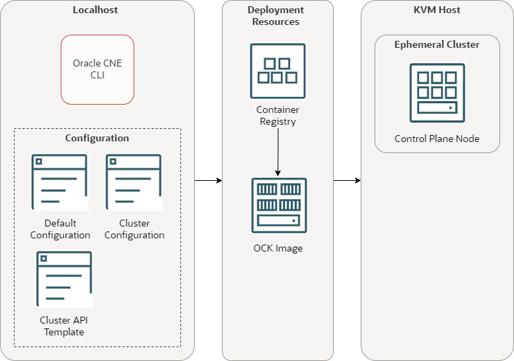

The libvirt provider is also used to provision Kubernetes clusters when using some CLI commands. This cluster type is often referred to as an ephemeral cluster. An ephemeral cluster is a single node cluster that lives for a short time and is created and destroyed as needed by the CLI. An existing cluster can also be used as an ephemeral cluster by including the location of a kubeconfig file as an option with CLI commands.
Figure 3-2 libvirt Ephemeral Cluster
This diagram shows the ephemeral cluster is used to perform some CLI tasks. This is a single node cluster, running on a KVM host.
The ephemeral cluster architecture has the following components:
  • Cluster API template: A YAML file that contains Cluster Resources for the Kubernetes Cluster API to create a cluster.
  • Ephemeral cluster: A temporary Kubernetes cluster used to perform a CLI command. The default for this is a single node cluster created with the libvirt provider on the localhost. This might also be an external cluster.
