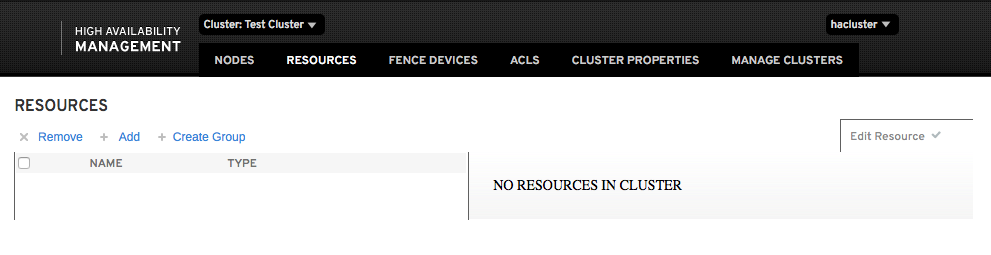

Adding Resources to the Cluster
You add resources and services to for the cluster's operations through the Resources page.
Figure 7-7 Resources
Add resources to the cluster as follows:
Click + Add.
The Add Resource window opens.
Select a class or provider from the pull-down list.
The selection determines which types of resources are available to add.
Select the resource type from the pull-down list.
The resource type you select automatically creates a description of the selection. For example, the apache service is described as Manage an Apache web server. More information about the type is viewable through the information icon.
Required: Specify a valid resource ID.
Optionally, configure the other listed parameters.
You can configure Optional and Advanced Arguments later.
Click Create Resource.
The created resource is added to the list.
