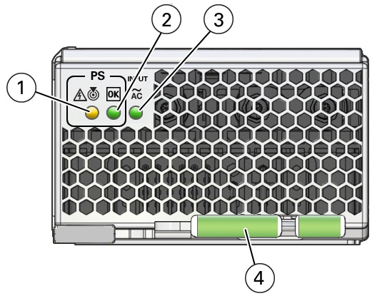

The following status indicators (LEDs) are lit when a power supply fault is detected:
Front and back Fault-Service Required LEDs
Amber Fault-Service Required LED on the faulty power supply
Back Power Supply Fault-Service Required LED located on the server front panel FIM
Call Out Status LED or Button Icon and Color Description 1
Locate LED
Amber
White
Indicates the location of the power supply in the server:
Off – Power supply is operating normally,
Fast blink – Use Oracle ILOM to activate this LED to enable you to locate a power supply quickly and easily.
Lights steady on when the power supply is in a fault state.
2
OK
Power Supply OK LED
Green
Indicates the functional state of the power supply:
Off – PS is disconnected
Steady On – PS is powered on and functioning normally. When this LED is lit, the AC OK LED is also lit.
Note: Oracle ILOM signals a fault on any installed power supply that is not connected to an AC power source, since it might indicate a loss of redundancy.
3
AC OK LED
~AC
Green
Indicates the operational state of the power supply:
Off – PS is not connected to an AC power source.
Steady On – PS is connected to a properly rated AC power source.
4
Ejector lever
None
Used to release the power supply from the chassis

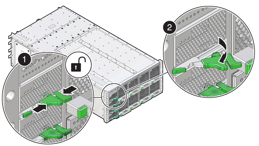

To access the FIM release latch, remove the top power supply (PS3). -
To unlock the power supply lever, squeeze together the two green release
latches at the end of the lever (1).
This action is accompanied by a click sound.
To disengage the power supply from its internal connector, rotate the
lever to the left (2).
Caution:
Pinch point. When operating the lever, keep your fingers clear of the hinged end of the lever.The pawl at the hinged end of the lever engages the sidewall of the server and provides the pivot point for leverage to disengage the power supply. This action leaves the power supply extending partially from its slot.

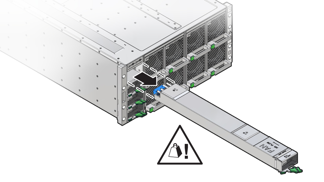

To remove the power supply, use two hands to slowly slide it completely
out of the server.
