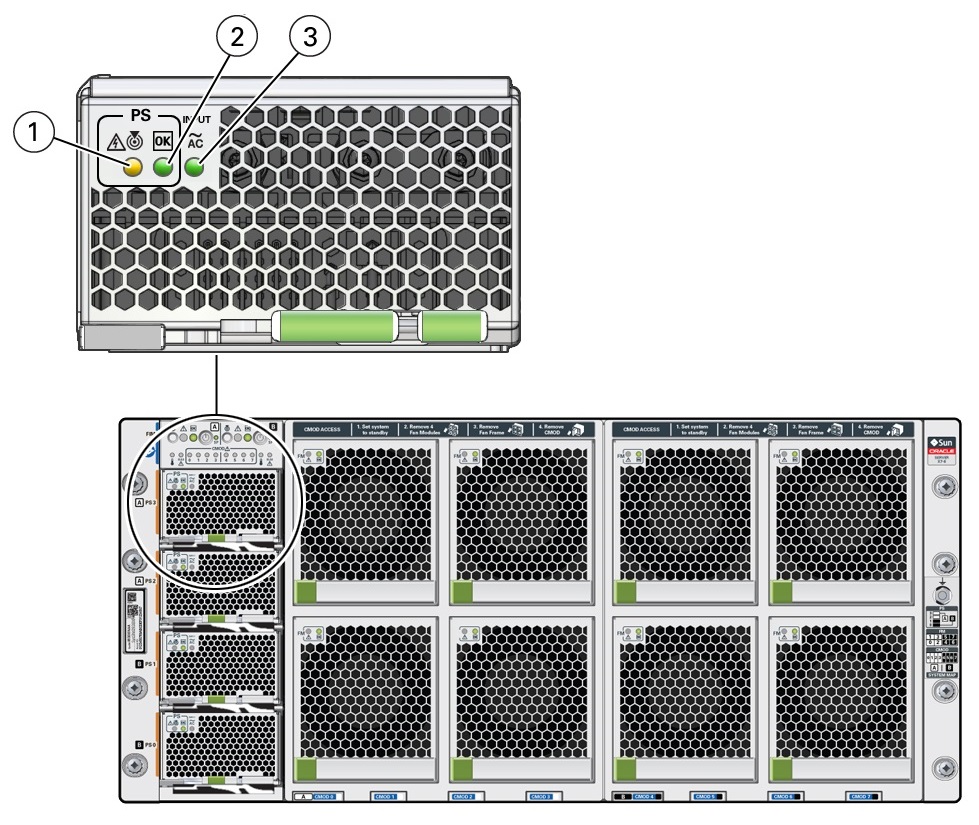

Chassis power is provided by four hot-serviceable front panel accessible power supply units (PSUs). The four PSUs provide dual (1+1) redundancy. Therefore, the minimum PSU configuration is two. To ensure redundancy, at least two separate circuits should supply server power. The following figure shows the indicator panel on the front of the power supplies.
| Call Out | Status LED or Button | Icon and Color | Description |
1 |
Fault-Service Required
Locate LED |
Amber White |
Indicates the location of the power supply in the server:
Lights steady on when the power supply is in a fault state. |
2 |
OK Power Supply OK LED |
Green |
Indicates the functional state of the power supply:
Note: Oracle ILOM signals a fault on any installed power supply that is not connected to an AC power source, since it might indicate a loss of redundancy. |
3 |
AC OK LED |
~AC Green |
Indicates the operational state of the power supply:

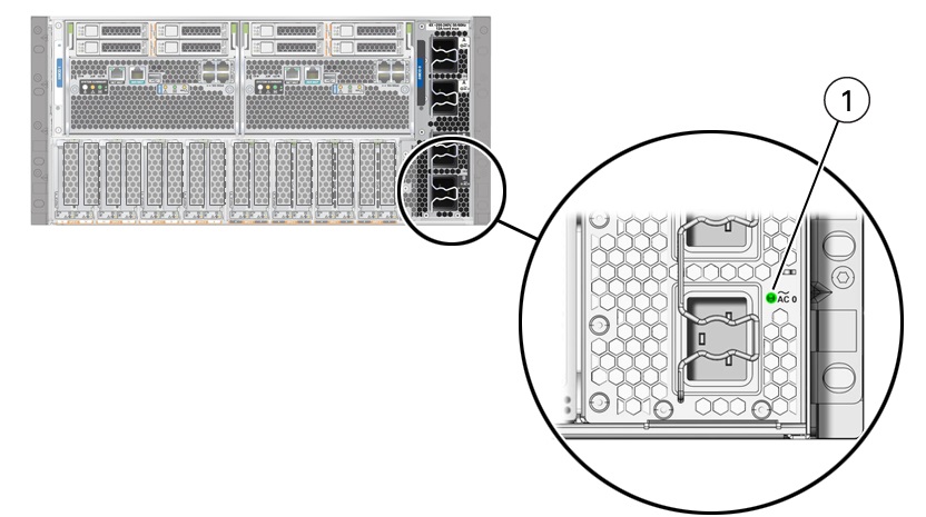

In the following figure, callout 1 shows the AC OK indicator for inlet ~AC 0.
1 |
AC OK LED |
~AC Green |
