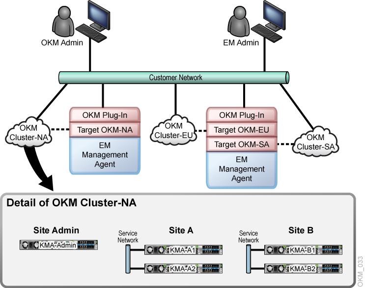

Before you deploy the plug-in, your planning process should consider the number of OKM clusters and each OKM cluster topology, along with the enterprise monitoring requirements. The figure below presents a large hypothetical enterprise including OKM clusters on three continents: North America, Europe, and South America. By presenting a large enterprise example, the diagram demonstrates a variety of possibilities for deploying the plug-in.
  • An Admin Site that is not servicing any OKM agents
  • Sites A and B that service OKM agents with keys.
Sites A and B contain isolated service networks for their agents. Your planning process should consider which KMA within each cluster will be used for the monitoring target.
In this example, the North American cluster uses KMA-Admin as the KMA within the Admin site for the plug-in. This plug-in will be hosted in the Management Agent with the target labeled “OKM-NA." You can configure other KMAs, but selecting this particular KMA minimizes traffic on KMAs that also service agents. You would need to perform a similar selection process for the other OKM clusters in Europe and South America.
