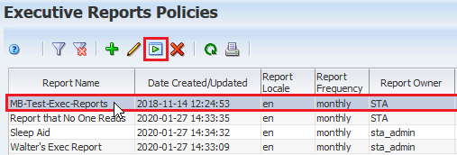

  2. In the left navigation, expand Setup & Administration, then select Executive Reports Policies.
  3. Select the report policy in the list, and then click Run Run icon.
    STA runs the report at the first available opportunity, which could take up to two minutes.
    Exec Report Policy page with row selected and Run icon noted
  4. In the Reports pop-up, verify the information and click OK to run the report.
