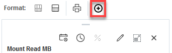

- Click Add Graph
near the top of an Overview screen.
- STA adds a graph with the default attribute and places it at the end of the graph area. You may need to scroll down to locate it.
- To adjust the graph, see:
- To remove the graph, click Remove Pane
on the graph's toolbar.
