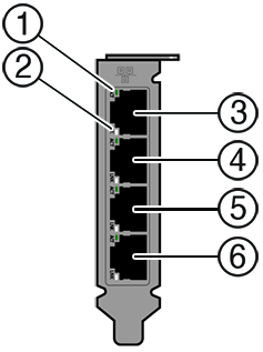

The following diagram illustrates the cluster Ethernet ports for Oracle ZFS Storage ZS11-2 controllers and Oracle ZFS Storage ZS9-2 controllers.
1 Ethernet Activity LED |
2 Ethernet Link Status LED |
3 Port 3 (Ethernet I/O) |
4 Port 2 (Ethernet I/O) |
5 Port 1 (Cluster Link) |
6 Port 0 (Cluster Link) |
