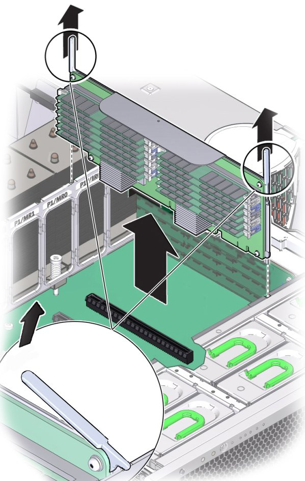

To remove the memory riser card, pull the handles upward to disengage the
connector from the motherboard, and carefully lift the memory riser straight
up and out of the controller. The handles act as levers against the
sidewalls to extract the card connector from the connector on the
motherboard.
