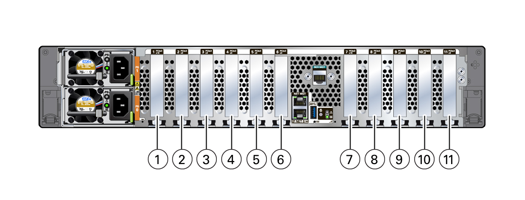

There are 11 PCIe slots available for PCIe cards. The following figure shows the PCIe slot numbering.
1 PCIe slot 1: Fifth PCIe option
7 PCIe slot 7: Fourth PCIe option
2 PCIe slot 2: External SAS-3 HBA
8 PCIe slot 8: Second PCIe option
3 PCIe slot 3: High-end model: External SAS-3 HBA; Mid-range model: Filler panel; slot not available
9 PCIe slot 9: High-end model: External SAS-3 HBA; Mid-range model: Filler panel; slot not available
4 PCIe slot 4: First PCIe option
10 PCIe slot 10: External SAS-3 HBA
5 PCIe slot 5: Third PCIe option
11 PCIe slot 11: Internal SAS-3 HBA
6 PCIe slot 6: Cluster interface card
All of the PCIe slots comply with the PCI Express 3.0 specification and can accommodate 25 Watt PCIe3 cards. -

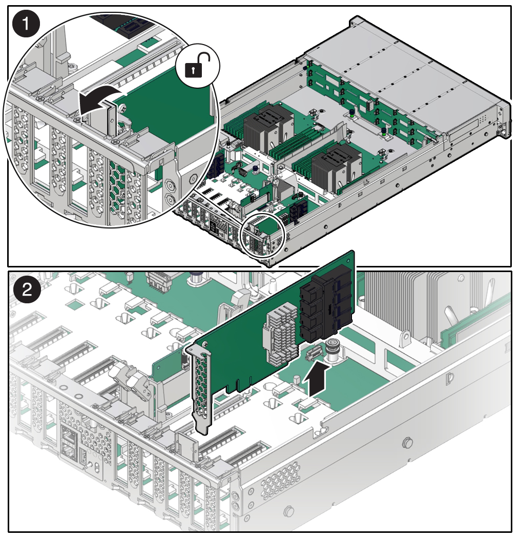

Rotate the PCIe card locking mechanism into an upright position [1], and then
lift up on the PCIe card to disengage it from the motherboard connectors
[2].
Place the PCIe card on an antistatic mat.

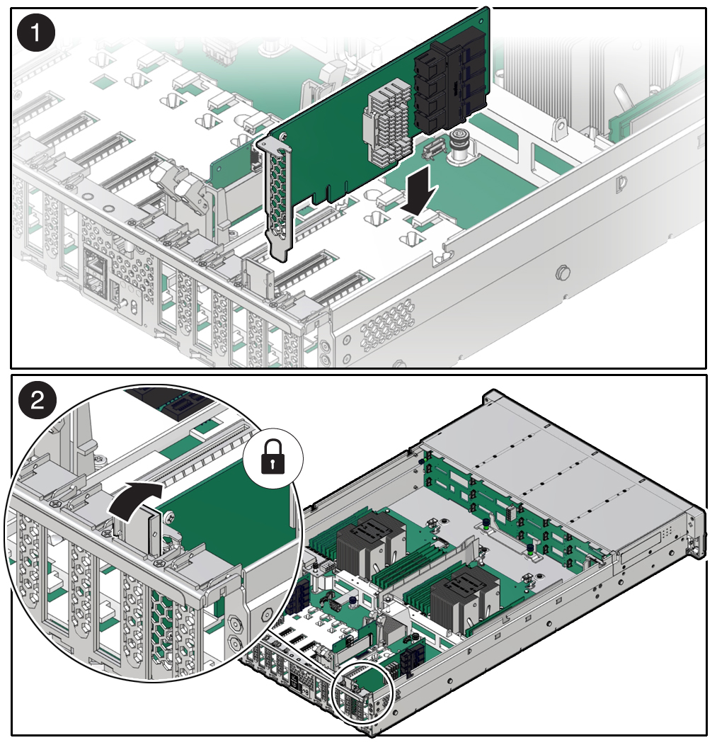

Insert the PCIe card into the correct slot [1], and rotate the PCIe locking
mechanism downward to secure the PCIe card in place [2].
You will hear or feel a click when the PCIe card is secured into the slot.
