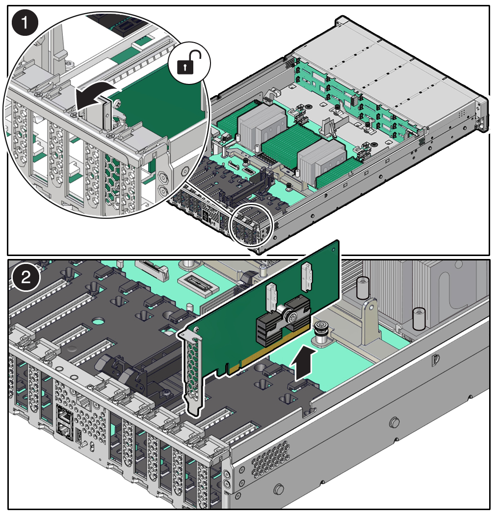

Rotate the PCIe card locking mechanism to an upright position [1], and then
lift up on the PCIe card to disengage it from the motherboard connectors
[2].
Place the PCIe card on an antistatic mat.

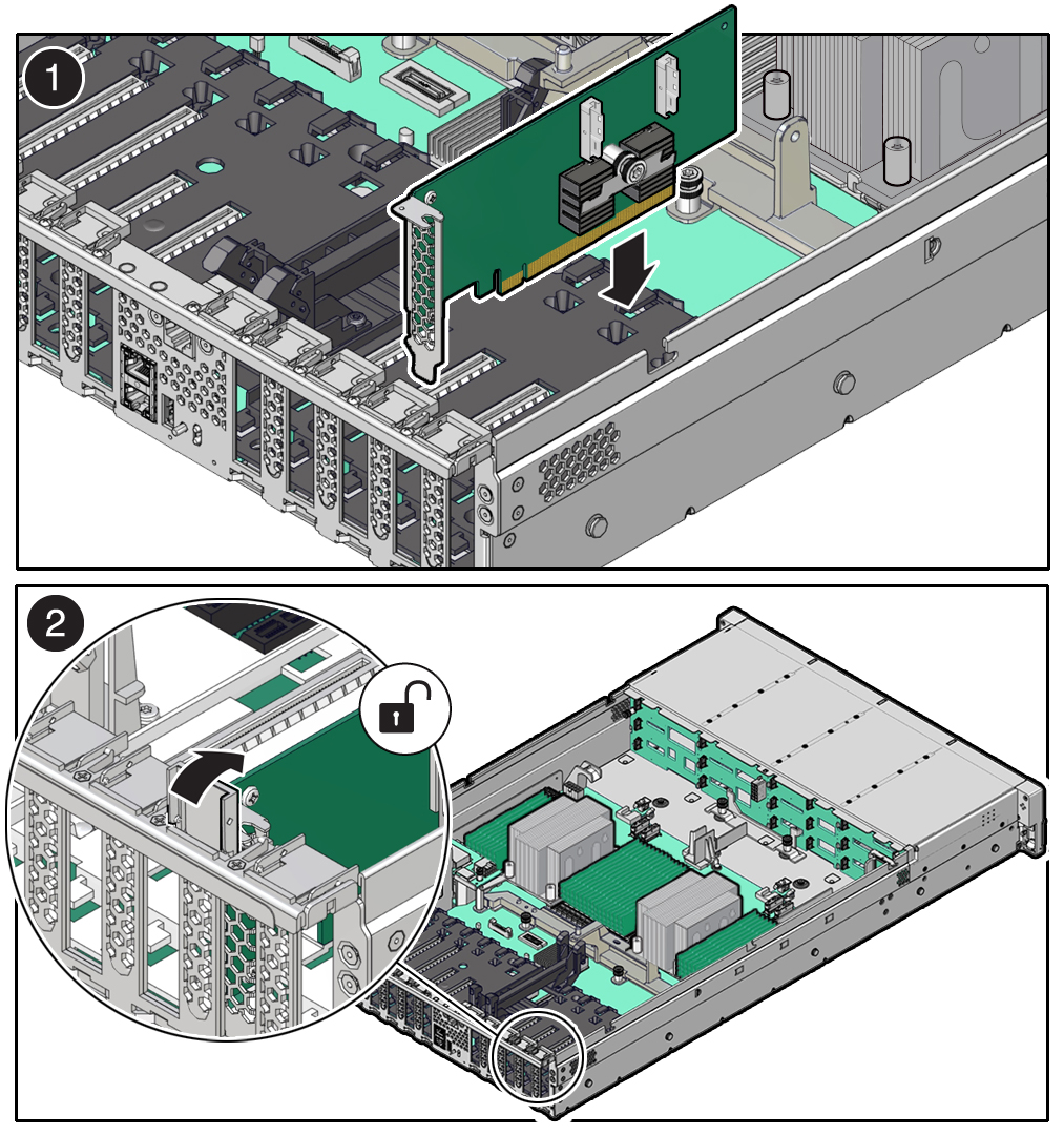

Insert the PCIe card into the correct slot [1], and rotate the PCIe locking
mechanism downward to secure the PCIe card in place [2].
You will hear or feel a click when the PCIe card is secured into the slot.
