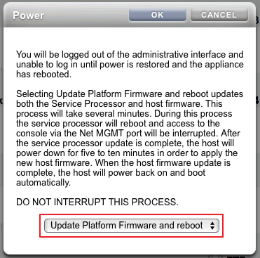

Updating the Platform Firmware (BUI)
Before you update the Oracle ILOM/host firmware, review these prerequisites:
Ensure you are using software version OS8.7.0 or later. If not, see Upgrading the Software.
View the platform firmware versions to determine if this task is necessary. See Checking the Platform Firmware Versions (BUI).
Use this task to update platform firmware during an appliance reboot.
By default, if the platform firmware is ready to update, it will be automatically applied as part of performing a graceful reboot.
