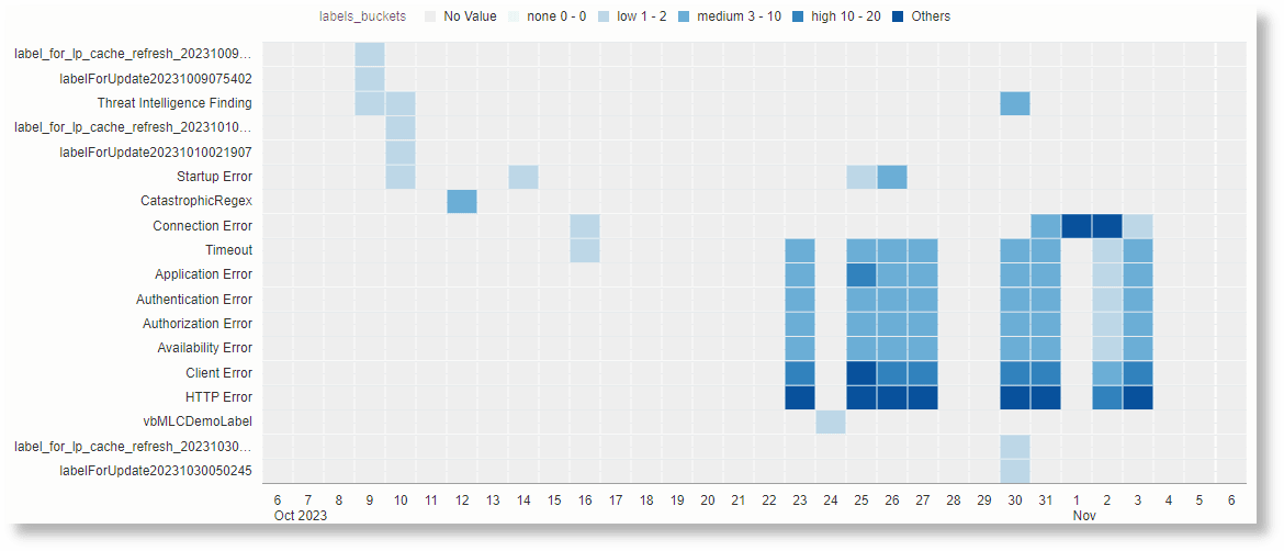

Heat map makes it easier to visualize more values such as counts or utilization against time. Various colors, that you can select in the settings, represent values over time so you can quickly spot areas that might be of concern. The visualization is based on the timestats command.
Example heat map:
Example heat map chart for the below query
The above heat map is generated for the following query:
Label not in ('Action Succeeded', 'Action Failed', 'Configuration Error')
   | timestats count as logrecords by Label
   | bucket logrecords as labels_buckets none = 0 - 0, low = 1 - 2, medium = 3 - 10, high = 10 - 20
From the heat map you can notice the count of various labels displayed against time. It's easier to determine the labels that have higher count. It's also easier to notice the behavior in specific time slots.

    Heat map and time series table for the default query
    The heat map for the following default query is displayed:
    * | timestats topcount = 20 count as logrecords by 'Log Source' | sort -logrecords
    Time is plotted along the y-axis of the chart. Along x-axis, the field which is the input to the timestats command is plotted, for example, Log Source. Each rectangle along a row represents the count of log records for a slot of time. The color of the rectangle represents the range in which the count belongs. The ranges are displayed at the top of the chart. Hover your cursor over the rectangles to view the values corresponding to them. To drill down further on s specific set of log records represented by a rectangle, click on it. The number of rectangles in a row is determined by the time range selected for the analysis. For example, if the selected time range is Last 60 Minutes, then each row has 60 rectangles corresponding to each minute of the time range.
