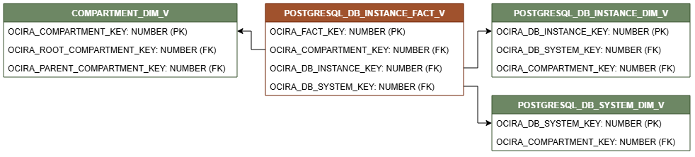

POSTGRESQL_DB_INSTANCE_FACT_V
Diagramme de relation montrant la table de faits, POSTGRESQL_DB_INSTANCE_FACT_V.

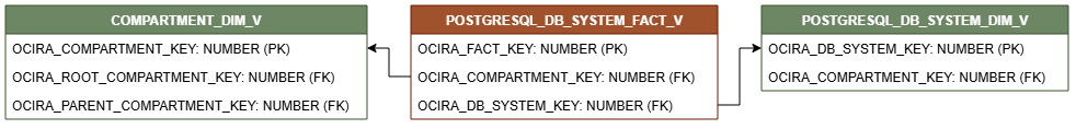

POSTGRESQL_DB_SYSTEM_FACT_V
Diagramme de relation montrant la table de faits, POSTGRESQL_DB_SYSTEM_FACT_V.

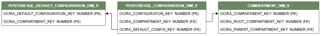

POSTGRESQL_CONFIGURATION_DIM_V
Diagramme de relation montrant la table de dimension, POSTGRESQL_CONFIGURATION_DIM_V.

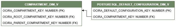

POSTGRESQL_DEFAULT_CONFIGURATION_DIM_V
Diagramme de relation montrant la table de dimension, POSTGRESQL_DEFAULT_CONFIGURATION_DIM_V.
