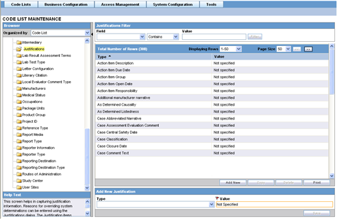

Justification This screen helps in capturing justification information.

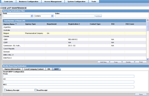

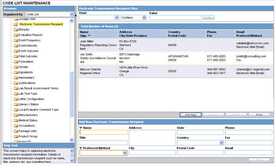

Electronic Transmission Recipient This screen helps in capturing electronic transmission recipient information.

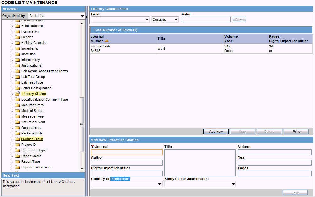

Literary Citation This screen helps in capturing information about Literary Citations.

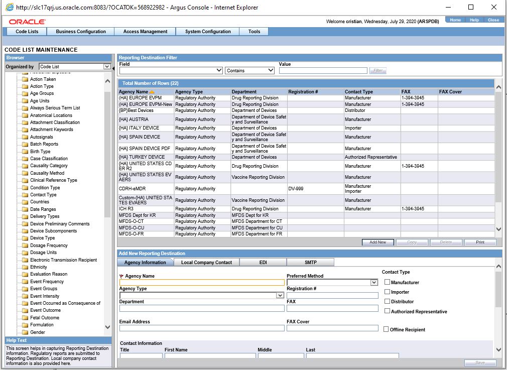

Reporting Destination This screen helps in capturing Reporting Destination information.

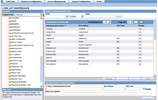

Routes of Administration This screen helps in capturing Routes of Administration information.

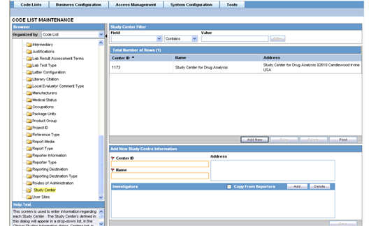

Study Center This screen helps in capturing Study Center information.

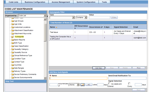

6.1.1 Configuring Autosignals
This screen enables you to capture the Auto Signal information.Using this screen, you can define the criteria that triggers Autosignal within Argus.
Example: If an event is reported within x number of days, an email is sent to the defined individual or workgroup. The system checks for patterns each time new data is entered, and sends e-mails to the appropriate individuals or departments on finding a matching pattern.
Select Code Lists -> Argus to view the Code List Maintenance screen.
Tip:
The code list items are displayed in the left-panel. Click on the required Code List folder to be configured. The details of this code list item appear in the right panel.
6.1.1.1 Field Descriptions
The following table describes the fields associated with this section.
Field/Control Name Description
Name Enables the user to enter the name of the Autosignal. This is a required field.
Number of Occurrences Enables the user to enter the number of occurrences of the autosignal.
Occurrences of Enables the user to enter the user to select or create an advanced condition for the autosignal through Select icon.
Number of days Displays the number of days for the autosignal.
As cases are entered Enables the user to perform autosignal as cases are entered.
Every N Days Enables the user to enter the number of days, when autosignal should be executed.
Email Enables the user to enter the email address of Argus users to whom the email about autosignal occurrence should be sent.
Use the following procedure to configure Autosignals.
  1. Click on the Autosignals folder in the left panel. The associated autosignal data appears in the Total Number of Rows section in the right panel.
    Surrounding text describes auto.png.
  2. Click on the Name (or row), to view the details associated with the selected autosignal. The details appear in the Modify Autosignal section.
    You can use the Autosignals Filter to make your search specific to an autosignal. The filtering criterion is essential as it helps you to search for specific items.
  3. Select the appropriate Field as the filtering criteria from the drop-down list.
  4. Once you have selected the Field, you can specify whether your search should contain or start with specific alphabets.
  5. Enter the search criteria in Value.
  6. Click Filter to apply the selected criteria.
    This displays the search results under Total Number of Rows.
    Tip: You can alternatively click Add New to create a new auto signal.:
    Click Copy to make an editable copy of an existing autosignal.
    Click Delete to delete a selected autosignal.
  7. Enter the name of the autosignal in the Name field.
  8. Enter the number of occurrences of the autosignal in the Number of Occurrences field.
  9. Select or create an Advanced Condition, if any from the button in the Occurrences of field.
    Tip:
    Click here for details on Advanced Conditions
  10. Enter the number of days for the autosignal under the Number of days field.
  11. Select the As cases are Entered checkbox to perform autosignal as cases are entered.
  12. Enter the number of days when the autosignal should perform under the Every N Days field.
  13. Enter the e-mail address that receives email about autosignal occurrence in the Email field.
  14. Click Save to save the changes made to this screen.

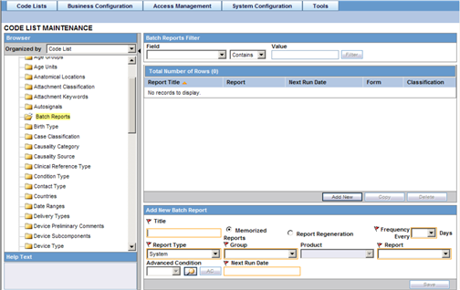

6.1.2 Configuring Batch Reports
This screen enables you to configure Batch Reports information.
Surrounding text describes batchreps.png.
  • Scheduled reports can be automatically generated and stored in the database by Argus Safety Service. This screen displays a list of all the existing Batch Reports.
  • By default the Batch reports shown are memorized reports. The Argus user can see the list of scheduled reports for memorized reports, using the Memorized Reports option.
  • Select Code Lists -> Argus to view the Code List page.
  • Click on the Batch Reports folder in the left panel.
The associated report data appears in the Total Number of Rows section in the right panel.

Use the following procedure to configure Batch Reports
  1. Click on the Report Title (or row), to view the details associated with that report. The details appear in the Modify Batch Report section.
    You can use the Batch Reports Filter to make your search specific to a batch report. The filtering criterion is essential as it helps you to search for specific items.
  2. Select the appropriate Field as the filtering criteria from the drop-down list.
  3. Once you have selected the Field, you can specify whether your search should contain or start with specific alphabets.
  4. Enter the search criteria in Value
  5. Click Filter to apply the selected criteria.
  6. This displays the search results under Total Number of Rows.
    Tip:
    You can alternatively click Add New to create a new report.
    • Use Copy to make an editable copy of an existing report.
    • Use Delete to delete an existing report.
  7. Enter the Title Name for the batch report.
  8. Select the Report Type from the drop-down list.
  9. Select the Group to which the report must be assigned.
  10. Select the report to be scheduled as Memorized Reports or Reports Regeneration.
  11. Select the Frequency of generating the report after the specified number of days have elapsed.
  12. Select the Product for which the report is to generated, from the drop-down list box.
  13. Select the Report from the drop-down list.
  14. Enter the Next Run Date. This is the next date from which the report has to be scheduled.
  15. Select the Advanced Condition associated with the report configuration.
  16. Click Select icon to launch the Advanced Conditions browser.
  17. Click Save to save the changes made to this section.

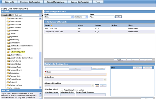

6.1.3 Configuring Letters
Argus Safety enables the customizing of letter templates in order to correspond with reporters or health officials and keep them updated with case activity. Access to the Letter Configuration dialog can be granted to any user or user-group, as found appropriate by the Administrator.
Surrounding text describes letterc.png.
  • To automatically generate a letter, the system reads a template that specifies the information that must appear in the letter.
  • The template is a file in Rich Text Format (.rtf format) that contains the letter text and some field identifiers (also called placeholders). The system substitutes information specific to the current case for the placeholders in the template. Thus, a letter containing case-specific information is automatically generated.
  • The administrator can set up the system to create and schedule letters automatically, according to pre-defined business rules. This section discusses the creation, modification, and deletion of letter templates.
Select Code Lists-> Argus to view the Code List page.
Tip:
Configuring letter (RTF) templates
RTF Document can be created using the required placeholders such as:
[patient_last_name], [product_name]:[n], [rec_vacc_date]:[n]:[m], [event_prior_hist:primary_event], [reg_report_timeframe]
Most of the placeholders have one parameter or two and these are almost always linked to sort order.
Here are some examples of how these placeholders extract data:
For single value columns:
[age],[case_id],[comments],[case_status],[country_of_inc]
For multiple value columns:
[event_death:primary_event] picks data from case_primary_event table
[event_death]:[n] picks data from case_event/lam_event table based on Sort order
[case_notes]:[n], [concentration]:[n],[drug_code]:[n]
For multiple parameter columns:
[ingredient]:[n]:[m] - It lists nth case product and lists its mth ingredient
6.1.3.1 Field Descriptions
Name Enables the user to specify the name of the letter as it will appear in the Letters menu.
Name (J) Enables the user to specify the Japanese name of the letter as it will appear in the Letters menu.
Edit Template Enables the user to open the letter (template) for editing. Use only WordPad for editing letter templates.
Regulatory Cover Letter Enables the user to indicate whether this letter template should appear in the Regulatory Rules dialog Cover letter drop-down list box.
The available options are: No, Yes – RTF Format, and Yes – PDF Format.
Schedule - Letter Enables the user to enter the number of days (from the receipt date) when the letter will be due.
Schedule - Action The Action field enables the Administrator to specify the number of days (from the current date) after which the Action Item for following up on this letter will be due.
Sites Argus Console provides the ability to configure letters to user sites. Enables users to select single or multiple sites for that letter. The system will only allow users to see letters that are configured to their site.
Action Items The action items list is a drop-down list of action item codes from the Action Type List Maintenance.
Return Email Address Enables the user to enter a default email address where the mails will be sent. This address is displayed by default in the Activities tab of the Case Form.
Advanced Condition Enables the user to configure Advanced Conditions. If the case matches with the Advanced Condition, the configured letter is scheduled for the case.
Use the following procedure to configure letters.
  1. Click on the Letter Configuration folder in the left panel. The associated data appears in the Total Number of Rows section in the right panel.
  2. Click on the Name (or row), to view the details associated with that letter. The details appear in the Modify Letter Configuration section.
  3. You may use the Letter Configuration Filter to make your search specific to a letter. The filtering criterion is essential as it helps you to search for specific items.
  4. Select the appropriate Field as the filtering criteria from the drop-down list.
  5. Once you have selected the Field, you can specify whether your search should contain or start with specific alphabets.
  6. Enter the search criteria in Value.
  7. Click Filter to apply the selected criteria.
  8. This displays the search results under Total Number of Rows.
    Tip:
    You can alternatively click Add New to create a new letter.
    • Use Copy to make an editable copy of an existing letter.
    • Use Delete to delete an existing letter.
  9. Click Select to specify the path of the letter template to be used.
    Tip:
    Click Edit Template to save the existent template on to your local drive of the system.
    You can edit this template and repeat the step listed above, to ensure that the updated template is used for letters.
  10. Enter the name of the letter, as it will appear, in the Letters Menu section in Enter a new item.
  11. Click Add or Delete to configure letter to the user Sites.
  12. Select the Action Item from the drop-down list box. The action items list is a drop-down list of action item codes, from the Action Type List Maintenance.
  13. Configure the Advanced Condition for the case.
  14. Enter the Schedule (days)-Letter. This is the number of days from the receipt date when the letter is due.
  15. Enter the Schedule (days)-Action. This is the number of days from the current date, after which the Action Item for the follow up on this letter will be due.
  16. Enable the Regulatory Cover Letter option to indicate whether this letter template should appear in the Regulatory Rules dialog.
  17. Enter the default e-mail address in Return Email Address.
  18. Click Save to save the changes made for this section.

6.1.4 Configuring Justifications
This screen enables you to capture justification information.
Surrounding text describes justifi.png.
Argus Safety users can enter the reasons for overriding system determinations using the Justifications dialog. The Justification items appear on the Action Justification dialog on the screen.
Tip:
6.1.4.1 Field Descriptions
Type Enables the user to configure the type.
Justification Enables the user to enter the justification.
Use the following procedure to configure justification.
  1. Click on the Justifications folder in the left panel. The associated report data appears in the Total Number of Rows section in the right panel.
  2. Click on the Type (or row), to view the details associated with that justification. The details appear in the Modify Justification section.
  3. You may use the Justifications Filter to make your search specific to a justification. The filtering criterion is essential as it helps you to search for specific items.
  6. Enter the justification reason in Justification.
  7. Click Filter to apply the selected criteria. This displays the search results under Total Number of Rows.
    Tip:
    You can alternatively click Add New to create a new justification.
    • Use Copy to make an editable copy of an existing justification.
    • Use Delete to delete an existing justification.
  8. Select the Type from the drop-down list.
  9. Enter the Value for the justification.
  10. Click Save to save the changes made for this section.
6.1.5 Configuring Electronic Transmission
This screen enables you to configure electronic transmission recipient information.
  • Details of electronic transmission recipient such as name, title, address etc. are submitted here.
  • Select Code Lists-> Argus to view the Code List page.
Surrounding text describes elec.png.
Tip:
6.1.5.1 Field Descriptions
The following table lists and describes the fields associated with this section.
Name Enables the user to enter the name of Electronic Transmission Recipient.
Title Enables the user to enter the title of Electronic Transmission Recipient.
Address Enables the user to enter the address of Electronic Transmission Recipient.
City Enables the user to enter the city of Electronic Transmission Recipient.
State/Province Enables the user to enter the state/province of Electronic Transmission Recipient.
Country Enables the user to select the country of the user.
Postal Code Enables the user to enter the postal code of Electronic Transmission Recipient.
Phone Enables the user to enter the phone number of Electronic Transmission Recipient.
Fax Enables the user to enter the fax of Electronic Transmission Recipient.
Email Enables the user to enter the email of Electronic Transmission Recipient.
Preferred Method Enables the user to select the preferred method of transmission from the drop-down list. This can be by fax or by email.
Use the following procedure to configure the electronic transmission recipient.
  1. Click on the Electronic Transmission Recipient folder in the left panel. The associated data appears in the Total Number of Rows section in the right panel.
  2. Click on the Name Title (or row), to view the details associated with that electronic transmission. The details appear in the Modify Electronic Transmission Recipient section.
  3. You may use the Electronic Transmission RecipientFilter to make your search specific to an electronic transmission recipient. The filtering criterion is essential as it helps you to search for specific items
    Tip:
    You can alternatively click Add New to create a new electronic transmission recipient.
    • Use Copy to make an editable copy of an existing electronic transmission recipient.
    • Use Delete to delete an existing electronic transmission recipient.
  8. Enter the Name of the electronic transmission recipient.
  9. Enter the Title of the electronic transmission recipient.
  10. Enter the Address of the electronic transmission recipient.
  11. Enter the City of the electronic transmission recipient.
  12. Enter the State/Province of the electronic transmission recipient.
  13. Select the Country of the electronic transmission recipient, from the drop-down list.
  14. Enter the Postal Code of the electronic transmission recipient.
  15. Enter the Phone of the electronic transmission recipient.
  16. Enter the Fax of the electronic transmission recipient.
  17. Enter the Email of the electronic transmission recipient.
  18. Select the Preferred Method of communication (by fax or email) for the electronic transmission recipient.
  19. Click Save to save the changes made to this section.

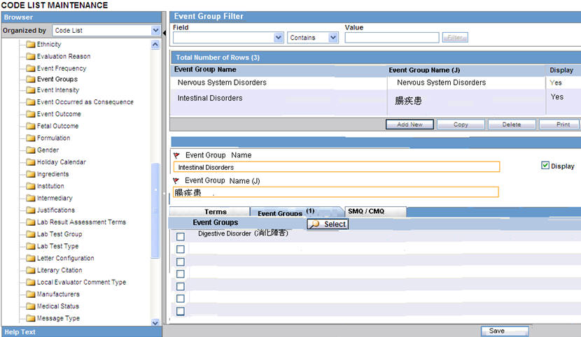

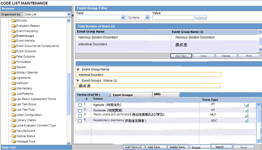

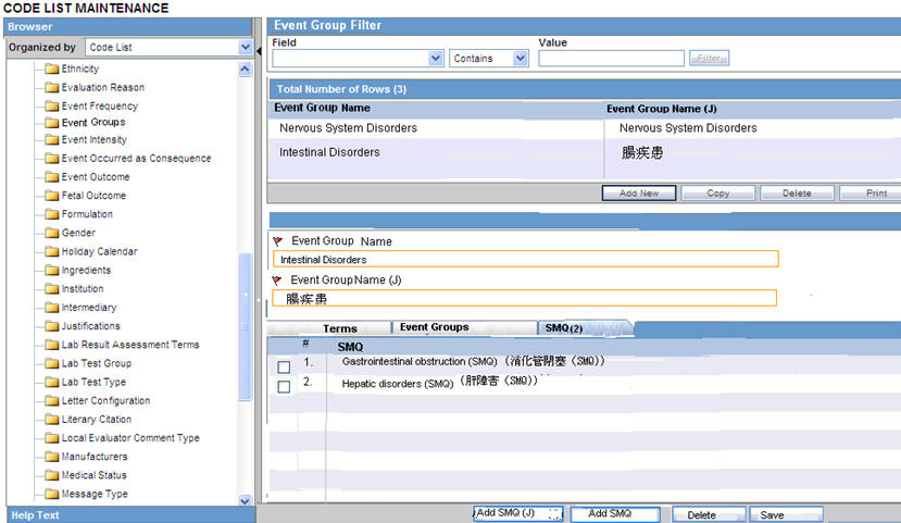

6.1.6 Configuring Event Groups
This screen enables you to configure Event Groups information.
Surrounding text describes evntgrps.jpg.
  • The list of terms which are used across labeledness determines are defined in a central location for users. These users can update these event groups (list of terms) when the product configuration updates are required or when MedDRA versions are upgraded when MSSO releases the new MedDRA updates.
  • The values entered here and marked as Display appear in the Console > Business Configuration > Products and Licenses > Product Family > Datasheet > Add Event Groups section.
6.1.6.1 Terms tab
The following table describes the fields associated with Event Groups > Terms tab.
Field Name Description
Event Group Name Allows the user to enter a new Event Group name.
Event Group Name (J) Allows the user to enter a new Event Group name in Japanese. This screen and its print form will be visible to only the Japanese users.
Display Allows the user to display the Event Group in Business Configuration > Products and Licenses > Product Family > Datasheet.
Terms The Terms tab contains terms selected from the MedDRA browser. These terms are displayed in the following format for English users:
MedDRA Term in English
These terms are displayed in the following format for Japanese users:
MedDRA Term in English (MedDRA Term in Japanese)
The count of the total number of MedDRA terms present for the case is displayed on the header of the Terms tab.
Term Type Displays the type of the MedDRA term. This field can contain the MedDRA term type values such as PT, HLT, HLGT or SOC.
Use the following procedure to configure Terms:
  1. Click Event Groups on the left pane of the Code List.
    You can use the Event Group Filter on the right pane, to make your search specific to an event group. The filtering criterion is essential as it helps you to search for specific items.
  4. Enter the search criteria in Value.
    Tip:
    You can alternatively click Add New to create a new event group.
    • Use Copy to make an editable copy of an existing event group.
    • Use Delete to delete an existing event group.
  7. Enter the name of the event group under Event Group Name.
  8. If it is also required for a Japanese user, enter the Japanese name of the event group under Event Group Name (J).
  9. Check the Display checkbox to display the Event Group in Business Configuration > Products and Licenses > Product Family > Datasheet.
  10. Click Export (or Import) to export (or import, respectively) a file in a valid file format from (or into) your local system. Valid file formats require that the file be in .xls, .xlsx, or .csv formats.
    Important: The format of the data in the csv, xls or xlsx file must be as follows:
    It must have only a single column of data. An import file can have ~ 16 K Terms.
    The first/header row must have text as "PT" or "HLT" or "HLGT" or "SOC" in upper or lower case.
    All the rows below the header row must contain corresponding terms (text) such as PT text or HLT text or HLGT text or SOC text.
  11. Click Save to save the changes made to this tab.
6.1.6.2 Event Groups tab
Click the Event Groups tab to configure event groups.
The following screen is displayed:
Surrounding text describes terms.jpg.
The following table describes the fields associated with Event Groups > Event Groups tab.
Event Groups The Event Group, selected from the Select button > Available Event Groups dialog, is displayed as follows:
Event Group Name in English
The event group name is displayed in the following format for Japanese users:
Event Group Name in English (Event Group Name in Japanese)
The count of the total number of Event Group Names present for the case is displayed on the header of the Event Groups tab.
Select button Click this button to select the relevant event groups from the Available Event Groups dialog.
This dialog displays the event groups in a tree-format, with the child event groups being paired under the parent event groups.
6.1.6.3 SMQ tab
Click the SMQ tab to configure SMQ terms.
Surrounding text describes smq.jpg.
The following table describes the fields associated with Event Groups > SMQ tab.

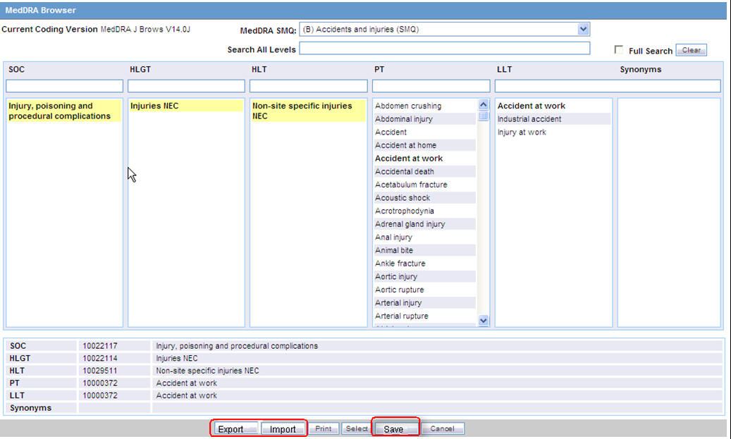

SMQ The SMQ term is selected from the Add button > MedDRA Browser dialog.
On clicking the Add button, the MedDRA Browser is displayed, as shown below:
Surrounding text describes meddra.jpg.
Export:
The Export button is enabled in two scenarios - when MedDRA is opened from:i) Argus Console > Business Configuration > Products and Licenses > Product Family > Datasheetor, from:ii) Argus Console > Code Lists > Argus > Event GroupMedDRA terms are selected at any level of the MedDRA hierarchy.On clicking this button, a dialog is displayed, that allows you to select the file type - .csv / .xls / .xlsx file.On specifying the file type, the selected PT terms are then exported in the Export file. in the <PT terms> format.
Import:
This button is enabled in two scenarios - when MedDRA is opened from:i) Argus Console > Business Configuration > Products and Licenses > Product Family > Datasheetor, from:ii) Argus Console > Code Lists > Argus > Event GroupMedDRA terms are selected at any level of the MedDRA hierarchy.On clicking this button, a dialog is displayed, that allows you to browse and upload a .csv / .xls / .xlsx file from the desired location on your local machine.The format of the data in the selected file should be as follows:It should have only one column of dataThe first header/row must display 'PT' or 'HLT' or 'HLGT' or 'SOC'.All the rows under the header row should contain corresponding terms such as PT text, or HLT text, or HLGT text, or SOC text.The MedDRA terms in the file should be matched against the MedDRA terms table at the level specified in the header row. Duplicate terms within the import file should be ignored.If the user enters a search criteria at any levels of the MedDRA hierarchy and continues to search for terms, the results obtained from the Import will be lost. The user may need to import terms again, using the Import button.
Save:
The Save button is enabled only on selection of the PT term(s).
6.1.7 Configuring Literary Citations
This screen enables you to configure information about Literary Citations.
  • The information configured in this form is displayed in the Literature Info section of the Case Form.
  • Select Code Lists -> Argus to view the Code List Maintenance screen.
Surrounding text describes lite.gif.
Tip:
6.1.7.1 Field Descriptions
Journal Configures the name of the journal where the citation appears. This is a required field.
Author Configures the name of the author.
Title Configures the title of the citation.
Volume Configures the volume number of the journal where the citation appears.
Year Configures the publication year of the journal where the citation appears.
Digital Object Identifier Configures the digital object identifier.
Pages Configures the number of pages in the journal where the citation appears.
Country of Publication Captures the country of publication of the literature.
Study/Trial Classification Captures the Study / Trial classification for the literature.
Use the following procedure to configure literary citations.
  1. Click on the Literary Citations folder in the left panel. The associated data appears in the Total Number of Rows section in the right panel.
  2. Click Journal/Author (or row) to view the details associated with the literary citation. The details appear in the Modify Literature section.
  3. You may use the Literary Citation Filter to make your search specific to a citation. The filtering criterion is essential as it helps you to search for specific items.
    Tip:
    You can alternatively click Add New to create a new citation.
    • Click Copy to make an editable copy of an existing citation.
    • Click Delete to delete a selected citation.
    • Click Print to print the selected information as a PDF.
  8. Enter the name of the journal in the Journal field.
  9. Enter the name of the author of the citation in the Author field.
  10. Enter the title of the citation in the Title field.
  11. Enter the Volume Number in the Volume field.
  12. Enter the year in the Year field.
  13. Enter the digital object identifier in the Digital Object Identifier field.
  14. Enter the number of pages in the Pages field.
  15. Click Save to save the changes made.

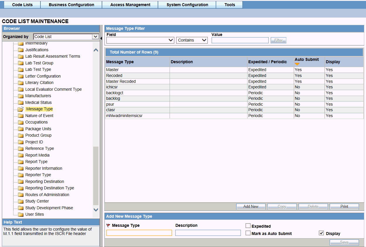

6.1.8 Configuring Message Type
This screen enables you to configure information about message type.
  • The message type specified in this section enables you to specify auto-submission of reports.
    Surrounding text describes messagetypecl.gif.
Tip:
6.1.8.1 Field Descriptions
Message Type Displays the message type for a report.
Expedited/Periodic Displays if the message type is expedited or periodic.
Note: By default, ICHICSR is considered as Expedited, while the other message types are considered as Periodic.

Use the following procedure to configure message type.
  1. Click on the Message Type folder in the left panel. The associated data appears in the Total Number of Rows section in the right panel.
  2. Click Message Type (or row) to view the details associated with the message type. The details appear in the Modify Message Type section.
  3. You may use the Message Type Filter to make your search specific to a message type. The filtering criterion is essential as it helps you to search for specific items.
    Tip:
    You can alternatively click Add New to create a new message type.
    • Click Copy to make an editable copy of an existing message type.
    • Click Delete to delete a selected message type.
  8. Enter the type of message in the Message Type field.
  9. Enter the description for the message type in the Description field.
  10. Click the Expedited checkbox if the message type is for an expedited report.
  11. Click the Mark as Auto Submit checkbox if you wish to mark for auto submission.
  12. Click the Display checkbox if you wish to display the message type.
  13. Click Save to save the changes made.

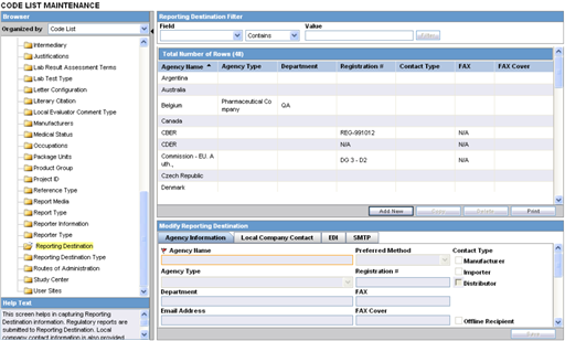

6.1.9 Configuring Reporting Destination
Regulatory reports are submitted to the Reporting Destination. Local company contact information is also provided on this screen.
Use the following procedure to configure reporting destination:
Click Reporting Destination on the left pane of the Code List screen.
6.1.9.1 Agency Information
The Agency Information tab is displayed by default, on selecting Reporting Destination.
Field Descriptions
The fields under the Agency Information tab are described in the following table:
Address 1 Enables the user to enter the address of the regulatory contact in line 1.
Address 2 Enables the user to enter the address of the regulatory contact in line 2.
Agency Name Displays the name of the agency. This is a required field.
Agency Type Enables the user to select the agency type.
Allow WHO Drug reporting Enables the user to schedule a report for WHO Drug Reporting.
Attachments Enables the user to select single or multiple attachments.
City Enables the user to enter the city of the regulatory contact.
Contact Type
  • Manufacturer - Enables the user to select manufacturer as the type of contact
  • Importer - Enables the user to select importer as the type of contact
  • Distributor - Enables the user to select distributor as the type of contact
  • Authorized Representative - Enables the user to select the Authorized Representative as a type of contact.
Country Enables the user to enter the country of the regulatory contact.
Country Code Enables the user to enter the country code of the regulatory contact.
Department Enables the user to enter the name of the department.
Email Address Enables the user to enter the email address of the agency.
Email Text Body
  • Select - Enables the user to select a .txt or .rtf file to be uploaded.
    Note: The file should be in .txt, or .rtf format.
    After the uploaded file is saved, the Edit button displays a clip button, denoting an attachment.
  • Edit - Enables the user to open the uploaded file / text in a word document from the server and edit the text inside it. If no file was uploaded earlier, a blank document is opened.
    Note: You can save the edited document on the local machine and click Select to save the file.
Ext Enables the user to enter the extension number of the regulatory contact.
FAX Enables the user to enter the FAX Number.
FAX Cover Enables the user to enter the FAX Cover.
First Name Enables the user to enter the first name of the regulatory contact.
Last Enables the user to enter the last name of the regulatory contact.
Middle Enables the user to enter the middle name of the regulatory contact.
Offline Recipient Enables the user to configure the regulatory agency as an offline agency.
Phone Enables the user to enter the phone number of the regulatory contact.
Postal Code Enables the user to enter the postal code of the regulatory contact.
Preferred Method Enables the user to select the preferred method of agency information.
Registration # Enables the user to enter the registration number.
Report for Investigational Licenses Enables the user to select if the reports are to be investigational always or only for clinical case or no marketed license.
Report for Marketed Licenses Enables the user to select whether reports are to be marketed always or only for the Spontaneous cases or no Investigational.
Report per Email Enables the user to enter the number of reports to be received in each email.
State/Province Enables the user to enter the state/province of the regulatory contact.
Title Enables the user to enter the title of the regulatory contact.
FAX Enables the user to enter the fax number of the regulatory contact.
Contact Type Enables the user to select the Authorized Representative, Manufacturer, Importer, or Distributor check box.
Surrounding text describes ag_info_reporting_dest.jpg.
Use the following procedure to configure agency information.
  1. Select the Agency Name (or row) of the reporting destination displayed under Total Number of Rows that needs to be modified. The Modify section displays the information about the selected code list.
  2. You may use the Reporting Destination Filter to make your search specific to an agency. The filtering criterion is essential as it helps you to search for specific items.
  6. Click Filter to apply the selected criteria. This displays the search results under Total Number of Rows.
    Tip:
    Tip: You can alternatively click Add New to create a new agency information.
    • Click Copy to make an editable copy of an existing agency information.
    • Click Delete to delete the selected agency information.
  7. Enter the name of the agency in the Agency Name field.
  8. Select the type of agency in the Agency Type field.
  9. Enter the department in the Department field.
  10. Enter the email address in the Email field. Multiple e-mail addresses must be separated by a comma (,), and not by a semi-colon (;). If you separate the email addresses by a semi-colon, the transmission service will fail.
  11. Select the preferred method from the Preferred Method drop-down list. The options available are Fax or Email.
  12. Enter the registration number in the Registration # field.
  13. Enter the Fax Number in the FAX field.
  14. Enter the Fax Cover in the FAX Cover field.
  15. Select the preferred contact type by clicking the checkboxes available under Contact Type.
    The options available are Manufacturer, Importer, Distributor, and Authorized Representative.
  16. Select the Offline Recipient checkbox to configure the regulatory agency as an offline agency.
  17. Select the Title of the regulatory contact. The options available are Mr., Miss and Mrs.
  18. Enter the first name of the regulatory contact under the First Name field.
  19. Enter the middle name of the regulatory contact under the Middle field.
  20. Enter the last name of the regulatory contact under the Last field.
  21. Enter the postal contact address of the regulatory contact under the Address 1 field.
  22. Enter the phone number of the regulatory contact under the Phone field.
  23. Enter the extension number of the regulatory contact under the Ext field.
  24. Enter the country code to be dialed in calling up the regulatory contact under the Country Code field.
  25. Enter the fax number of the regulatory contact under the FAX field.
  26. Enter the fax extension number of the regulatory contact under the Ext field.
  27. Enter the country code required in faxing up the regulatory contact under the Country Code field.
  28. Enter the name of the city where the regulatory contact lives in the City field.
  29. Enter the name of the state/province where the regulatory contact lives in the State/Province field.
  30. Enter the name of the country where the regulatory contact lives in the Country field.
  31. Enter the postal code of the place where the regulatory contact lives in the Postal Code field.
  32. Enter the number of reports that need to be sent in every email to the regulatory contact in the Report per Email field.
  33. Select whether to send single or multiple attachments with emails through the Attachments drop-down list.
  34. Select how the report is to be marketed from the Report to be marketed drop-down list.
  35. The options in this list are Always or Spontaneous or No Investigational.
  36. Select the Allow WHO Drug Reporting checkbox to schedule the report for WHO Drug Reporting.
  37. Select the type of reports as Investigational always or Only for clinical case or No marketed license from the Report for Investigational drop-down list.
  38. Click Save to save the changes made.

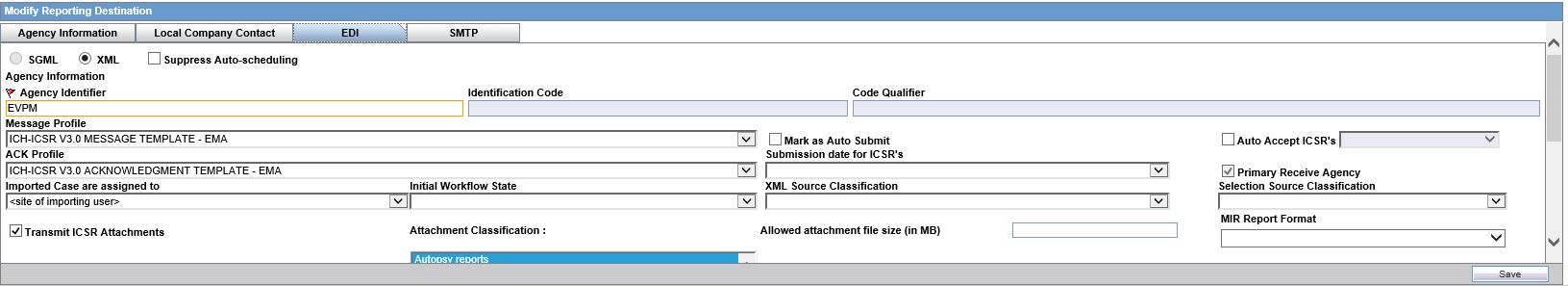

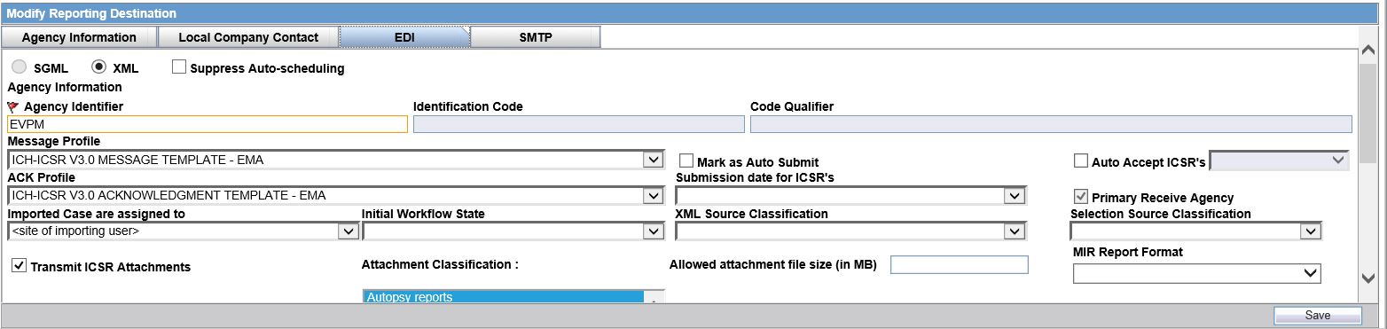

6.1.9.3 Configuring EDI
This section lists the field descriptions and configuration steps for the EDI tab.
  1. Select Code Lists -> Argus to view the Code List Maintenance screen.
  2. Select Reporting Destination on the left pane of the Code List screen. The screen appears as shown below:
    Surrounding text describes modify_reporting_destination.jpg.
Field Descriptions
The following table lists and describes the fields on the EDI tab.
SGML/XML Enables the user to select whether to send the report in SGML or XML format. When SGML is disabled and XML is selected, it is populated with default values and is displayed in the read-only mode for the PMDA E2 (R3) profile.
Agency Identifier Enables the user to enter the routing ID configured in Cyclone for the sender community.
Identification Code Enables the user to enter the agency Duns code, a unique identification code that identifies the trading partner.
This field is disabled for the E2B(R3), eVAERS, MIR, and eMDR profile. Populated with default values and is displayed in the read-only mode for the PMDA E2B R3 profile.
Code Qualifier Enables the user to enter the code qualifier here. The code qualifier is used to interpret the identification code.
Message Profile Enables the user to select a message profile among the list of message profiles displayed.
Mark as Auto Submit Enables the user to mark the report for auto submission.
Auto Accept ICSRs Click this checkbox to auto accept ICSRs. This checkbox is visible only when case numbering is set to Automatic.
Submission date for ICSRs Enables the user to select the submission date for ICSRs. It is blanked out and disabled if user selects the eVAERS or eMDR profile in the EDI Tab.
ACK Profile Enables the user to select the acknowledgement profile. This field is disabled for the eMDR, MIR, and eVAERS profile. The PMDA E2B(R2) Ack profile is also available now.
Primary Receive Agency Enables the user to select the primary receiving agency.
Imported Cases are assigned to Enables the user to select the country, where the imported cases need to be assigned.
Note: This list comprises the configured Argus sites. The default value is the site of the importing user.
Initial Workflow State Enables the user to configure the initial workflow state of the case.
Note: This list comprises Argus workflow states, with the default value being blank. If you select blank as the workflow state, it is treated as a new case being booked-in.
XML Source Classification The system enables the user to configure the XML Source Classification and the PDF Source Classifications used for classifications defined while the Source E2B File / PDF for Initial Intake or E2B Differences report is classified.
When a case is accepted as an initial or follow-up case, the system attaches the source XML and the Initial Selection PDF to the case on the Additional Info tab.
This field is disabled for the MIR profile.
Selection Source Classification Enables the user to select the source classification from the drop-down.
Transmit E2B Attachments Click this checkbox to transmit E2B attachments. If this checkbox is checked in the Reporting Destination Code List, case form attachments are sent to the specified reporting destination.
Attachment Classification Enables the user to select the attachment classification.
Identification Code Enables the user to enter the company Duns code, a unique identification code that identifies the trading partner. This field is disabled for the E2B(R3), eVAERS, MIR, and eMDR profile.
Company Identifier Enables the user to enter the company identifier.
Code Qualifier Enables the user to enter the code qualifier here. The code qualifier is used to interpret the identification code. This field is disabled for the E2B(R3), eVAERS, MIR, and eMDR profile.
File Name Enables the user to enter the file name.
SGML Declaration File Enables the user to enter the SGML Declaration File. This field is disabled for the E2B(R3), eVAERS, MIR, and eMDR profile.
Maximum # of reports to include in the msg Enables the user to enter the maximum number of reports that will be transmitted in one message. This field is disabled for the E2B(R3), eVAERS, MIR, and eMDR profile and set to 1. This parameter can be used for English E2B(R2) reports. But in case of PMDA E2B(R2), this parameter should be left blank or set to 1.
Method Enables the user to select a method here. This field contains E2B ESTRI Gateway and E2b Media values.
EDI Header Required Enables the user to generate the EDI Header. This field is disabled for the E2B(R3), eVAERS, MIR, and eMDR profile. Populated with default values and is displayed in the read-only mode for the PMDA E2B(R3) profile.
XML Version Enables the user to enter the XML Version. This field is disabled for the E2B(R3), MIR, and eMDR profile and set to 1.0. Populated with default values and is displayed in the read-only mode for the PMDA E2B(R3) profile.
URL for Message Schema Enables the user to enter the path where the message schema resides on the internet or enter full path if it is located on the disk. This field is disabled for the E2B(R3), eVAERS, MIR, and eMDR profile. Populated with default values and is displayed in the read-only mode for the PMDA E2B(R3) profile.
Encoding Enables the user to select the character set encoding used in XML. This field is disabled for the E2B(R3), eVAERS, MIR, and eMDR profile and set to UTF-8. Populated with default values and is displayed in the read-only mode for the PMDA E2B(R3) profile.
Allowed Attachment File Size (in MB) Enables the user to specify allowed attachment file size (in MB).
Allowed Report Size (in MB) Enables the user to specify allowed Report size (in MB).
URL of ACK Schema Enables the user to enter the path where the ACK schema resides on the internet or enter the full path if it is located on the disk. This field is disabled for the E2B(R3), eVAERS, and eMDR profile.
Incoming Folder Enter the path to the folder where incoming files are stored.
Outgoing Folder Enter the path to the folder where outgoing files are stored.
ICSR Attachment Outgoing Folder The path to the folder where outgoing E2B attachments are processed.
Suppress Auto-scheduling If the checkbox for Suppress Auto-scheduling is marked for an Agency in the Reporting Destination codelist, the system does not schedule reports (Initial, Follow-up, Amendment, Nullification) for that specific Agency during Auto-scheduling (via AG services, Clicking on Auto-scheduling, Auto-scheduling of f/p reports for a manually submitted report). However, reports can be manually scheduled to the Agency that is set for Suppress Auto-scheduling.
MIR Report format Enables the user to select the MIR Report format from a drop-down list (PDF and XML).
Surrounding text describes mir_report_format.jpg.
For Argus J users, an additional field called Message Profile 2is displayed for the configuratio n of the PMDA - J profile. This field is required for the PMDA agency to specify the PMDA J profile.
Use the following procedure to configure EDI:
  1. Select the Agency Name (or row) of the reporting destination displayed under Total Number of Rows that needs to be modified. The Modify section is populated with information about the selected code list.
  2. You may use the Reporting Destination Filter to make your search specific to an EDI. The filtering criterion is essential as it helps you to search for specific items.
    Tip:
    You can alternatively click Add New to create a new EDI.
    • Click Copy to make an editable copy of an existing EDI.
    • Click Delete to delete a selected EDI.
  7. Select the format in which the report is to be sent by selecting the SGML and XML radio buttons.
  8. Click the Mark as Auto Submit checkbox if you wish to mark the report for auto-submission.
  9. Select the country where the imported cases need to be assigned.
  10. Select the initial workflow state of the case.
  11. Enter the routing ID configured in Cyclone for the sender community under the Agency Identifier field.
  12. Enter the Agency Duns code under the Identification Code field.
  13. Enter the Code Qualifier under the Code Qualifier field.
  14. Select the message profile from the Message Profile drop-down list.
  15. Select the acknowledgement profile from the ACK Profile drop-down list.
  16. Enter the Agency Duns Code in the Identification Code field.
  17. Enter the Company Identifier in the Company Identifier field.
  18. Enter the Code Qualifier in the Code Qualifier field.
  19. Enter the name of the file in the File Name field.
  20. When a case is accepted as an initial or follow-up case, the system attaches the source XML and the Initial Selection PDF to the case on the Additional Info tab.
  21. Select the SGML file in the SGML Declaration File drop-down list.
  22. Enter the maximum number of reports that need to be included in the message under the Maximum # of reports to include in the msg field.
  23. Select the method from the Method drop-down list. This list contains options like E2B - Gateway, Physical Media and XML Transmission.
  24. Click the EDI Header checkbox to generate an EDI Header.
  25. Enter the version of XML in which it is coded in the XML Version field.
  26. Enter the path where the message DTD resides on the internet or enter full path if it is located on the disk under the "URL of Message DTD" field.
  27. Select the character set encoding used in XML in the Encoding drop-down list.
  28. Enter the path where the ACK DTD resides on the internet or enter the full path if it is located on the disk in the "URL of ACK DTD".
  29. Click Auto Accept ICSR's to auto accept ICSR's.
    When the Auto Accept ICSR's checkbox is checked and the value All or Initial is selected from the drop-down list, you must select valid values from the drop-down lists for both Imported Case are assigned to and Initial Workflow State.
  30. Click Transmit E2B Attachments to transmit E2B attachments.
  31. Click Save to save the changes made.
Use the following procedure to configure reporting destination.
    Tip:
  2. Select Reporting Destination. The screen appears as shown below.
    Surrounding text describes repdest.png.

Use the following procedure to configure SMTP.
  2. You may use the Reporting Destination Filter to make your search specific to an SMTP. The filtering criterion is essential as it helps you to search for specific items.
    Tip:
    You can alternatively click Add New to create a new SMTP.
    • Click Copy to make an editable copy of an existing SMTP.
    • Click Delete to delete a selected SMTP.
  7. Enter the email address of the sender under the From field.
  8. Enter the email addresses to send email as CC under the To field. Multiple e-mail addresses must be separated by a comma (,), and not by a semi-colon (;). If you separate the email addresses by a semi-colon, the transmission service will fail.
  9. Enter the email addresses to send email as BCC under the BCC field. Multiple e-mail addresses must be separated by a comma (,), and not by a semi-colon (;). If you separate the email addresses by a semi-colon, the transmission service will fail.
  10. Click the Delivery Receipt checkbox to receive a delivery receipt.
  11. Click the Read Receipt checkbox to receive a read receipt.
  12. Click Save to save the changes made.
6.1.10 Configuring Routes of Administration
This screen enables you to configure the Route of Administration information. This describes the route of drug administered to the patient. This data is reflected in Expedited and Periodic regulatory reports.
  • The values entered here and marked under Display appear in the in the Route of Administration list on the Products tab.
Surrounding text describes road.png.
Tip:
Click on the Routes of Administration folder in the left panel. The associated data appears in the Total Number of Rows section in the right panel.
6.1.10.1 Field Descriptions
Administration Route Displays information about the route of administration. It displays information about how the drug was administered. This is a required field.
Short Name Displays the short name of the administrator route.
Description Displays a description of the administrator route.
E2B Code Displays the E2B Code of the administrator route.
Display Enables the user to display the record in the Administrator Route in the Products screen.
Use the following procedure to configure routes of administration.
  1. Click the Administration Route (or row) to view the details associated with the administration route. The details appear in the Modify Administration Route section.
  2. You may use the Routes of Administration Filter to make your search specific to a route. The filtering criterion is essential as it helps you to search for specific items.
    Tip:
    You can alternatively click Add New to create a new route.
    • Click Copy to make an editable copy of an existing route.
    • Click Delete to delete a selected route.
  7. Enter information about the administration route in the Enter Administration Route field.
  8. Enter a short name about the administration route in the Short Name field.
  9. Enter the E2B Code of the administration route in the E2B field.
  10. Select the Display checkbox to display the record in the Add field in the Products screen.
  11. Enter the description about the administration route in the Enter Description field.
6.1.11 Configuring Study Center
This screen enables you to configure the Study Center information. This screen is used to enter information regarding each Study Center. The Study Centers defined in this dialog appear on a drop-down list in the Clinical Studies Information dialog under the Centers tab in List Maintenance. You can create a Study Center with the same Center ID but with a different name and address. When you select the studies in the Study Look and Center Lookup in the Console, the system concatenates the Center Name (Center ID) in the look-up dialog.
  • Investigators for each Center can also be added via this dialog.
  • Click on the Study Center folder in the left panel. The associated data appears in the Total Number of Rows section in the right panel.
Surrounding text describes studc.png.
Tip:
6.1.11.1 Field Descriptions
Center ID Enables the user to enter the Center ID.
Name Enables the user to enter the name of the center.
Address Enables the user to enter the address of the center.
Copy from Reporters Enables the user to copy the information from Reporters.
# Displays the row count of the number of investigators.
Investigator Enables the user to enter the name of the investigator.
Phone Enables the user to enter the phone number of the investigator.
Fax Enables the user to enter the fax number of the investigator.
Notes Enables the user to enter comments or remarks.
Use the following procedure to configure study center.
  1. Click the Center ID (or row) to view the details associated with the administration route. The details appear in the Modify Study Center section.
  2. You may use the Study Center Filter to make your search specific to a center. The filtering criterion is essential as it helps you to search for specific items.
    Tip:
    You can alternatively click Add New to create a new center.
    • Click Copy to make an editable copy of an existing center.
    • Click Delete to delete a selected center.
  7. Enter the ID of the center in the Center ID field.
  8. Enter the name of the center in the Name field.
  9. Enter the address of the center in the Address field.
  10. Select the Copy from Reporters checkbox to copy the information from Reporters.
  11. Enter the name of the investigator in the Investigators field.
    Tip:
    Tip: Click Add to add a new investigator. Click Delete to delete a selected investigator record.
  12. Enter the phone number of the investigator in the Phone field.
  13. Enter the fax number of the investigator in the Fax field.
  14. Enter comments, if any, under the Notes field.
  15. Click Save.

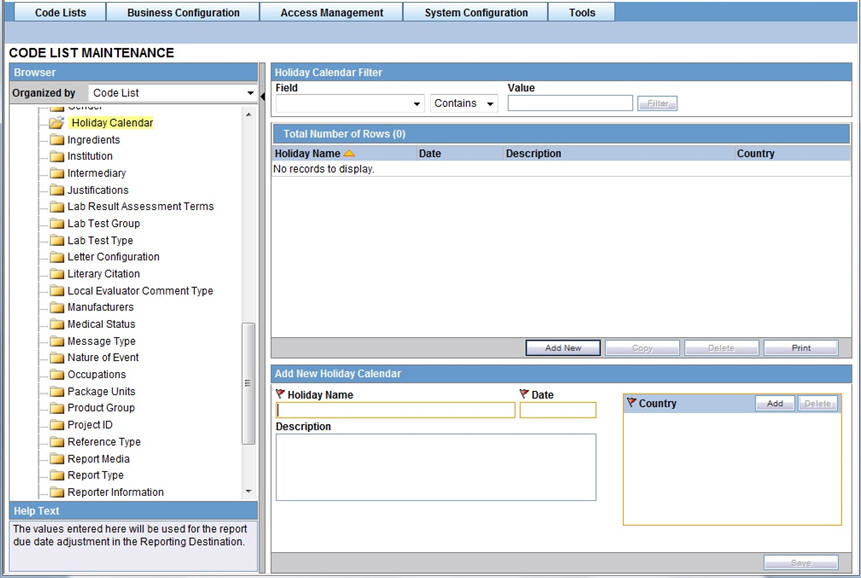

6.1.12 Configuring Holiday Calendar
This screen enables you to configure the Holiday Calendar information. The Code List allows the user to define holidays at country level.
Surrounding text describes holidaycal.jpg.
The Country of Reporting Destination will be matched with the Country in the Holiday Calendar to identify the holidays to be adjusted for the Reporting Destination.
Go to Code Lists > Argus to view the Code Lists page and click the Holiday Calendar folder in the left panel.
The associated report appears in the Total Number of Rows section in the right panel.
Tip:
6.1.12.1 Field Descriptions
Holiday Name This field displays the unique name for the holiday name.
Date This field displays the date on which the holiday has been scheduled.
Description This field displays a description of the holiday.
Country This field displays the name of the country (or countries) with which the holiday is associated.
  1. Click the Holiday Name (or row) to view the details associated with that Holiday Calendar. The details appear in the Modify Holiday Calendar section.
  2. You may use the Holiday Calendar Filter to make your search specific to a Holiday Calendar record. The filtering criterion is essential as it helps you to search for specific items.
    Tip:
    You can alternatively click Add New to create a new Holiday Calendar record.
    • Click Copy to make an editable copy of an existing Holiday Calendar record.
    • Click Delete to delete an existing Holiday Calendar record.
  7. Enter the Holiday Name for the Holiday Calendar.
  8. Enter the Date for the record.
  9. Enter the Country (or countries) with which the holiday must be associated.
  10. Enter the Description for the Holiday Calendar record.
  11. Click Save.

Justifications Enables you to capture justification information. You can enter reasons for overriding system determinations in the Justifications dialog box. The values that you enter here, appear in the Action Justification dialog.

Study Center Enables you to capture information about the study centers. Values entered here appear on a drop-down in the Clinical Studies Information dialog and on the Centers tab in List Maintenances. You can also add investigators for each center.
You can create a study center with the same center ID but with a different name and address.

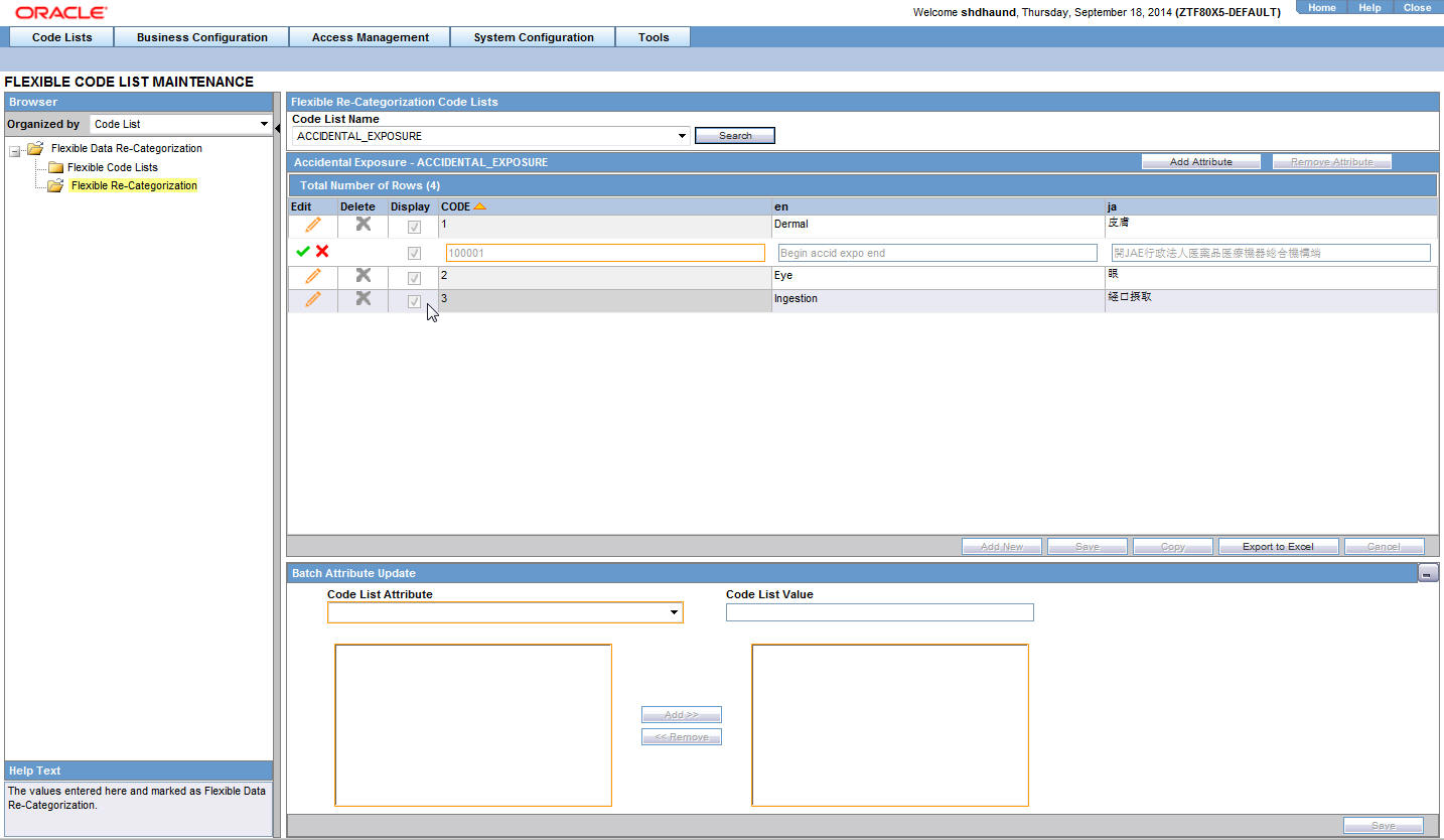

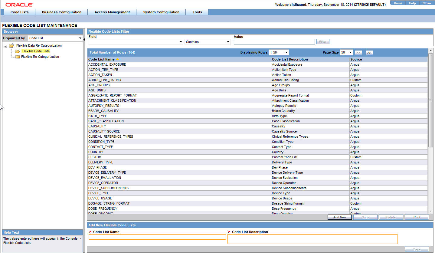

6.2.1 Flexible Code Lists
To access Flexible Data Re-Categorization:
  1. Go to Argus Console > Code Lists > Argus > Flexible Data Re-Categorization.
    Surrounding text describes fcl.jpg.
    The following table describes the fields associated with this section:
    Code List Name This is the unique name of code list which can be used in the application and reporting for fetching the values of a code lists. This is mostly derived from the source Argus Safety code list names. However, it can be different in some scenarios as per the customer need.
    Code List Description This is the description of code list which can be used to define the purpose of this code list.
    Source Argus: All the code lists which are part of Argus Safety factory configuration and can be edited using standard Argus console code list UI show the source as 'Argus'.
    Custom: Any code lists added as part of factory data which cannot be modified from Argus console standard code list UI are considered as custom.
    Any code list added by customers has source as 'Custom'.
  2. This page is used to add new values or view existing code list values in the code lists.
    Click Add New to add a new flexible code list item.
    To make any changes, users can select a code list, modify values in the given text boxes, and save those changes for modification.
    Click Delete to delete an existing flexible list item.
    Click Copy to copy an existing flexible list item.
  3. Click Save to save the new or existing flexible code list item information.
6.2.2 Flexible Re-Categorization
To access Flexible Re-Categorization:
  1. Go to Argus Console > Code Lists > Argus > Flexible Re-Categorization.
    Surrounding text describes fclcln.jpg.
    Code List Name This is a drop-down list that displays all the available flexible code lists for selection.
    Attribute Name This is the language Decode context for selected code list which can have language code and other properties of code lists.
    The following are possible values for this field for the factory data rows which will be populated based on the current code list factory data. Customer can add more language/type values for the new code list items that they create from flexible re-categorization screen, based on their usage:
    i. en: English display value for a code list item
    ii. jp: Japanese display value for a code list item
    iii. E2B: E2B code value for this code list item
    iv. RPT: Display value for Reports
    v. ISOA2: A2 country code for the country code list items
    vi. ISOA3: A3 country code for the country code list items
    vii. EN_ABBRV: This is used for defining abbreviation values.
    viii. SM: This decode context is used by Argus Mart while populating data into the SM tables.
    ix. UCUM_CODE: UCUM code value for this code list item. This is used in E2B(R3) and eVAERS reports.
    x. E2B_R3: E2B(R3) value for this code list item. This is used in E2B(R3) and eVAERS reports.
    xi. VAERS_CODE: VAERS Code value for this code list item. This is used in eVAERS and VAERS report mapping.
    xii. NCI_CODE: NCI code value for this code list item. This is used in eVAERS reports.
    Code List Display Value This the re-categorized display value for the code. This display value shall be based on a code list, code, and language combination.
    Add Attribute Enables you to add a language attribute.
    Remove Attribute Enables you to remove a language attribute.
    Code This is the first column in the gird for all flexible code lists. This column displays the internal id for the existing 'Code' list value. For custom code list, the application always populates the code columns with system generated unique sequence value for the selected code list. It is possible for customers to provide a custom 'Code' value for any of the new rows. This value is always unique for a code list.
    <All Language Attributes> All the language attributes are displayed as a new column in the grid with Primary attribute being the first one after the Code column.
    Right-click > Make Primary Allows you to make the selected language attribute as the primary attribute. The primary attribute column is moved as the first attribute in the grid after the 'Code' column. This configuration is available every time the user opens the same flexible code list.
    Right-click > Make Preferred Allows you to mark the selected cell values corresponding to selected language attribute as Preferred in the database. Preferred values are displayed with an asterisk (*) in the grid for easy identification. At any given time, only one value can be marked as preferred within matching values for a language attribute.
    Export to Excel Enables you to export all the values of selected code list into an excel file.
    Batch Attribute Update A collapsible interface, this option displays the list of all attributes available for the selected code list in Flexible re-categorization screen. It also provides a text box called Code List Value, where users can enter the required display value of the code list for the selected attribute.
  3. Click Edit. The grid cells of corresponding row become editable for all the attributes added in that code list by the user.
    On clicking Edit, a green tick mark is displayed, along with a red colored, cross icon.
    Click the green tick mark to temporarily save the grid values (until saved into database by clicking Save button). The selected row comes out of Edit mode.
    Click the red colored cross icon to discard any changes made to the selected row. The selected row comes out of Edit mode.
    On changing the value of a preferred cell, its preferred status is removed upon saving the grid values.
  4. Click Delete to allow the users to delete an entry from the flexible code lists. The Delete icon is enabled for only custom code lists, for which protected flag is set to 0 in CODE_LIST_CODE_ATTRIBUTES table. Click this icon to delete all the attribute values corresponding to the selected row from the database.
  5. The Display checkbox is checked by default (except for hidden entries), for a new row added into the flexible code list.
  6. Click Save to save all the changes made on flexible code list screen.
