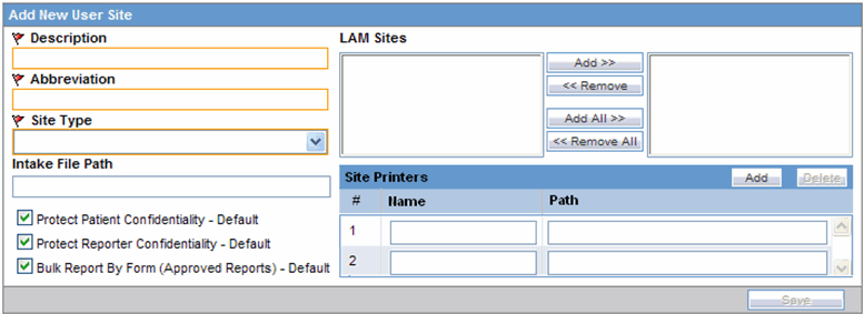

2.1.1 Configuring User Sites
Addition of Sites is necessary in order to create Users because every user must be assigned to exactly one Site. Site information can also be used in automatic numbering of case IDs.
To configure Sites, use the Access Management -> Argus -> Sites section. The following is an illustration of that section.
2.1.1.1 Field Descriptions
The following table lists and describes the fields on the screen.
Surrounding text describes usersitebk.png.
Field/Control Name Description
Description Enter a description of the site.
Abbreviation Enter an abbreviation of the site name. A one to four character abbreviation is required for each site.
Site Type Select the Site Type Argus or LAM (Local Affiliate Module).
Protect Patient Confidentiality - Default Protects or reveals Patient Confidentiality for the specific site.
Protect Reporter Confidentiality - Default Protects or reveals Reporter Confidentiality for the specific site.
Bulk report By form (Approved reports) - Default Allows or protects availability of the Bulk Reports by Form for the specific site.
LAM Sites Select and add previously created LAM sites.
Site Printers The Site Printers section is used to configure site printers.
2.1.1.2 Adding User Sites
This screen helps in capturing Site information (such as user site description, abbreviated term, site type and LAM site configuration).
Use the following procedure to add a user site.
  1. Click Access Management->Argus->Sites.
  2. In the left panel, select User Sites. The User Sites are listed in the right panel.
    Tip:
    You can alternatively click Modify to modify an existing site.
    Use Copy to make an editable copy of an existing user site.
    Use Delete to delete a user site.
  3. Select a User Site and click Add New.
    Surrounding text describes usersite.gif.
  4. Enter the user site Description.
  5. Enter the user site Abbreviation.
    A maximum four-character abbreviation is required for each user site.
  6. Select a Site Type.
    Each Argus Safety user must be assigned to exactly one user site.
    You cannot change the site type from LAM to Central if the current central site has an association with a LAM site, the current site is associated with any user, or the current LAM site has any events assigned to it.
  7. Select the following options as required:
    • Select the Protect Patient Confidentiality - Default to protect or reveal Patient Confidentiality for this specific user site.
    • Select the Protect Reporter Confidentiality - Default to protect or reveal Reporter Confidentiality for this specific user site.
    • Select the Bulk Report by Form (Approved Reports) - Default to enable availability of the Bulk Reports By Form for this specific site.
  8. Add or remove any LAM Sites information.
    Tip:
    To add more LAM Sites to the Lam Sites list, use the Add>>/ Add All options.
    To delete the LAM Sites from the Lam Sites list, use the Remove>>/Remove All options.
  9. In the Site Printers section, click Add to add a site printer.
  10. Enter the Name of the printer that will be displayed in the application when referring to the printer. The name can have up to 20 characters.
  11. To delete a site printer, select the printer and click Delete.

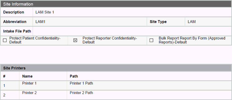

  12. Click Print to print the site information, as shown below:
    Surrounding text describes print.gif.
  13. In the Path text box, enter the full path of the printer on the network. This path name can have up to 256 characters. The specified path should be accessible from the machine where Argus Safety Service is installed.
  14. Click Save to save the information and return to the Code List Maintenance dialog.

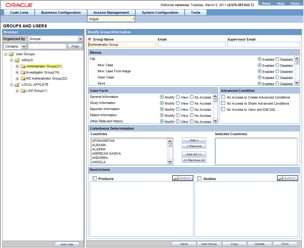

2.1.2 Configuring Groups
Each user of Argus Safety can be a member of one or more user groups. The access rights of each user group to the menus in the user interface and specific sections of the Case Form can be configured when the group is created.
Configuration of the user site is done using the Access Management->Argus -> Groups section.
2.1.2.1 Field Descriptions
The following table lists and describes the fields in the Modify Group Information section. Surrounding text describes groups.png.
Group Name Enter a unique name for the group.
E-mail Add the group e-mail, used for case priority notification and workflow routing notification.
Supervisor E-mail Add the Group's Supervisor E-mail as applicable. This e-mail address is used to send notifications when the maximum time of a case for a particular workflow state is exceeded.
Menus Lists the menus and sub menus within a Case Form and allows you to enable or disable each of them.
Case Form Lists the sections and sub sections within a Case Form and enables you to assign the group Modify; View (Read Only); or No Access (not visible) to each area.
Advanced Condition Allows you to configure advanced condition settings, as applicable. The options are: No Access to Create Advanced Conditions, No Access to Share Advanced Conditions, No Access to View and Edit SQL.
Listedness Determination - Countries Assigns Argus users to the group that has rights to change the listedness determination for licenses originating in the selected countries.
Restrictions - Products Limits the number of products that can be viewed in the trade name lookup and non-study cases.
Restrictions - Studies Limits the number of studies available for selection and the study cases that can be viewed.

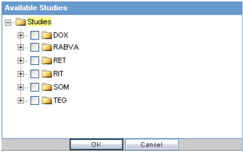

  1. Click the Studies checkbox to enable the Select button
  2. Click this button to view a security configuration containing a tree view list of available items
  3. Select a study family to select all its constituents
Default report (LAM only) Lists the expedited report forms in the drop-down list.
2.1.2.2 Adding User Groups
This section enables the Administrator to configure the security levels for each work group.
Radio buttons enable you to view the group and assign access rights for several specific sections of the case form, menu, case workflow, and report workflow.
If a user belongs to multiple groups, the access rights for the user will be the sum-total of the individual group access rights. Consider the following example:
John Smith is an Argus User and his profile has been added to 2 user groups with different access level permissions for each group.
  • John has access rights to the Patient Tab in one group and access rights to the General Tab in another group.
  • In this case, John will be able to access both the Patient and the General tabs of Argus
Use the following procedure to create a user group
  1. Click Access Management->Argus->Groups.
  2. Select the filtering criterion to display the list of Groups or Users in the left panel.
  3. Select a Group and click to view the group details in the right panel.
    Tip:
    • You can alternatively click Add Group to create a new group.
    • Use Copy to make an editable copy of an existing group.
    • Use Delete to delete a group.
  4. Enter the Group Name. This should be a unique name associated with this Group.
  5. Enter the Email address, if applicable.
  6. Enter the Supervisor Email address, if applicable.
  7. In the Case Form section, select the desired access right option (Modify, View, or No Access) for the group's access to each of the listed items of Case Form.
    The following fields are required in order to save a case: Initial Receipt Date, Country of Incidence, Report Type, Suspect Product, and Event Description as Reported. Therefore, the group responsible for initial case entry must have access to these fields in order to save new cases.
    The following user group accesses have been renamed:
    • Case Patient – Personal Patient Information has been renamed as Case Patient - Patient Information.
    • Case Patient – Patient Information has been renamed as Case Patient – Patient Details.
  8. In the Menus section, enable or disable access of the group, to particular items in the Argus Safety menu.
    Tip:
    Refer to the Argus Safety User Guide for information about the functions of the Case Form sections and the menu items in the Argus Safety user interface.
  9. In the Listedness Determination section, select a list of countries. This enables the end user to override the listedness determination in the Event Assessment section of the Case Form for product licenses that match the countries selected in this step.
  10. In the Advanced Conditions section, select No Access to Create Advanced Condition, No Access to Share Advanced Conditions, and/or No Access to View and Edit SQL.
    Only trusted users should be given access to Advanced Conditions. This is because users who have this access will have complete access to the information in the Argus Schema.
    Tip:
    • If you select No Access to Create Advanced Condition, Advanced Conditions does not appear as an option for that user group.
    • If you select No Access to Share Advanced Conditions, the user group does not have access to share Advanced Conditions.
    • If you select No Access to View and Edit SQL, the SQL... button will not appear as an option for that user group.
  11. In the Restrictions section, select Products.
  12. Click Add Product, to open the Available Products dialog box.
  13. Select each product you want to add and click OK.
    Surrounding text describes avalbl.png.
  14. In the Restrictions section, select Study.
  15. Click Add Study, to open the Available Studies dialog box.
  16. Click the appropriate checkboxes to select the required studies and click OK. Surrounding text describes studies.png.
  17. Click OK to save the group.

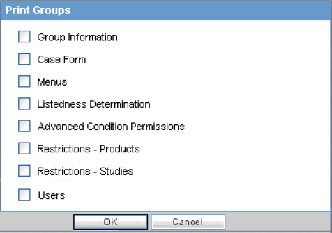

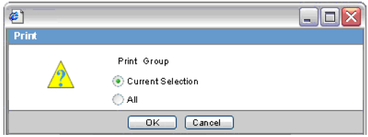

2.1.2.3 Printing a User Group
Use the following procedure to print a user group.
  1. Select Access Management->Argus->Groups.
  2. Select the filtering criterion to display the list of Groups or Users (based on the filtering criterion) in the left panel.
  4. Click Print to display a Print dialog that enables the user to choose to print the entire window or to print only the text covered by the current selection.
  5. Surrounding text describes printgroup.png.
  6. Select the appropriate options and click OK.
  7. The system opens the Print Groups to enable the user select the sections to be printed in the Group Configuration printout.
    By default, the Group Information checkbox is selected and disabled so that it always gets printed.
  8. Select the appropriate checkboxes, and click OK Surrounding text describes printgroups.png.

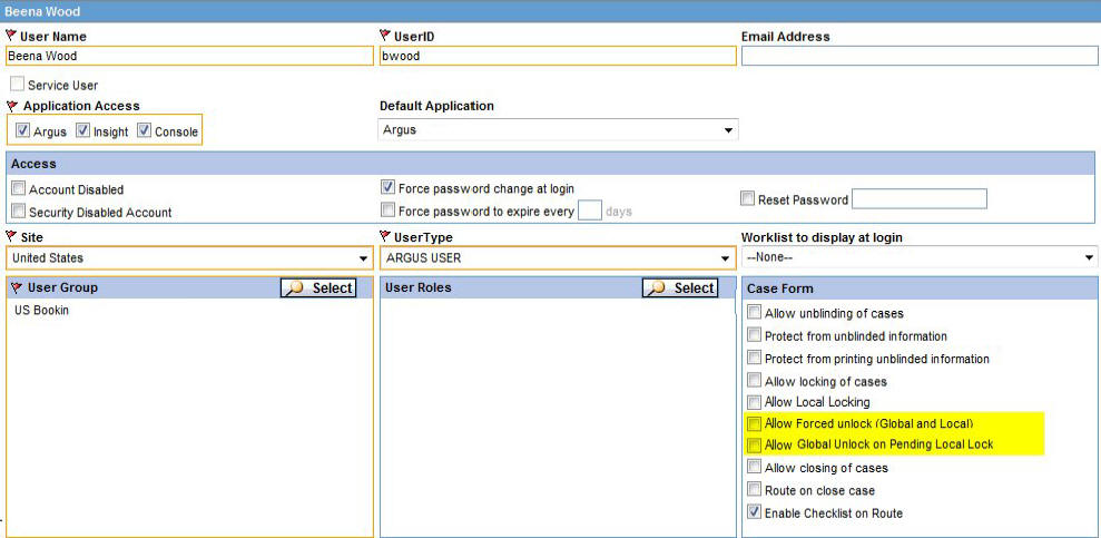

The following illustration shows the fields associated with this section.
Surrounding text describes caseunlock.jpg.
2.1.3.1 Field Descriptions
The following table lists and describes the fields in the Administrator section
User Name Enter the full name.
User ID Enter a unique user identification (ID).
Reset Password Reset the password of a user to a default value specified in the common profile section.
E-mail Address Enter the user's e-mail address.
Service User Mark this check box to specify that user is a Service user that is used in background processing.
Site Assigns the user to a site.
The values in this field are populated from the codelist item User Sites.
User Group - Select Attaches the user to pre-configured user groups.
User Type Select the type of user, such as an Argus J user from the drop-down list.
User Roles - Select Attaches the user to pre-configured user roles such as Global Admin. By default, a Global Admin role is granted to only an Administrator, who can grant/revoke this role to other Argus users. Such a user role should be assigned to users who need access to the Argus Global application. Similarly, you can also select from other roles present within User Roles.
Application Access Configure user access settings for Argus Console and Argus Safety.
The default application access for the user can be selected from the list.
Worklist to display at login Configure users to see their worklists immediately upon login. The options are:
  • None (default) - Does not open any worklist when the user logs into Argus. Displays personal Argus status on login.
  • Action Items - Opens Worklist - Action Items screen for the user on login into Argus
  • New - Opens Worklist - New screen for the user on login into Argus
  • Open - Opens Worklist - Open screen for the user on login to Argus.
  • Reports - Opens Worklist - Reports screen for the user on login into Argus
Enable site security If Enable Security is checked, the site-based data security will be enabled for the user.
If the box is not checked, the user will have full access to data from all sites.
Enable LDAP Login Authenticates users against the active directory server.
When Enable LDAP Login is selected, all fields inside the Access section are disabled, excluding the Account Disabled option.
Account Disabled When this option is selected, the user account is temporarily disabled to prevent users from logging in. This option is different from deleting a user as it enables the Administrator to re-activate the account at a later date.
Security Disabled Account
  • When unchecked, the login procedure keeps track of the number of consecutive unsuccessful attempts at logging into the system. If the count reaches three, the login procedure will always fail the password validation to lock the user out. Administrators with rights to user maintenance can reset the login attempts for the user to unlock the account.
  • When checked, the login procedure that tracks the consecutive unsuccessful attempts at logging into the system do not apply.
Force password change at login If this check box is selected, the users must change the password the first time user logs on to the system after the checkbox is checked.
Force password to expire every Enables the Administrator to force the user's password to expire in the specified number of days.
Days Enables the Administrator to enter the number of days after which the password should expire.
Allow unblinding of cases Enables the user to unblind a study case.
For example, a user without unblinding rights will not see the Study Drug field. A user with unblinding rights sees a yellow Unblind tag next to concentration of product field and the Broken by Sponsor option in Blinding Status drop-down list is enabled. User will have to enter password when user selects Broken by Sponsor' option.
Protect from unblinded information When checked, the user cannot view any unblinded information.
Protect from printing unblinded information When checked, the user cannot print any unblinded information.
Allow locking of cases Enables the user, to lock/unlock the cases.
Allow local locking Enables the user, to locally lock/unlock a case for which local Japan data entry/assessment is complete, triggering the scheduling and/or generation of the applicable local reports.
Allow Global Unlock on Pending Local Lock Allows users to be set up with the privilege to forcibly unlock a case that is still pending a local lock.
This option is enabled only if the Allow locking of cases checkbox (above) is checked.
Allow closing of cases Allows the user to close the cases.
Route on close case Opens a routing dialog when the user closes the case.
Enable Checklist on Route By default, this checkbox is selected.
If this checkbox is not selected, the checklist for the Workflow is not displayed to the user while routing the cases, even if the rule that is being used has a checklist.

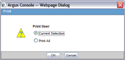

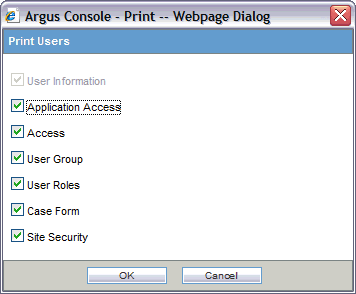

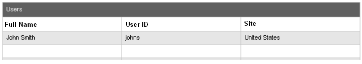

2.1.3.2 Printing Users
Use the following procedure to print users.
  1. Select Access Management > Argus > Users.
  2. Select a User and click to view the user details in the right panel.
  3. Click Print to display the Print User dialog. Surrounding text describes acp.gif.
  4. Click OK to display list of Print User options.
    Surrounding text describes acp2.gif.
  5. Select the appropriate option(s) and click OK.
