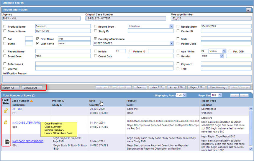

  1. Verify that the relevant case has been locked and the required report has been scheduled.
  2. Select Case Actions, and then click Open to view the Case Open form.
  3. Click Search to view cases matching the search criteria.
  4. When the system displays the search results, click the Lock State icon and select Case Details.
  5. When the system opens the Argus Safety Case Details dialog box, open the Scheduled Regulatory Reports folder and select the relevant regulatory report.

6.4.4 Search for duplicate reports
The Duplicate Search dialog box for an ICSR report enables you to search for possible duplicate cases in the Argus Safety system. You can select different combinations of search criteria. When more than one criterion is selected, only cases that satisfy all criteria are listed. By default, the fields that are present in the ICSR Report are checked for the Duplicate Search.
Surrounding text describes dupsearch.jpg.
6.4.4.1 View duplicate search options
Field Description
Onset Date The date from when the first reaction or adverse event occurred.
Reference # National Regulatory Authority's Report Number, used as a Reference Number.
ICSR Viewer Enables you to view the E2B report.
MIR Viewer Enables you to view the MIR report in XML and PDF formats.
View Differences Allows viewing differences between the current XML to be imported (a message that is not yet imported into the database), the current case data in the database, and if a case has been imported before, the last imported case.
Note: This button is available only for follow-up and nullification reports.
Action Enables you to view the Case Summary dialog box.
Reporter Displays the reporter involved with the case matching the search criteria.
This field appears in the search results.
Reference ID Searches on the following fields in the Argus case:
  • Additional Info | Case Reference ID
  • Reporters | Reporter's Reference #
  • Argus Case Number
Keyword By default, the first value from the incoming affiliate event appears.
6.4.4.2 Search duplicates for incoming review
The Duplicate Search in Argus Central Incoming review enables you to search on Reference ID and Keyword field in Argus cases.
You can right-click the Case Number for a listed case and use the following options:
Right-click Option Description
Case Form Print This option is displayed for only those users who belong to the group with access to Argus Console > Access Management > Groups > Menu > File > Print.
This option allows you to print the case form report.
Case Summary This option is displayed for only those users who belong to the group with access to Argus Console > Access Management > Groups > Menu > File > Open Case Summary.
This option allows you to open the summary report of the case.
Medical Summary This option is displayed for only those users who belong to the group with access to Argus Console > Access Management > Groups > Menu > File > Print.
It displays the medical summary of the case.
Unlock/UnArchive Case This option is displayed to allow users to re-open the archived and locked cases. On clicking this option, a Locked Case/Archived Case screen (as applicable) is displayed. You need to enter your password along with any remarks/notes and select a reason for your action to complete the unlocking/unarchiving of the case.
Note: This option is available only when the case is in locked/archived status, and if the user has privileges to lock/close the case, as per Console User Configuration > Case Form settings.

6.4.4.3.1 Accept initial E2B cases as follow-up
This option is enabled only when an initial case or case number is selected in the duplicate search output section.
  1. To add an ICSR as a follow up to the Case Number (that is highlighted in the duplicate search output section), click Accept Initial E2B Cases As Follow-Up.
  2. Click OK when the following pop-up dialog box appears:
    "Do you want to add this ICSR as a Follow-up to the Case Number<Num>?"
The Argus application attaches the incoming ICSR as a follow-up, to the selected case number highlighted in the duplicate search screen.
