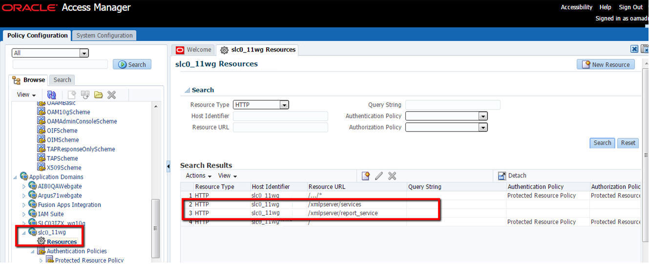

If OAM is the SSO being used, perform the following configuration:
  1. Add excluded resource (/xmlpserver/services and /xmlpserver/report_service) on OAM Server for the OBIEE/BIP server application domain.
    Surrounding text describes image101.jpg.
