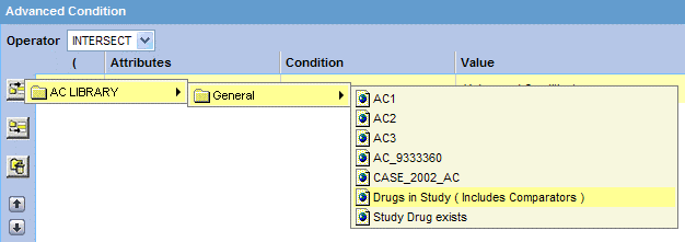

Advanced Conditions tab—Integrate a QBE with an advanced condition stored in Argus Insight. The advanced conditions based on Insight Mart only are displayed.
In addition, you can convert a QBE into an advanced condition. For more information, see Chapter 5, "Using Advanced Conditions to Create Queries on Insight Mart."

Click the Advanced Conditions tab.
In the Operator field, select a set operator to integrate the QBE and the advanced condition.
You may select INTERSECT, MINUS, or UNION.
Select the advanced condition to integrate with the QBE as follows:
Click the Add Advanced Condition Above icon on the left bar to open the Advanced Conditions menu.
This menu lists all the advanced conditions (based on Insight Mart only) that are stored in the system and accessible to you. The conditions are organized by categories.
Browse to the appropriate category, and select the required advanced condition.
The selected row is added in the Advanced Conditions Editor.
Click the Add Advanced Condition Above icon, or the Add Advanced Condition Below icon to insert another advanced condition above or below the existing advanced condition.
