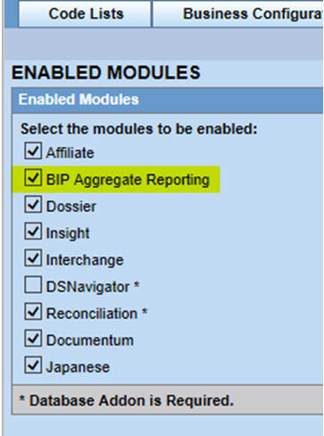

BI Publisher Periodic reports are not enabled.
Solution
On the Argus Console, navigate to System Configuration > Enabled Modules. Make sure that BIP Aggregate Reporting is checked.
Figure A-1 BIP Aggregate Reporting Enabled

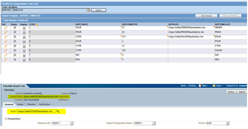

Cause
In Linux/Unix the report path is case sensitive. The Report path in the REPORT_TEMPLATE is empty or has an incorrect path.
Solution
The Report path present in the code list REPORT_TEMPLATE must have a proper value. The value can be verified by comparing it against the actual report path in the BIP Publisher catalogs.

| 1 | BIP Icons are not displayed against corresponding BIP specific fields/tabs in the Argus UI - Periodic Reporting Configuration | BI Publisher Periodic reports are not enabled in the Argus Console | In the Argus Console, navigate to System Configuration > Enabled Modules. Make sure that BIP Aggregate Reporting is checked |

| The Report path in the REPORT_TEMPLATE is empty or has an incorrect path | The Report path present in the code list REPORT_TEMPLATE must have a proper value. The value can be verified by comparing it against the actual report path in the BIP Publisher catalogs. In Linux/Unix the report path is case sensitive. | ||
