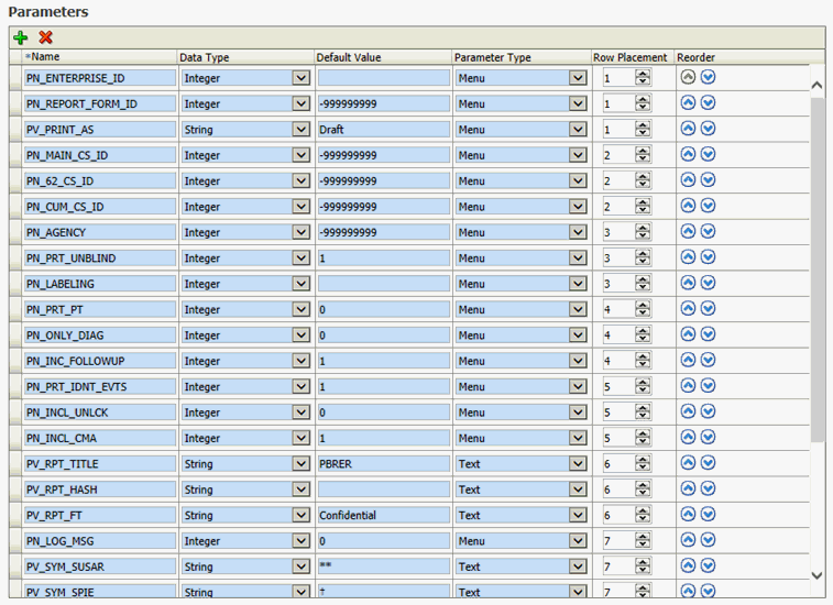

Parameters are part of the data model. Figure 5-2 displays the parameters of the PBRER.
The data model has the following types of parameters:
Text
Menu (list of values)
Date
Text parameters are the simplest form. If you provide a default value, the system considers it automatically when no value is passed.

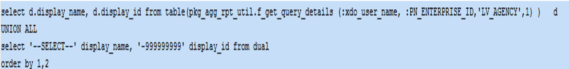

Menu parameters are LOVs and are associated with attached queries. For example, the AGENCY parameter is associated with the query in Figure 5-3.

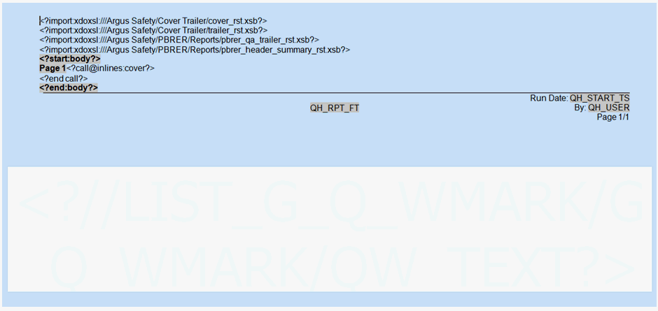

BI Publisher Periodic Reporting uses Rich Text Format (RTF) for its templates. The layout maps the data sets and displays data at run time. You can also design the data model so the template calls other layouts within itself.
Figure 5-4 displays a portion of the PBRER data model. The report template calls other templates from the Cover and Summary pages.
