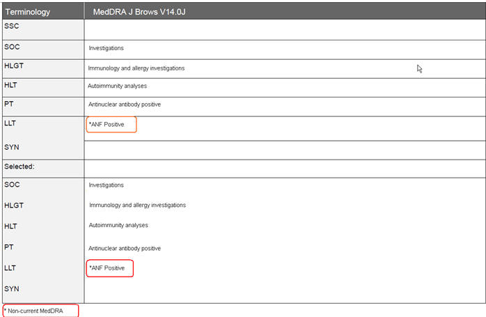

Non-current terms:
Non-current terms are flagged at the LLT level within MedDRA.
These are not recommended for continued use but are retained within the terminology to preserve historical data for retrieval and analysis.
Terms that are vague, ambiguous, outdated, truncated, or misspelled.
Terms derived from other terminologies that do not fit MedDRA rules.
The Include Non-current Terms option in the MedDRA browser allows users to expand their search results on local MedDRA dictionaries to non-current terms too.
The Non current LLT terms are displayed preceded with an asterisk (*) symbol separated by a space, in the search results grid as well as bottom section which displayed the selected term details. On clicking on non current term, the system displays its PT, HLT, HLGT, and SOC terms.

On selecting a noncurrent term in the MedDRA browser by clicking Select button, the following message is displayed:
Selected term is a non-current term in the MedDRA dictionary. Please select a current term.
The MedDRA Browser print PDF also displays the asterisk (*) symbol in front of the non-current LLT.
