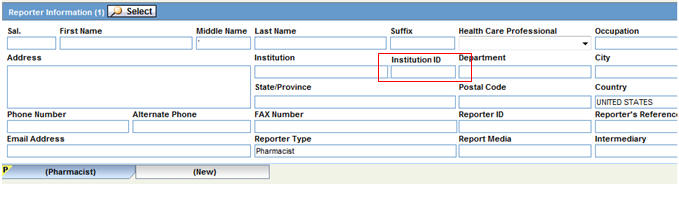

The Institution ID textbox in Case Form > Reporter Information section is available for both English as well as Japanese users.
The following are the attributes for this field:
Field Name (Unique Field Label): Reporter Institution ID
Field Form Label: Institution ID
Field Form Label (J)
Help Text: Enter the Institution ID for the Reporter.
Help Text (J)
Hidden radio option set to No. Hiding is allowed.
Read Only options are unchecked and disabled.
E2B Field and Research Field are unchecked by default.
Japanese IME Toolbar is disabled for this field in Case Form even for Japanese user.
Case Form Field Length: 15 AN. No validation required for alphanumeric data check.
Both English and Japanese fields point to a common value.
This field value is populated based on the Institution ID selected for the Reporter from the Report Information Lookup dialog from the Book-in screen.
This field also allows manually entered / updated value directly in the Case Form irrespective of the value specified in the Institution field for the reporter. Manually entered Institution and institution ID field values are allowed in the Reporter Information section even if they are not specified / linked to each other as per Console Institution code list.
As both the Institution or Institution ID fields can be present in Reporter Information, and if the user opens up Reporter Lookup for this reporter, then Reporter Lookup searches for reporters in Case or Console data based on the following logic:
Out of Institution and Institution ID fields first use Institution ID field with the rest of the search criteria fields. The Institution value is not used in this scenario on the Reporter Lookup search dialog.
If the Institution ID field is not specified in the Reporter Information or if it does not exist in the type-ahead values for this field on Reporter Lookup, then automatically remove the Institution ID field value in Reporter Lookup and search based on Institution field with rest of the search criteria fields.
If Institution field value also does not exist in the type-ahead values for this field on the Reporter Lookup, then remove the Institution field value as well in the Reporter Lookup and search based on rest of the search criteria fields.
If "Search all the reporters who belong to the institution found from the current search item" search option is also used, then it performs a search based on Institution ID or Institution Name - whichever is available on the Reporter Lookup dialog to identify the first set of reporters and subsequently use those reporters for second level search.
This field is printed in Case Form Print for Reporter Information section as displayed for both English and Japanese users.
This field is audit-logged.

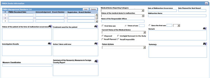

The PMDA Device Information section below Device Information section on Case Form > Products tab > Device sub tab contains fields as specified in the screen mockup displayed below:
This case form section is available to all Oracle Argus Safety Japan (Argus J) users on both English as well as Japanese views as uncollapsed by default only when Japanese module is enabled.
It is displayed with Japanese labels on both English as well as Japanese views as this section is not meant for translation of data.
The Modify, View and No Access rights to this section are based on the "Product Information (Device View)" option in Console > Access Management > Groups > Case Form section.
Tabbing order of case form elements respects this section in the order of UI elements as left to right and top to bottom.
The "PMDA Device Information" checkbox in Case Print - section selection dialog only to the Argus J user.
This checkbox is added right after "MedWatch Device Information" option in the Case Print options dialog. All the options after it are shifted further by one place.
This checkbox gets selected and unselected when user uses "Select All" and "Unselect All" options.
This checkbox remains unchecked by default and is disabled unless its parent section checkbox "Product Device Information" is checked by the user. If "Product Device Information" is unchecked later, then "PMDA Device Information" also gets unchecked and disabled. Case Form Print PDF report prints this section in Japanese after "MedWatch Device Information" section if it is selected for printing in the section selection dialog.
The "PMDA Device Information" checkbox in Case Copy - section selection dialog only to the Argus J user.
This checkbox is added right after "MedWatch Device Information" option in the Case Copy options dialog. All the options after it are shifted further by one place.
This checkbox is selected and deselected when the user uses the "Select All" and "Unselect All" options.
This checkbox is unchecked by default and is enabled for user selection.
The Case Form Copy function copies this section when a case is copied with this section checked in the Case Copy options dialog.
All fields of this section are audit logged as other case form product device fields.
All fields of this section are available under Console > System Configuration > Field Labels, Field Validations, and Advanced Conditions screens under the tree structure ARGUS SAFETY > PRODUCTS > PMDA Device. These fields are NOT required for Aggregate Reports.
In Console ' System Configuration ' Field Labels screen, all these fields are available with the following attributes:

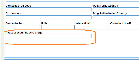

The Route of acquiring OTC drugs field under Product Information captures the route of acquisition of company's own products in form of pre-defined PMDA specified code list values, when it is an OTC drug, and is transmitted in the J2.6k element of PMDA E2B (R3).
This field is available in the J view only to the local user for Local data entry after global lock.
This field is enabled only when the product is marked as suspect, and there exists at least one Japan license in the case for which Console > License Configuration > "OTC Product" flag is marked as checked.

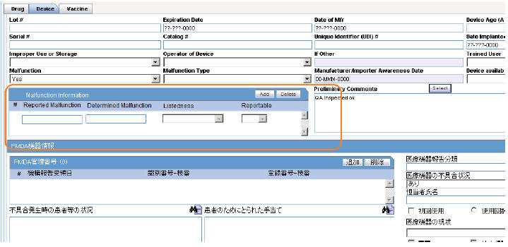

The Malfunction Information section is available under Case form > Products > Device (Tab) > Device Information.
Description of the illustration ''fig2.jpg''
This section contains the following fields:
Reported Malfunction: Enter the Malfunction Name as reported by the Reporter.
Determined Malfunction: Enter the Malfunction Name as Determined by the Company.
Listedness: Select the Listedness of Malfunction in respect of the device. This drop-down list has the values:
<blank> (default)
Listed ![]()
Unknown ![]()
Unlisted ![]()
Reportable: Select the Reportabilty of the Malfunction. This drop-down list has the values:
<blank> (default)
Yes ![]()
No ![]()
Add: This button lets you add a new blank row to the table, and is always enabled.
You can add up to 50 rows using this button. If the number of rows exceed 50, on click of Add button, an error message is displayed.
When this screen re-loads or is refreshed, the empty rows are not displayed.
The first row is highlighted in light yellow (selected) by default as standard Case Form behavior.
Delete: This button lets you delete a row from the table, and is always enabled.
To delete a row, select a row, and click Delete.
A warning message is displayed.
Future Actions: This drop-down list has the values:
<blank> (default)
Recall (Repair) ![]()
Request to suspend the use ![]()
Providing the information
TBD ![]()

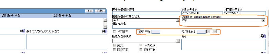

A new field, Status of Patient's health damage, has been added under Case form > Products > Device (Tab) > PMDA Device Info. This drop-down list has the values <blank>, Exists, Does not exist and Unknown.
You can select any value in PMDA Device Info > Medical Device Reporting Category irrespective of the Device Information > Malfunction value. This implies that irrespective of the value selected in the Malfunction drop-down list, you can select all the possible values under Medical Device Reporting category.
You can enter values in First time use, Times of use and Since the first use fields at the same time, independent of each other.

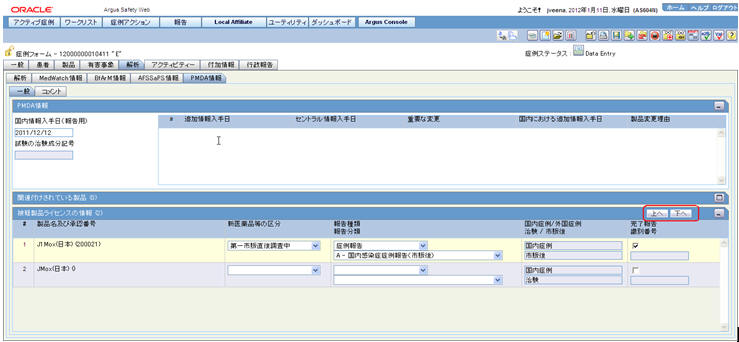

Up and Down buttons have been added to the PMDA tab.
By default, the focus is on the first record. No action is performed when the user clicks on "Up" button when the focus is on the First record. If the focus is on any other record other than the first record, the system interchanges the position of the current record and previous record by clicking the "Up" button.
No action can be performed when the user clicks on "Down" button when the focus is on the Last record. If the focus is on any other record other than the last record, the system interchanges the position of the current record and next record by clicking the "Up" button.
If there is no row in this section, then clicking on "Up" and "Down" buttons does not cause action.
For existing customer data, the sort order value for existing records is populated as same as the order in which these were displayed to the user.
The change in ordering of these product license rows in PMDA General tab is audit-logged.

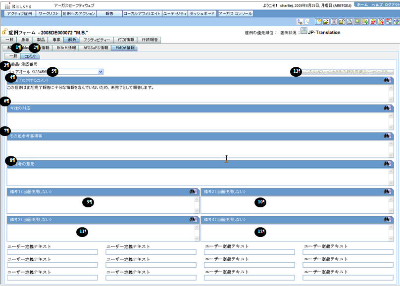

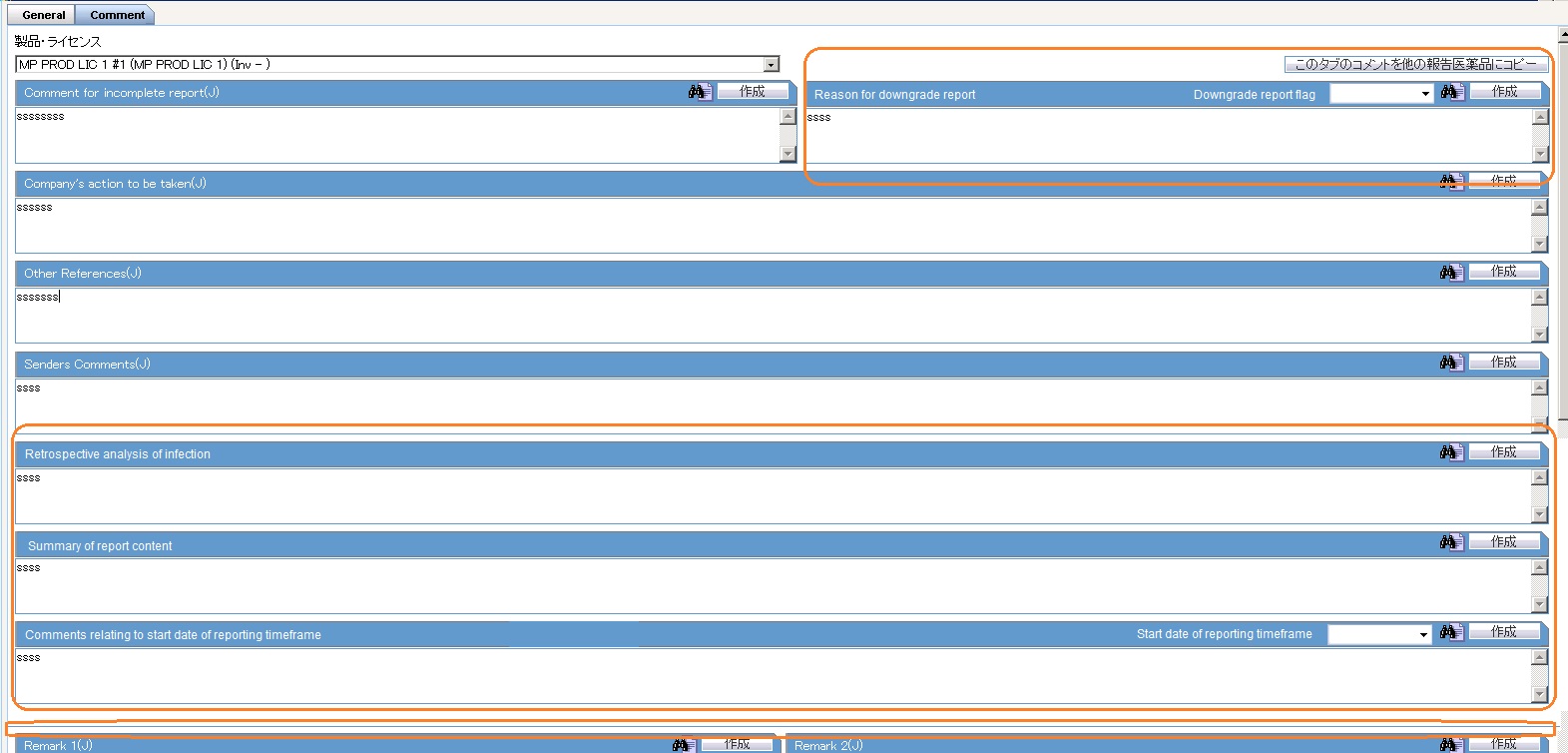

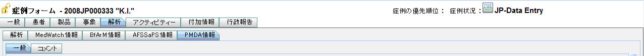

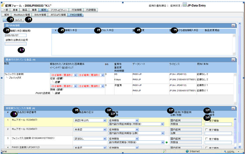

The PMDA Information tab comprises two sub-tabs: General and Comments, as depicted in the following figure:
The details about the General and Comments sub-tabs are given in the following sub-sections:
The following figure depicts the General sub-tab of the PMDA Information tab:
The following table lists the fields in the General tab:
Table 1-1 Fields in the General tab
Field Name | Description |
1 |
General |
This represents the name of the sub-tab under PMDA tab. |
2 |
Comment |
3 |
Japan first information Received Date (For Reporting) |
This field represents the editable text box which displays the date the case was received by the Japanese pharma company (initial receipt date captured during case book-in). The format is YYYYMMDD. In case of a local case, this date represents the Case Initial Receipt date. In global case, this date is automatically populated by the date first opened by J user. The value is stored in the case when you perform direct/indirect Save. For example, accept from worklist stores the value indirectly. |
4 |
Follow-up received date |
This field represents the non-editable text box which displays the date the case follow-up information was received by the pharma company. If the follow-up is marked significant, the Japan Follow-up Received date is used as the reference date to schedule the reports. The format is YYYYMMDD. |
5 |
Safety received date / or Central received date |
This field represents the non-editable text box which displays the date the Safety group received the case. The format is YYYYMMDD. |
6 |
Significant Changes |
This is a non-editable checkbox to indicate whether the follow-up is significant or not. If the follow-up is significant, the Japan Follow-up date overrides the date used for report scheduling. |
7 |
Japan follow-up received date |
This field represents the editable text box which displays the date the case follow-up information is received by the pharma company. If the case is originated in some country other than Japan, this date represents the date first opened by the J user after the follow-up. If the follow-up is marked significant, the Japan follow-up received date is used as the reference date to schedule the reports. The format is YYYYMMDD.The time stamp of Case Open date done by first Japanese user after the latest foreign follow-up is automatically populated.The value is stored in the case when you perform direct/indirect Save. For example, accept from worklist stores the value indirectly. |
8 |
Drug name and license number |
The number of rows in this section is equal to the number of reports that need to be submitted to PMDA for this case. One report is scheduled for each of the Marketed License. One report each is scheduled for each Study License. The field is read only and show concatenation of Trade Name with License Number in brackets. |
9 |
New Drug Category |
This field represents the drop-down to select License Category LM to select value for E2B J.8 item. |
10 |
Japan Reporting type (OBSOLETE) |
This field indicates the Reporting Type. It is a drop-down list showing three possible values: Case Reporting, Research Reporting, and Action Taken. NOTE: This dropdown is no longer available. However, as per the standard approach, the existing database column along with existing value are retained as is, the text "OBSOLETE" is added at the beginning of the DB column comments (for both upgraded and fresh schema). The database column is marked as deprecated during the upgrade script. |
11 |
Japan Reporting category |
This field represents a drop-down List containing Reporting Category LM. This is a mandatory field for Argus J user. The selection of this field determines the report being created (ADR, Infection, Research, or Measures in foreign countries). The entries shown in this list are determined at run time by the values selected in items 9,10 and 12.When Reporting Category is not selected, the license does not create the report.The format of the value displayed in this drop-down is: [Reporting Category] - [Description] |
12 |
Domestic Case / Foreign CaseClinical / Marketed |
There are two fields which are non-editable text boxes. The first shows whether the case is foreign (if the country of incidence is not equal to Japan) or domestic (if the country of incidence is Japan).The second field shows the license type: Investigational, if the license on which the ICSR is based on is for an investigational drug, device, or vaccine. Marketed, if the license on which the ICSR is based on is for a marketed drug. |
13 |
Completion Report (Case Complete) |
This checkbox indicates the completion of the case report. A new Case Complete checkbox field is added to the License List box. This field is the driver for the E2b field J.6. A separate J.6 must be recorded for each ICSR. By default, this box is not checked. |
14 |
PMDA Identification Number |
The PMDA Number is displayed in the PMDA tab where all the ICSR licenses are displayed. This is the PMDA Acknowledgment Number given in Ack message item B.1.3. This number is used in J.4b from the first follow-up report. |

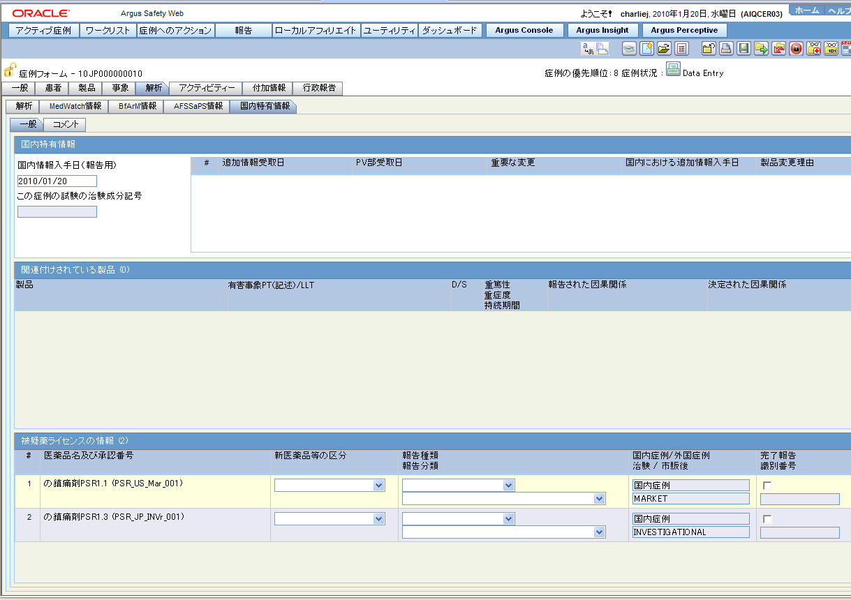

The following are the functionality changes for the PMDA Information > General tab:
This tab is unique to Argus J module implemented system. It also displays the number of reports to be submitted for the case. Each row in the lower section represents a report. The number of reports to be submitted for a case is determined as per the following logic:
General Rule
Reports are submitted for Marketed or Investigational licenses in Japan only for the suspect company products in the case.
All Japanese licenses (including hidden) listed in the event assessment are listed.
All suspected products with license and all Investigational licenses are listed in the PMDA General Tab.
Priority order of the Suspected product (Drug, Device, Vaccine) list is:
Primary Suspected Product License
Product entry order in the Case Form
Marketed license, then Investigational
The license is displayed as the Trade Name and the License Number in parenthesis.
Japanese Receipt Date and Follow Up Dates table:
It captures the Japanese received date label as Japanese received for each recorded follow-up in the PMDA tab. The system displays a list of all follow-ups that are entered in the General tab with the option to specify Japanese received for each follow-up entry.
When you change the Japanese Received Date from default, the justification pop-up with the message Please enter the reason of information receipt date change is displayed, wherein you are required to enter the reason of this date change.
When you change the Japanese Receipt Date or Japanese Follow-Up Date, if the changed date is older than the date in the Information Receipt Date of General tab, a pop-up window with the following error message is displayed:
The date cannot be older than the first information receipt date of the case.
For the purpose of Report Scheduling in Japan, the Japanese Aware Date is used by checking the flag on Use Japanese Aware Date for Reporting as configured in the Reporting Destination Code List of Console. The Japanese Aware Date has the same behavior as the Standard Aware Date.
Reporting Category:
The Reporting Category is a drop-down list with the values from Reporting Category Code List.
The Reporting category is a drop-down list with the values, as indicated in the table below. The drop-down content of the field depends on the previous selection in:
AE/Infection (in Infection check box in Event tab) - This is used only if all the events are AE, or all the events are Infection.
Domestic / Foreign (in Country of Incidence, PMDA tab, Dom = JP, Frgn <> JP)
License Type (Investigational or Marketed)
You can refer to the following table for the list of Reporting Categories in the drop-down list.
The system clears the Japan Reporting Category if the dependent fields are modified after the selection has been updated.
Table 1-2 List of Reporting Categories

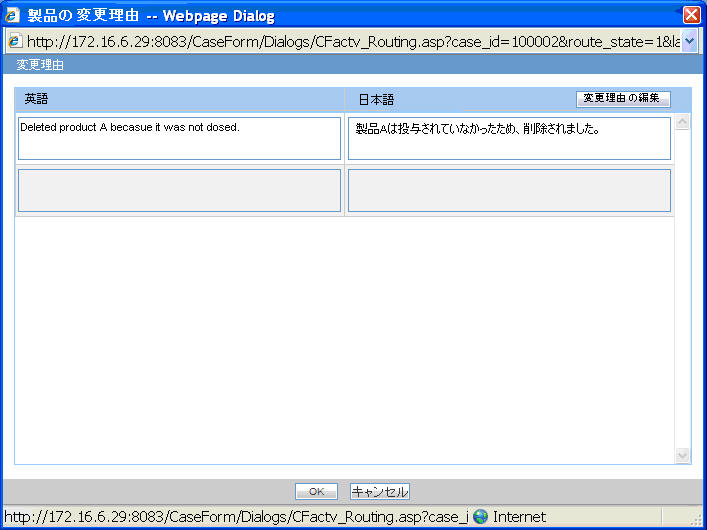

The Justification list populates all the product justifications entered for the follow up.
The Translation justification is editable using the following steps:
Select the justification from the list. This highlights the row.
Click the Editing the justification button.
This opens Justification pop-up and you can edit the justification.

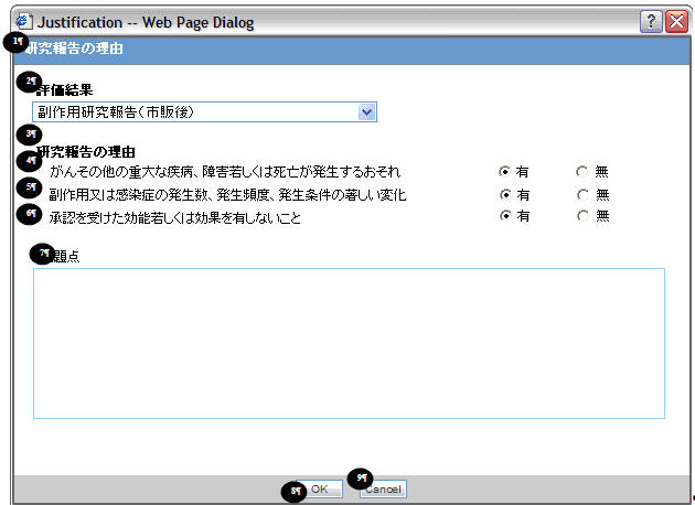

When you select the Research Report Type Reporting category, a pop-up Reason for subject of the Research Report is displayed to enter the reason of the Research report.
The pop-up UI section opens only when any one of the suspected drug license table has one of following Reporting Category selected:
Table 1-4 Reporting Categories
Reporting Category (English meaning) |
5 |
Research/Infection report (Marketed drug) |
6 |
Research/ADR report (Marketed drug) |
12 |
Research/Infection report (Investigational drug) |
13 |
Research/ADR report (Investigational drug) |
15 |
Research report (Quasi drug) |
16 |
Research report (Cosmetics) |
The information is multiply stored when multiple suspected licenses with the Research Reporting Category exist. Each Research Reporting Category has a circle in Green color symbol after the justification is entered in the pop-up window.
User Interface:
The following table explains the fields used in the Justification dialog box:
Field Label Value | English Label Name | Purpose | Field Length | Audit Log |
| 1 | N/A | Reason of Research Report | Title of the UI | N/A | N/A |
| 2 | N/A | Assessment Result | Read Only | N/A | N/A |
| 3. | N/A | Reason of Research Report | Title of the section | N/A | N/A |
| 4. | Reason for subject of the Research Report - Possibility of occurrence of serious disease such as cancer, disorder, or death | Possibility of occurrence of serious disease such as cancer, disorder, or death | Radio button Yes - exists
無No - does not exist |
N/A | Yes |
| 5. | Reason for subject of the Research Report - Significant change on event or infection occurrence number, frequency, and condition | Significant change on event or infection occurrence number, frequency, and condition. | Radio button Yes - exists
N/A | Yes |
| 6. | Reason for subject of the Research Report - It doesn't have acknowledged effectiveness | It doesn't have acknowledged effectiveness | Radio button Yes - existsNo - does not exist | N/A | Yes |
| 7. | Reason for subject of the Research Report - Problems | Problems | Text Field, 20,000 field length. | 20,000 | Yes |
| 8. | N/A | OK | Button | N/A | N/A |
| 9. | N/A | Cancel | Button | N/A | N/A |
Items # 4, 5, and 6 have radio buttons Yes and No to store the answer.
Field #2, Assessment Result, is a read-only field to show either the value from Literature Intake Assessment or the Reporting Category selected in the PMDA General tab. The following table illustrates the drop-down content based on the Reporting Category:
Drop-down Content (English meaning) | Reporting Category |
| 1 | Not Necessary | |
| 2 | AE Case | A, B, C, D, H, I, J, K |
| 3 | Research/Infection report (Marketed drug) | E |
| 4 | Research/ADR report (Marketed drug) | F |
| 5 | Research/Infection report (Investigational drug) | L |
| 6 | Research/ADR report (Investigational drug) | M |
| 7 | Research report (Quasi drug) | O |
| 8 | Research report (Cosmetics) | P |
| 9 | Measures in foreign countries including discontinuation of manufacture, recall and withdrawn (Marketed drug) | G |
| 10 | Measures in foreign countries including discontinuation of manufacture, recall and withdrawn (Investigational drug) | N |
The Problems section text field stores text information.
At least one Yes radio button has to be filled in the User Interface, and if this condition suffice, the UI can be closed. If this is not fulfilled, a message:
At least one question has "Yes" selected is displayed to suffice the condition.
This is not printed in the Case Form Print.
Once you select Research Reporting Category and enters the reason, and then re-selects the Reporting Category to Non-Research Reporting Category, the system displays a warning message:
Trying to select non-Research Reporting Category. If changed, the already entered "Reason of the Research Report" will be removed. Continue? is displayed.
If you select OK, the reason is deleted. If Cancel is selected, the Reporting Category change is aborted.

The following figure depicts the Comments sub-tab of the PMDA Information tab:
The following table lists the fields in the Comments tab:
Table 1-5 Fields in the Comments tab
1 |
General |
This represents the Sub-tab of the PMDA Information tab. |
2 |
Comment |
3 |
Product, License No |
This is a drop-down field. It allows you to enter J specific narrative information based on the each suspected drug license. |
4 |
Comment on incomplete |
This field is unique to Japan. This field is an editable text that maps to DTD element J.7 as per PMDA. In case of an incomplete report, input a comment in J.7 <mhlwadmicsrcommentsincomplete> for the report being incomplete. |
5 |
E.g. Cure_All MKT (xxxxxxxxxxxxxxx) |
This field represents the E.g. Sample License for which the narratives are being written. All the narratives written in the various text boxes are applicable to this License. |
6 |
Counter measure for the future |
This field is unique to Japan. This field is an editable text that maps to the J.9<mhlwadmicsrcountermeasures> DTD element as per PMDA.The company inputs the counter measures for the future based on the evaluation made by the reporting company on the concerned adverse effect infection, etc.For foreign case, the company inputs the counter measures taken by the Japanese reporting company, and not the foreign company. The field size is 10000J. |
7 |
Other references |
This field is unique to Japan. This field is an editable text that maps to the J.10/J2.11<mhlwadmicsrreporttimesevent.> DTD element as per PMDA for E2B (R2) or E2B (R3) respectively. |
8 |
Comment of sender |
This field is unique to Japan. This field is an editable text. This refers to the B.5.4 < sendercomment > element. |
9 |
Remarks 1 |
This field is unique to Japan. This field is an editable text that maps to the J.13.1 DTD element as per PMDA. The DTD element name is:<mhlwadmicsrremarks1> |
10 |
Remarks 2 |
This field is unique to Japan. This field is an editable text that maps to the J.13.2 DTD element as per PMDA. The DTD element name is:<mhlwadmicsrremarks2> |
11 |
Remarks 3 |
This field is unique to Japan. This field is an editable text that maps to the J.13.3 DTD element as per PMDA. The DTD element name is:<mhlwadmicsrremarks3> |
12 |
Remarks 4 |
This field is unique to Japan. This field is an editable text that maps to the J.13.4 DTD element as per PMDA. The DTD element name is:<mhlwadmicsrremarks4> |
13 |
Copy the comments in this tab to other reporting licenses |
This button copies all the comments in the UI to other licenses in the list. When there is only one product, the button is disabled. |
The following new fields have been added to enter information for each license that is available in the Product, License No drop-down:
Retrospective analysis of infection
Summary of report content
Comments relating to start date of reporting timeframe
Start date of reporting timeframe drop-down list
Reason for downgrade report
Downgrade report flag drop-down list with the options System Calculated, Downgrade, Nullification

This tab has auto text generation functions on each text box:
UI: (buttons are located on the right side of each binocular icon).
The label of the button Generate
The function of the button is the same as Generate buttons in the Analysis tab. The PMDA tab does not have English or other languages equivalent fields, therefore, the auto narrative functions populate the texts by using Japanese Narrative template of the Console Configuration.
The following new comments fields are added in the Product License No dropdown list:
Retrospective analysis of infection (J2.9): Captures the information from analysis of infection cases for blood products as specified in the PMDA Guideline for Retrospective Review of Blood Products. This will be used only for reporting of infection case reports.
Summary of report content (J2.16): Capture the summary of the main issues found in the respective report for Study Reports and Reports on Overseas > Actions.
Comments relating to start date of reporting timeframe (J2.2.2): Captures any user comments for explaining the value of J2.2.1 – Start date of Reporting Timeframe element in the PMDA E2B (R3) report.
Start date of reporting timeframe: This is the corresponding dropdown list added to capture the manual user input for J2.2.1 - Start date of Reporting Timeframe element in the PMDA E2B (R3) report. This dropdown list has the following value:
- System-Calculated
: This is the default value and the value for all the Aware date (J) (Japanese date format) i.e. the date's corresponding to significant follow-ups for that case. you may change the value manually.
Reason for downgrade/Nullification report (J2.8.2/C.1.11.2): Captures the reason for downgrading/nullification of a report.
Downgrade report flag: A corresponding dropdown list is added to capture the manual user input to indicate to the application if next PMDA E2B/Paper report for the license is scheduled as a downgrade or nullification in the scenario when no reporting rule matches. This dropdown list has the following values:
- System-Calculated
(Default)
- Downgrade ![]()
- Nullification ![]()
To edit both Comments relating to start date of reporting timeframe and Reason for downgrade/Nullification report dropdowns after the case lock (globally and locally locked), set the profile switch Allow user to update the "Reason for Downgrade/Nullification report" and "Comments for start date of reporting timeframe" after the case is locked(globally and locally locked) as Yes.

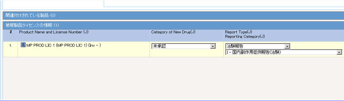

The Product License display value on PMDA tab has been changed at the following places:
PMDA General tab > Product Licenses section ' Product License column
PMDA Comments tab > Product License dropdown field
The following display value format is used at these places for product license values:
<Case Form Product Tab Name (J)><space><#[x]><space>(<License Trade Name (J)>)<space>(<License Type><space>-<space><License Number>)

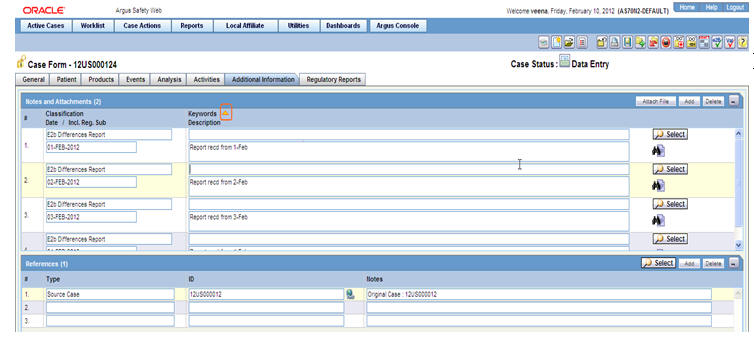

Notes and Attachment section of Additional Info tab has been updated with an option to sort on the column headers (similar to Activities tab 'Action Items sorting feature) to sort the records based on the fields in Notes and Attachment section:
| Field | Description |
| # | By default, "Upward Arrow" is displayed on the column header "#"
System displays the records in the ascending order of the sequence in which the records are entered. On clicking the column header "#" for the first time, records are sorted in the descending order (numerically) of the Sequence number and "Downward Arrow" are displayed next to "#" column header. On clicking the column header "#" for the second time, records are sorted in the descending order (numerically) of the Sequence number and "Upward Arrow" are displayed next to "#" column header. On subsequent clicks to "#" column header, system toggles between "Downward Arrow" and " Upward Arrow " and its corresponding toggle functionality. |
| Classification | On clicking this column header for the first time, records are sorted in the ascending order (alphabetically) of the Classification and an "Upward Arrow" is displayed next to the "Classification" column.
On clicking this column header for the second time, records are sorted in the descending order (alphabetically) of the Classification and a "Downward Arrow" is displayed next to the "Classification" column header.n header. On subsequent clicks to the "Classification" column header, the system toggles between "Upward Arrow" and "Downward Arrow" and its corresponding toggle functionality. |
| Keywords | On clicking this column header for the first time, records are sorted in the ascending order (alphabetically) of the "Keywords" and an "Upward Arrow" is displayed next to the "Keywords" column header.
On clicking this column header for the second time, records are sorted in the descending order (alphabetically) of the "Keywords" and a "Downward Arrow" is displayed next to the "Keywords" column header. On subsequent clicks to the "Keywords" column header, the system toggles between the "Upward Arrow" and "Downward Arrow" and its corresponding toggle functionality. |
| Date | On clicking this column header for the first time, records are sorted in the ascending order (chronologically) of the "Date" and an "Upward Arrow" is displayed next to the "Date" column header.
On clicking this column header for the second time, records are sorted in the descending order (chronologically) of the "Date" and "Downward Arrow" is displayed next to the "Date" column header. On subsequent clicks to the "Date" column header, the system toggles between "Upward Arrow" and "Downward Arrow" and its corresponding toggle functionality. |
| Description | On clicking this column header for the first time, records are sorted in the ascending order (alphabetically) of the "Description" and an "Upward Arrow" is displayed next to the "Description" column header.
On clicking this column header for the second time, records are sorted in the descending order (alphabetically) of the "Description" and a "Downward Arrow" is displayed next to the "Description" column header. On subsequent clicks to the "Description" column header, the system toggles between the "Upward Arrow" and "Downward Arrow" and its corresponding toggle functionality. |
Sorting is remembered only till the time when the case is kept open.

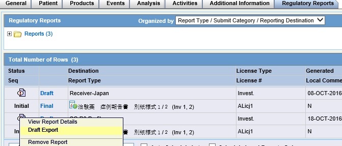

A context menu option Draft Export is added to export the report in RTF format in Draft mode.
This context menu option appears to the J user when J License is enabled, and PMDA Paper Report (1-2, 3-4, 5-6) is scheduled against the agency configured with PMDA E2B (R3) profile. Besides, the Draft link must be enabled for the respective report.
When the PMDA E2B (R3) Paper report is generated using this context menu option, the Draft water mark is embedded similar to when you generate a Draft report by using the Draft link. The data that is printed in the RTF format appears as exactly when you use Draft link for the PDF format.
The output of the Draft export from this option adheres to Blinded/Not-blinded report requirement based on the user permission.

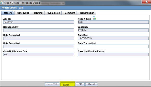

The report viewed from anywhere across the application provides the option to export the PMDA E2B Paper Report (1-2, 3-4, 5-6) in RTF format by using the Export button.
This Export button is disabled by default, and enabled only for the reports with status as Generated, Approved or Submitted.
This Export button appears to the J user when J License is enabled, and PMDA Paper Report (1-2, 3-4, 5-6) is scheduled against the agency configured with PMDA E2B (R3) profile.
The data printed in the RTF format appears as exactly when you use the Final link for the Case Form.
The output of the export from this button adheres to Blinded/Not-blinded report requirement based on the user permission.
