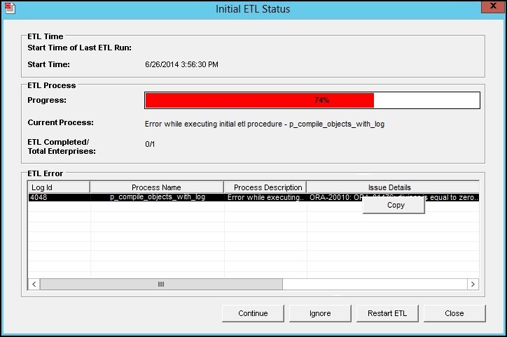

The initial ETL may fail due to an error. If an error occurs, the system stops processing the ETL and displays error message.
You may choose any of the following options for the failed Initial ETL process:
To continue the failed Initial ETL process, click Continue.
To ignore the failed Initial ETL process, click Ignore.
For ETL Data Exclusion, click Modify Attributes, if PRE_REQ_CHECK_FLAG switch is set to ABORT.
These modifications must be done before running the Initial ETL process.To continue the Initial ETL process from the failed ETL procedure:
Double-click on the ETL error.
The Error Data dialog box appears with details of the error.
Review the error information, and then click OK.
Right-click on the ETL Error, and click Copy to copy the error data.
Click Continue to continue the failed ETL process.
A message to confirm that you want to start the initial ETL from the stopped process appears.
Click OK.
The ETL process continues (if no errors are found).
To ignore a failed ETL process and continue with the next process in the ETL:
Click Ignore.
A message to confirm that you want to skip the failed process and continue executing the Initial ETL with the next process appears.
Click OK.
The Initial ETL begins from the next process and continues with the ETL process (if no errors are found).
