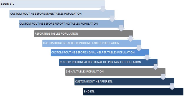

ETL Hooks are the custom procedures that are used to extend the existing functionality or behavior of the Argus Mart ETL.
ETL Hooks can be executed to perform actions while fetching data from the source database to the destination database, as required by the users.
The data fetched from Argus Safety database can be modified before or after uploading the data into the Argus Mart database. You can populate customized (non-standard/user-defined) columns to the standard RM and SM tables. Besides, you can also populate customized table(s).
For more information on populating customized columns or tables, refer to Section 5, "Customize Tables".
ETL Hooks perform these actions at different stages of both initial and incremental ETL.

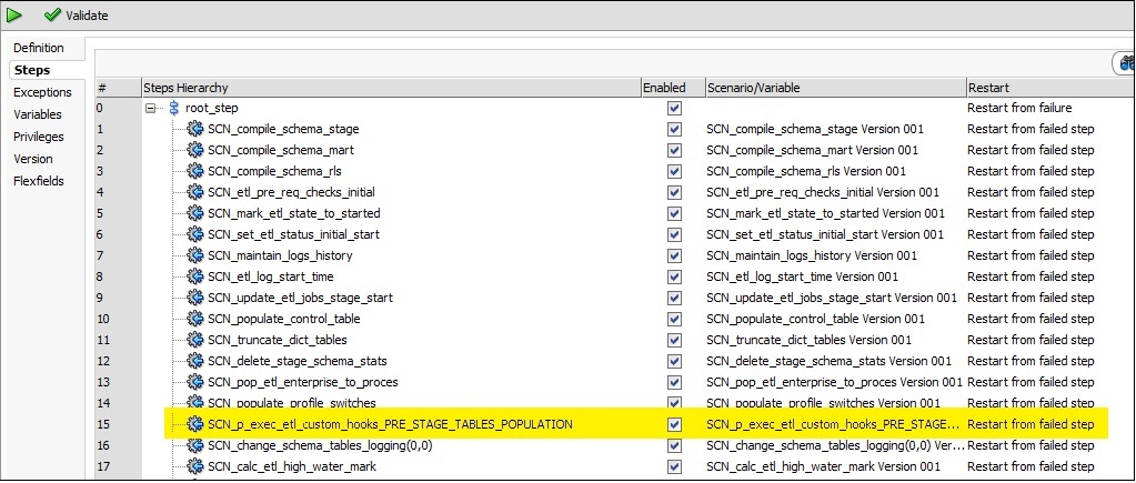

The ODI Load Plan lists all the ETL scenarios, as shown below:
Argus Mart comprises the following ETL Hooks that can be executed at different stages:
CUSTOM ROUTINE BEFORE STAGE TABLES POPULATION—Execute before populating the Staging tables.
CUSTOM ROUTINE BEFORE REPORTING TABLES POPULATION—Execute before populating the Reporting tables (or RM tables).
CUSTOM ROUTINE AFTER REPORTING TABLES POPULATION—Execute after populating the Reporting tables (or RM tables).
CUSTOM ROUTINE BEFORE SIGNAL HELPER TABLES POPULATION—Execute before populating the Signal Helper tables.
CUSTOM ROUTINE AFTER SIGNAL HELPER TABLES POPULATION—Execute after populating the Signal Helper tables.
CUSTOM ROUTINE AFTER ETL—Execute after running the initial or incremental ETL (post-ETL commit).
ETL hooks CUSTOM ROUTINE BEFORE SIGNAL HELPER TABLES POPULATION and CUSTOM ROUTINE AFTER SIGNAL HELPER TABLES POPULATION are executed only when any case revision is being processed for SM tables in the current ETL run.ETL Hooks help in customizing the existing ETL to suit your requirements through Argus Safety user interface.

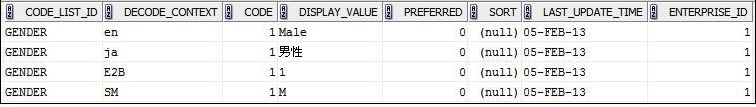

The following is an example to configure a code list display value in a new language for an already existing code in Argus Safety:
Example 1 Configure Flexible Data Re-categorization
For a code list GENDER, data in the table CODE_LIST_DETAIL_DISCRETE for code 1 is available in the following four decode contexts (languages):

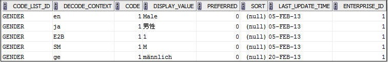

To configure the same code 1 in the code list GENDER for a new language such as GERMAN (decode context ge), populate the table CODE_LIST_DETAIL_DISCRETE with required values in the GERMAN language.
INSERT INTO CODE_LIST_DETAIL_DISCRETE (CODE_LIST_ID, DECODE_CONTEXT, CODE, DISPLAY_VALUE, PREFERRED, SORT, LAST_UPDATE_TIME, ENTERPRISE_ID) VALUES ( 'GENDER', 'ge', 1, 'männlich', 0, null, sysdate, 1);

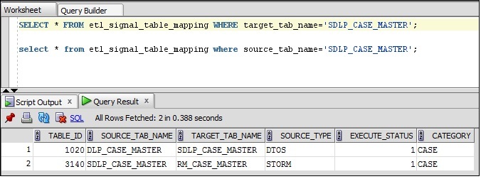

Example 2 Populate a new column in the RM table
Follow the steps given below to populate a new column in the table RM_CASE_MASTER:
Check the mapping between RM_CASE_MASTER, and the source table (SDLP_CASE_MASTER) to fetch columns from the staging table into the RM table. In this case, the source type is STORM.
Check the source table for target table (SDLP_CASE_MASTER), where columns are fetched from Argus Safety into the staging table. In this case, the source type can be ATOS/DTOS.
Once the mapping of the tables has been identified, fetch these column(s) from Argus Safety/DLP into Argus Mart, as required.

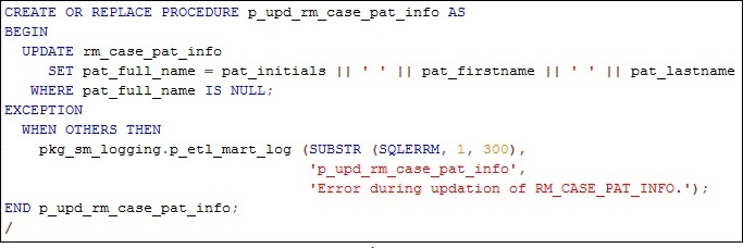

Example 3 Create a custom procedure
Creating a procedure called P_UPD_RM_CASE_PAT_INFO, to populate a new column called PAT_FULL_NAME in the table RM_CASE_PAT_INFO. The value of this column is calculated, and populated from the existing columns of RM_CASE_PAT_INFO. Here, we concatenate three columns PAT_INITIALS, PAT_FIRSTNAME, and PAT_LASTNAME to populate this value as PAT_FULL_NAME.
Create a procedure called P_UPD_RM_CASE_PAT_INFO.
In the table RM_CASE_PAT_INFO, populate a new column called PAT_FULL_NAME.
Concatenate three columns PAT_INITIALS, PAT_FIRSTNAME, and PAT_LASTNAME to populate this value as PAT_FULL_NAME.
Once this procedure is created, call this procedure using ETL Hook PRE_REPORTING_TABLES_POPULATION.
The ETL Hook will populate this new column PAT_FULL_NAME in SDLP_CASE_PAT_INFO.

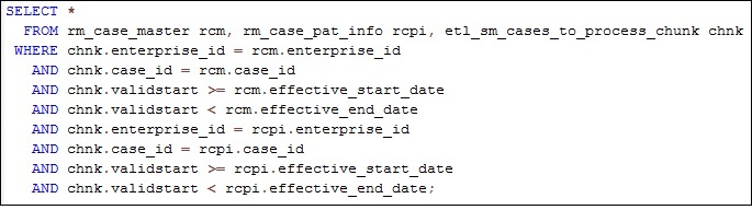

When using ETL Hooks to populate data into SM tables, it is recommended to use RM tables as the source, with join(s) to the chunk table ETL_SM_CASES_TO_PROCESS_CHUNK.
Do not use RM Views such as V_ETL_CASE_MASTER, because each view is joined individually to the chunk table. This can lead to sluggish performance of the application if ETL Hook extracts data from the multiple views.
Example 4 Populate data into SM tables using the chunk table
In the example given below, two RM tables RM_CASE_MASTER and RM_CASE_PAT_INFO have been joined with the chunk table ETL_SM_CASES_TO_PROCESS_CHUNK to fetch data into the SM table with the help of the ETL Hooks.

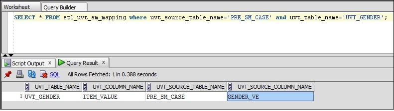

Example 5 Populate a custom UVT table
Follow the steps given below to populate a column in the table UVT_GENDER:
Check the mapping between the source table PRE_SM_CASE and the target table UVT_GENDER from the table ETL_UVT_SM_MAPPING.
After mapping the tables and their related columns, you can populate the column(s), as required.
