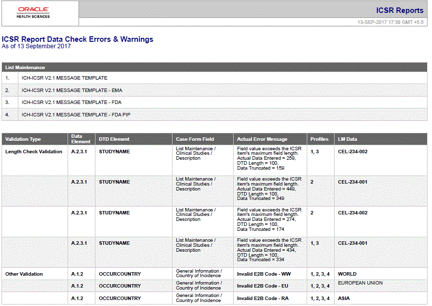

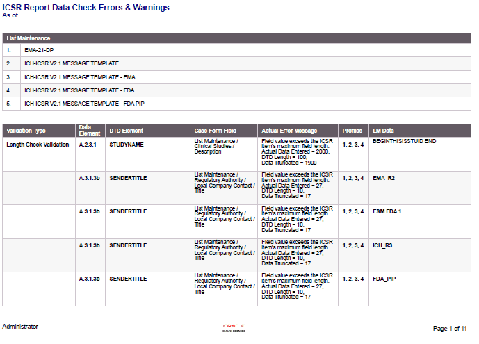

The report contains the following as illustrated:
This section enables you to view the ICSR Length Check Report.
Use the following procedure to view the ICSR length report.
Select Tools >ICSR Length Check.
The ICSR Length Check PDF report opens in a separate window.
Tip:
This report compares the lengths of the code list elements with the maximum ICSR length allowed for each of the DTD profiles (ICH, FDA, EMA).It also displays the elements where the length of the code-list element is greater than the allowed ICSR length.
