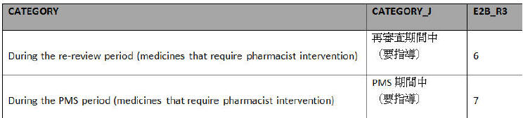

License Category
Data for the License category codelist has been synchronized as per the PMDA E2B (R3) regulation. The E2B (R2) codes have been mapped to the appropriate values with the following exceptions:
Update the appropriate E2B (R2) codes for the newly added items to the codelist.

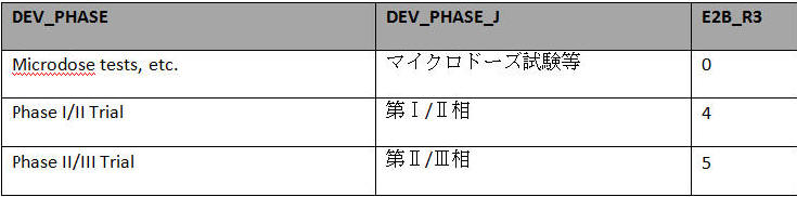

Study Development Phase (Development Phase)
Data for Study Development Phase codelist has been synchronized as per the PMDA E2B (R3) regulation. The E2B (R2) codes have been mapped to the appropriate values with the following exceptions:

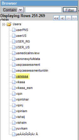

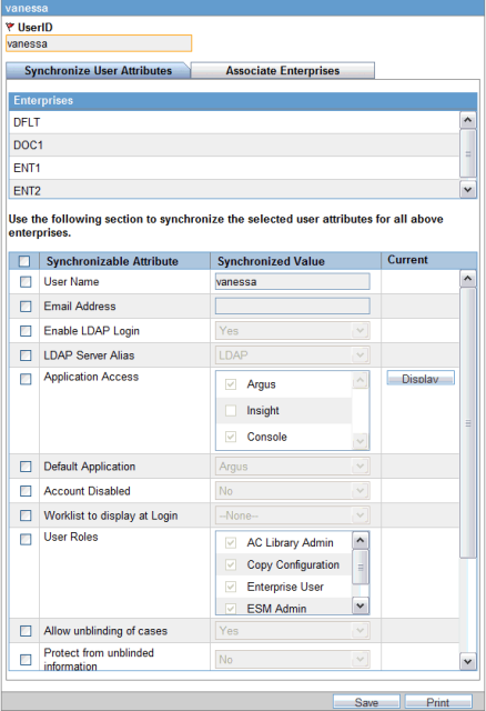

The purpose of the Synchronizable User Attributes section is to allow you to apply updates to user attributes displayed in this section, and keep them in sync across all enterprises.
The users that are listed to be administered in this screen are restricted by the following rules:
Admin users, System users and users for which the Service User is checked in Console are not listed.
Only the users from the enterprises for which you have access to the Console User management screen, i.e. you should have access to all of the following in those enterprises:
Console User Management screen ' Application Access field ' Console checkbox is checked.
Console Group Management screen ' Menus section ' Console, Access Management and User radio options are set to enabled at least for one user group in the respective enterprise partition.
Is not marked as "Account Disabled".
When you select the Synchronize User Attributes tab, the left hand pane displays a list of enterprises to which the user being administered belongs to. The right hand pane displays a list of Synchronizable user attributes in a grid.
The value of the Synchronizable fields can be modified for a specific enterprise so that these attributes can be different for that enterprise as compared other enterprises.
If User Name and Email address fields are updated in Argus Safety Console for a user which belongs to multiple enterprises, an error displays.If you make changes to the data on one of these tabs and attempts to move away from this current tab without saving the changes, then the warning message "You have made changes to the existing item, if you press OK, changes will be lost." displays. Click OK to ignore changes. Click Cancel to stay on the current tab.
