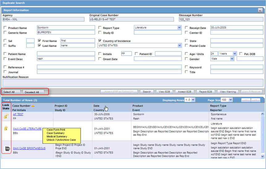

Verify that the relevant case has been locked and the required report has been scheduled.
Select Case Actions, and then click Open to view the Case Open form.
Click Search to view cases matching the search criteria.
When the system displays the search results, click the Lock State icon and select Case Details.
When the system opens the Argus Safety Case Details dialog box, open the Scheduled Regulatory Reports folder and select the relevant regulatory report.

The Duplicate Search dialog box for an ICSR report enables you to search for possible duplicate cases in the Argus Safety system. You can select different combinations of search criteria. When more than one criterion is selected, only cases that satisfy all criteria are listed. By default, the fields that are present in the ICSR Report are checked for the Duplicate Search.
| Field | Description |
| Onset Date | The date from when the first reaction or adverse event occurred. |
| Reference # | National Regulatory Authority's Report Number, used as a Reference Number. |
| ICSR Viewer | Enables you to view the E2B report. |
| View Differences | Allows viewing differences between the current XML to be imported (a message that is not yet imported into the database), the current case data in the database, and if a case has been imported before, the last imported case.
Note: This button is available only for follow-up and nullification reports. |
| Action | Enables you to view the Case Summary dialog box. |
| Reporter | Displays the reporter involved with the case matching the search criteria.
This field appears in the search results. |
| Reference ID | Searches on the following fields in the Argus case:
| Keyword | By default, the first value from the incoming affiliate event appears. |
The Duplicate Search in Argus Central Incoming review enables you to search on Reference ID and Keyword field in Argus cases.
You can right-click the Case Number for a listed case and use the following options:
| Right-click Option | Description |
| Case Form Print | This option is displayed for only those users who belong to the group with access to Argus Console > Access Management > Groups > Menu > File > Print.
This option allows you to print the case form report. |
| Case Summary | This option is displayed for only those users who belong to the group with access to Argus Console > Access Management > Groups > Menu > File > Open Case Summary.
This option allows you to open the summary report of the case. |
| Medical Summary | This option is displayed for only those users who belong to the group with access to Argus Console > Access Management > Groups > Menu > File > Print.
It displays the medical summary of the case. |

Click the Lock State header row to sort on the following category of cases. A pop-up window appears, with the following sorting options:
Lock State
SUSAR
Exp/Per
Click the required option to sort cases based on the selected case categorization.
| Icon... | Identifies... |
| A case marked for a Periodic ICSR submission. | |
| A locked case. | |
| An unlocked case | |
| A SUSAR (Suspected Unexpected Serious Adverse Reaction) case. |
