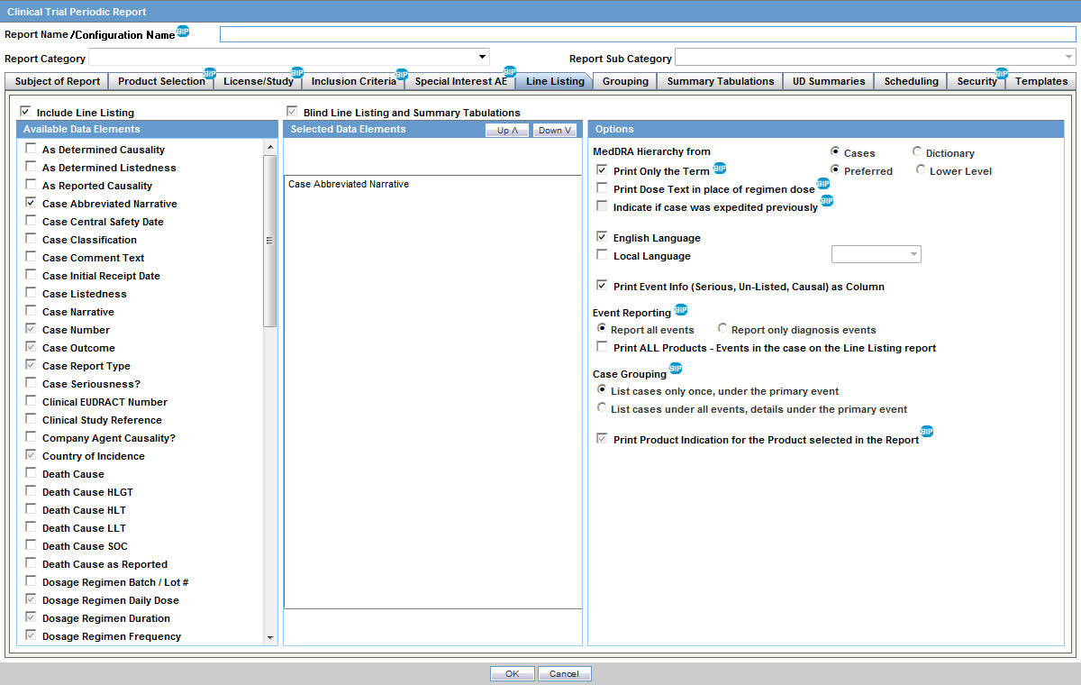

7.2.2 Line Listing Tab
The system uses the following configurations as report parameters in BIP reports:
  • Print Only the Term (PT, LLT): Prints event verbatim along with PT or LLT if this configuration is unchecked.
  • Prints Dose Text in place of regimen dose.
  • Indicates if the case was expedited previously.
  • Event Reporting.
  • Case Grouping.
  • Prints Product Indication for the product selected in the report.

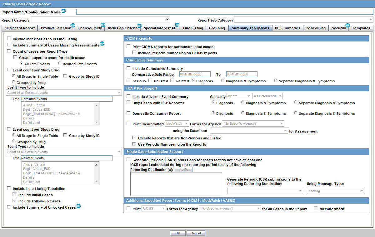

7.2.3 Summary Tabulation Tab
  • Include Summary of cases Missing Assessments
  • Include Summary of Unlocked Cases

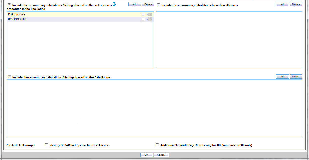

7.2.4 UD Summaries Tab
The system uses only Include these summary tabulations or listings based on the set of cases presented in the line listing.
The system does not generate memorized reports for selected configurations are not generated along with the aggregate report. Instead, it only uses advanced condition query criteria used in these configurations to generate the case series for these ad hoc line listing sections. Figure 7-4 is an example of case data line listing query criteria used for ad hoc line listings.
Figure 7-4 Ad Hoc Line Listing Query Criteria
Description of Figure 7-4 follows
Description of ''Figure 7-4 Ad Hoc Line Listing Query Criteria''

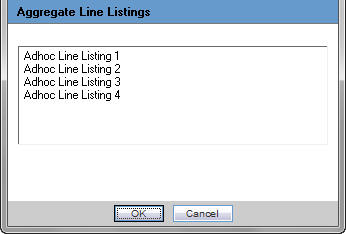

When you select a checkbox in UD Summaries, the available ad hoc line listing sections appear in the Aggregate Line Listings dialog box.
Figure 7-5 Aggregate Line Listings
Description of Figure 7-5 follows
Description of ''Figure 7-5 Aggregate Line Listings''
You can associate multiple ad hoc line listing sections with one memorized line listing configuration. Each ad hoc line listing section can be attached to only one memorized line listing configuration. All ad hoc line listing sections already attached to another memorized line listing configuration are not available for selection again.
The system marks memorized line listing configurations having associated ad hoc line listings with an additional asterisk. The system displays all associated ad hoc line listings as a tooltip when you hover over the selected memorized line listing configuration.

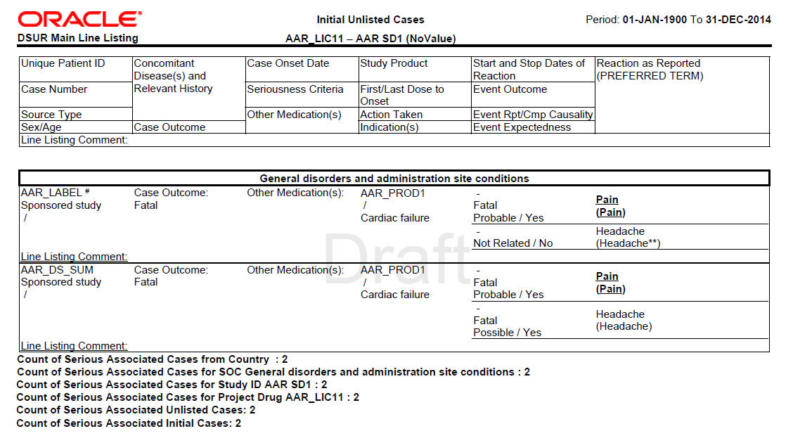

7.3.2 Main Line Listing
Table 7-2 Main Line Listing Fields
Field Name Description
Unique Patient ID
Unique patient identifier based on the format selected by the user while running the report. This value depends upon the UNIQUE_PATIENT_ID_FORMAT parameter.
Case Number
  • Case Number is printed.
  • If the BIP report parameter Indicate if case was expedited previously is Y, the symbol specified in the BIP parameter Symbol for expedited cases appears with the case number as a superscript.
  • A footnote appears at the end of the page as follows: <symbol>: Expedited Case.
Refer to the temp table sheet for the logic of Expedited case. If the BIP report parameter Indicate if case was expedited previously is Y, the footnote for Expedited Cases appears even though there may not be any cases marked as Expedited.
Report Type
Reporter type is displayed from the flex bucketing code list field REPTYEPGRP for the report type entered in the case.
Sex and Age
PATIENTSEXTEXT is populated using global language decode of PATIENTSEXCODE field.
If Patient Age is missing, Patient age group appears. If Patient Age or Age group is not entered, text entered for the BIP parameter Default for NULL Values appears.
Concomitant Disease and Relevant History
Concatenation of the patient relevant medical history in a table format.
Case Outcome
Case level outcome.
Case Onset Date
Case level event onset date.
Seriousness Criteria
Seriousness Criteria for primary events appears.
Other Medication
List of all suspect drugs and concomitant drugs in the case except the drug for which the report is being run.
Study Product
The logic provided in summary tabulations is used to populate this field.
First or Last Dose to Onset
Duration from the first or last dose until the first onset of the adverse event. It is calculated at the case level using all doses for all drugs in the drug list and the case level onset date.
Action Taken
Action taken appears with the respective company suspect drug.
If action taken is not specified in the case, then <> appears.
Indication
Concatenation of reported indications for a product in the case. The report displays a list of indications for products that are configured for current periodic run.
Start and Stop Dates of Reaction
Date of Onset (only from Primary Serious event).
Time of Onset (only from Primary Serious event).
Event Outcome
Event outcome for each event present in the case.
Event Reported or Determined Causality
Causality as per reporter and company is printed with the corresponding Product and Events in the format: <Causality as per reporter> or <Causality as per company>.
Event Listedness
Listedness information for the event appears.
Listedness appears based on the BIP Report parameter Labeling Algorithm if the report is executed from BIP.
If this report is executed from Argus Safety, the following report parameters are considered:
· Use Assessment in Cases.
· Re-assess cases against datasheet in effect at beginning.
· Re-assess cases against datasheet in effect at end.
Reaction as Reported
(PREFERRED TERM)
Reaction as Reported (PT) with diagnosis or signs and symptoms, and company added term behavior.
Dose String
Default format is DoFoRt - Print Dose, Formulation, and Route of administration.
Dates of Treatment
Treatment Duration
Line listing Comments
In DSUR line listings:
• The system displays all Serious and Unexpected Adverse Reactions (SUSAR) events with an asterisk *. The SUSAR event term (PT or LLT) appears with an asterisk to the right of the term. For example, SEPTICEMIA*.
• The system displays all special interest events with a superscript †. For example, OEDEMA†. You configure the list of special interest events for a report using the Argus Safety CTPR configuration screen.
• The system displays primary events in bold and underlines them.

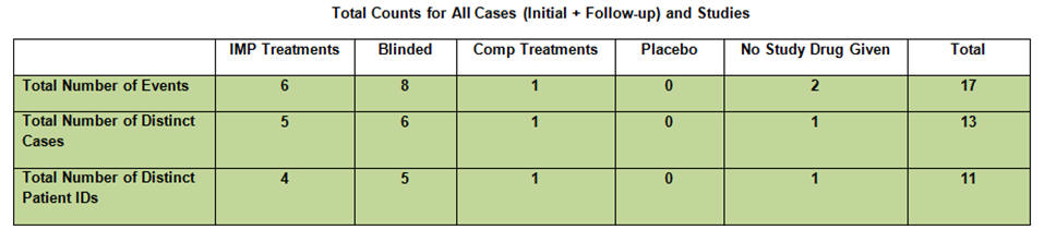

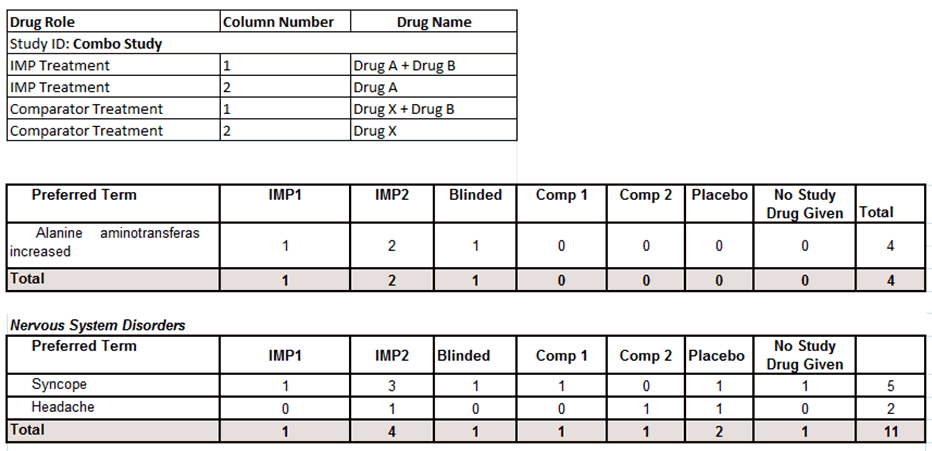

7.4 Summary Tabulations of Serious Adverse Events
This section in the DSUR provides the main and cumulative summary tabulation of SAEs reported in the sponsor's clinical trials from the DIBD to the data lock point of the current DSUR. The report displays only serious events in this tabulation. You cannot display any non-serious events of special interest in this section as filtering is based on the seriousness of an event.
The tabulation is organized by Study and SOC for the investigational drug and for the comparator arm (active comparators, placebo, and treatment unknown due to blinding) used in the program.
The Development Safety Update Report provides the following tabulations:
  • DSUR Main Summary Tabulation of Serious Adverse Events: This tabulation contains all serious cases from the main case series (interval period). For each case, the system prints a summary tabulation count SOC in the internationally agreed order, followed by PTs in rows.
  • DSUR Fatal Cases Summary Tabulation: This tabulation is similar to the Main Summary tabulation, except that the report only prints cases where event seriousness criterion is death.
  • DSUR Cumulative Summary Tabulation of Serious Adverse Events or DSUR Cumulative Summary Tabulation of Serious Adverse Reactions: This tabulation contains all serious cases from the cumulative case series. For each case in the cumulative case series, the system prints summary tabulation counts broken down by SOC in the internationally agreed order, followed by PTs in rows. This tabulation prints either the serious adverse events or serious adverse reactions based on the value of the report parameter Print Serious Adverse Events or Reactions.
    Based on the value of the above parameter, the heading of the cumulative tabulation indicates whether it is for a serious adverse reaction or a serious adverse event.

7.4.3 DSUR Tabulation Format
The report prints the count for medicinal products in the first column, followed by Blinded, Active Comparator, Placebo, and No Study Drug Given.
If the event count is 0 for Medicinal Product, Blinded, Active Comparator and Placebo columns for a given SOC, the system does not print that SOC in the report.
The DSUR tabulation prints the short name for investigation drugs and comparator drugs. For investigational drugs, the system prints SD1, SD2, SD3, and so on, based on the number of study drugs that are part of the investigational product column count. For comparator drugs, the system prints the short name as Comp1, Comp2, and so on, based on the number of comparator drugs that are part of the Active Comparator column count.
The system provides a table of information for all tabulations for detailing the study drugs and comparator drugs names used in the tabulation corresponding to each short name. This table has the following format and contains the following fields:
Table 7-5 Drug Roles and their Descriptions
Drug Role Description
Study ID
Name of the study ID used in the tabulation grouping.
Study Drugs
The system prints the column number of the study drugs used in the tabulation and its actual name in the Drug Name Column.
Comparators
The system prints the column number of each comparator drug used in the tabulation and its actual name in the Drug Name Column.
The system displays all SUSAR events with an asterisk *. The SUSAR event term (PT or LLT) appears with an asterisk to the right of the term. For example, SEPTICEMIA*.
The system displays all special interest events with a superscript †. For example, OEDEMA†. You can configure the list of special interest events for a report by using the Argus Safety CTPR configuration screen.
Drugs configured as Placebo or No Study Drug Given are not part of the summary table.
Data Example
In the example above (Figure 7-8), the product types configured for this study are:
Drug A – IMP
Drug B – Additional Study Drug
Drug X – Comparator
Drugs configured as Placebo or No Study Drug Given are not part of summary table.

7.4.5 Summary Counts
The Total Counts for All Cases (Initial + Follow-up) and Studies summary count table displays various counts for all cases (Initial + Follow-up) from all studies. It appears once for each tabulation, that is, once for the Main Summary tabulation, once for Fatal Summary Tabulation, and so on.
This count table has fixed columns that print the total of all event terms, cases and patients for IMP treatments, Comparator treatments, Blinded, Placebo and No Study Drug Given columns from the DSUR tabulation.
The system uses the following labels for these counts:
  • Total Number of Events: Displays the sum of all events terms corresponding to IMP Treatment, Comparator Treatment, Blinded, Placebo and No Study Drug Given for each column. These totals are based on Main, Fatal, and Cumulative tabulations.
  • Total Number of Distinct Cases: Displays the count of distinct cases for all summary columns.
  • Total Number of Distinct Patient IDs: Displays the count of distinct patient IDs configured for cases that are part of the respective tabulation. Any case where patient ID is not configured is not counted in this column, that is, only those patients are counted where patient ID is configured. If the same patient ID is configured in multiple cases or the same patient is part of multiple cases from this tabulation, that patient ID is counted only once.
