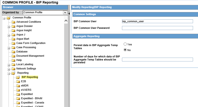

2.2 Configuring the Argus BIP Integration
Perform the following steps to store your BIP common user and BIP common user password:
  1. Under the System Configuration tab, click System Management (Common Profile Switches).
  2. Under the Reporting tree entry, click BIP Reporting.
    Figure 2-2 BIP Reporting Screen
    Description of Figure 2-2 follows
    Description of ''Figure 2-2 BIP Reporting Screen''
  3. Enter the respective values in the following fields:
    1. BIP Common User
    2. BIP Common User Password
    These configuration entries are available at enterprise level in a multi-tenant environment.
    You can view the BI Aggregate Reporting tree entry only when you enable the BIP Aggregate Reporting module.

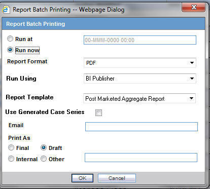

2.3.1 Report Execution Flow from Argus Safety
To execute a report using the Argus Safety user interface:
  1. Select a report configuration from Argus Safety Aggregate Reports library.
  2. Click Print and select the required parameter from the batch print screen.

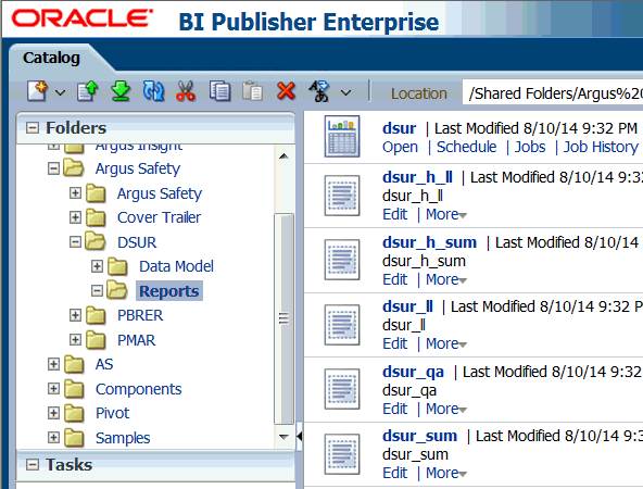

2.3.2 Report Execution Flow from BI Publisher
To execute a report using the BI Publisher:
  1. Select a report template.
  2. Select different parameters available in the report or select a report configuration.

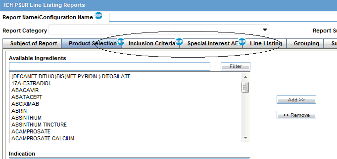

The ICH PSUR Configuration screen lets you distinguish the configuration options used as parameters in the BIP report only if you have enabled the BI Aggregate Reporting module.
The system marks all configuration parameters passed to BIP reports for data filtering and report formatting with a BIP logo.
The system uses all inclusion criteria available on the ICH configuration screen for query and case series generation in BIP reports.

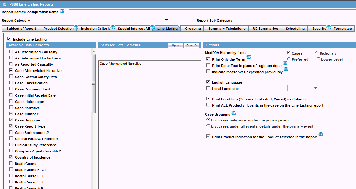

2.4.4 Line Listing Tab
The system uses the following Line Listing tab parameters:
  • Print Only the Term: Prints event verbatim along with PT or LLT if you uncheck this configuration.
  • Print Dose Text in place of regimen dose
  • Indicate if case was expedited previously
  • Case Grouping
  • Print Product Indication for the Product selected in the Report.

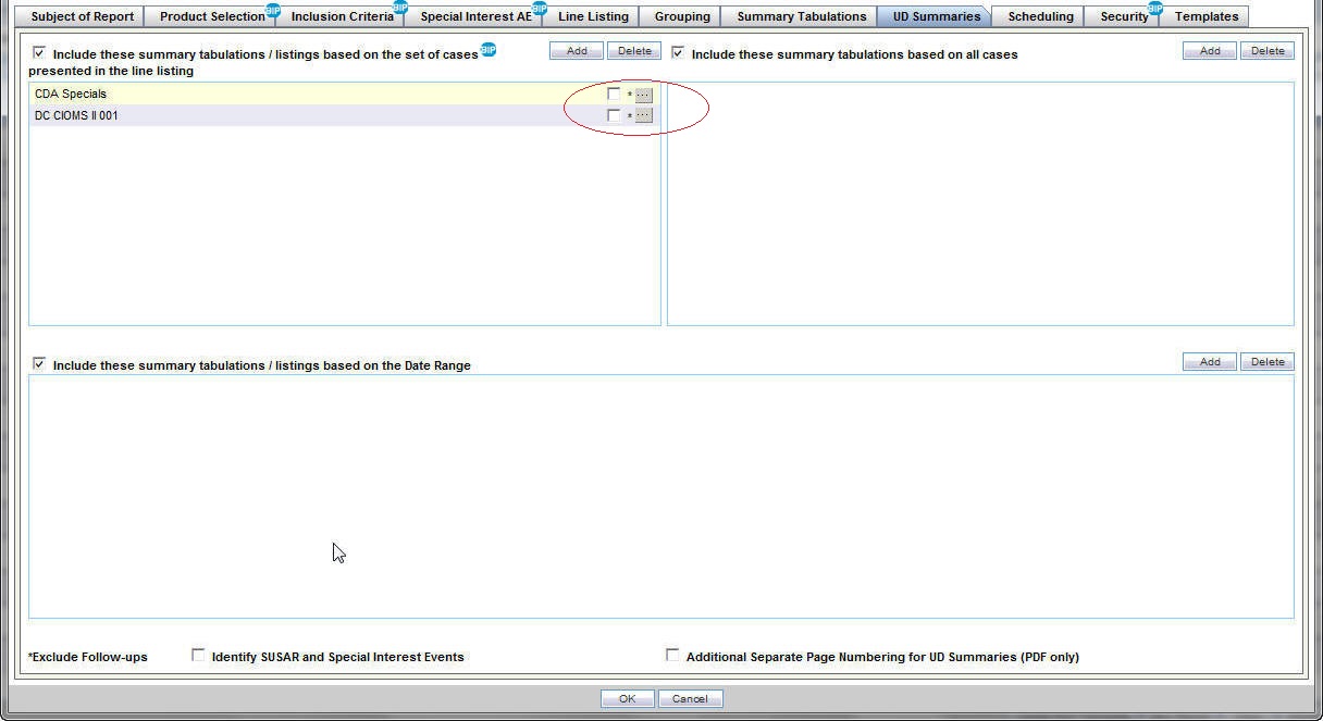

2.4.6 UD Summaries Tab
The system only uses Include these summary tabulations/listings based on the set of cases presented in the line listing from this tab.
This configuration is modified, and you have an option to attach selected line listings (memorized line listings) with different ad hoc line listing sections present in the BIP report. A button is provided with each memorized line listing to support this.
The system does not generate memorized reports for selected configurations along with the aggregate report. It only uses the advanced condition query criteria for generating the case series for these ad hoc line listing sections. Figure 2-7 displays an example of case data line listing query criteria used for ad hoc line listings.

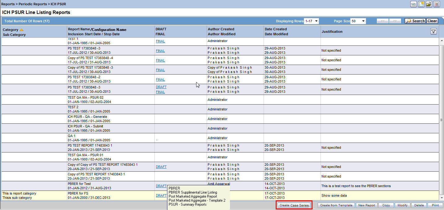

2.5.1 Generating a Case Series
The Create Case Series button on the ICH PSUR and CTPR reports library page is enabled when you select any saved report configuration only if you have enabled the BIP Aggregate Reporting module.
When you click this button, the system generates the following case series by using query criteria available in the selected report configuration:

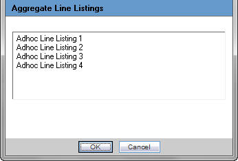

  • Ad hoc Case Series: You must ensure that the ad hoc line listings are linked to their respective report configuration. Ad hoc Case Series 1 is used in ad hoc Line Listing 1, ad hoc Case Series 2 in ad hoc Line Listing 2, and so on. You can edit these case series in the advanced condition library.

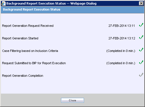

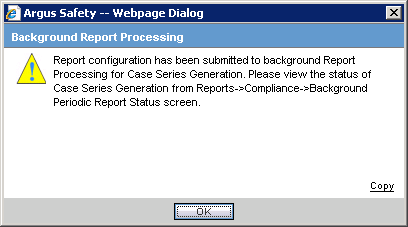

The following message appears after the request for case series generation is pushed to the Argus Safety application when you click Create Case Series.
Figure 2-10 Message Displayed
Description of Figure 2-10 follows
Description of ''Figure 2-10 Message Displayed''

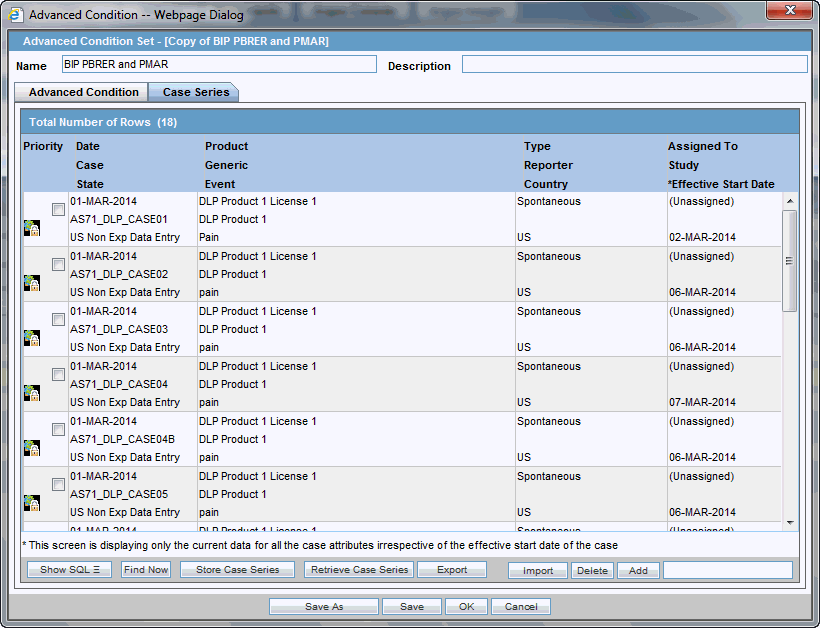

All case series generated using periodic reports configuration are available in the Advanced Condition Library. You can modify these case series by providing a proper justification before the case series are used for report generation.
You can modify a case in the Advanced Condition Library.

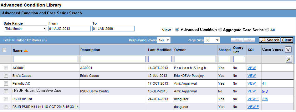

2.5.3 Advanced Condition Library
You can view all case series that have been generated in the Advanced Condition Library.
The Advanced Conditions and Case Series Search title bar displays the search options added on this screen.
Table 2-1 Fields and Descriptions
Field Description
Date Range
An option for searching saved advanced conditions and case series. This date range filters cases based on the last modified date of the Advanced Conditions and Aggregate case series. The system uses the last one year date range by default when the advance condition page is loaded for the first time. The Date Range drop-down list contains the standard date ranges used in other parts of the Argus Safety application.
Advanced Condition Radio button
Clicking this button displays only advanced conditions.
Aggregate Case Series Radio button
Clicking this button displays only aggregate case series.
All Radio button
Clicking this button displays all advanced conditions and aggregate case series.
The Advanced Condition option is selected by default during initial page load.
Figure 2-11 Advanced Condition Library Screen
Description of Figure 2-11 follows
Description of ''Figure 2-11 Advanced Condition Library Screen''
When you click Search, the system filters out the list of Advanced Conditions or Aggregate case series based on the date range selected.
When you click Case Series, the Advanced condition dialog box with available cases is displayed.
The Delete button on the Advanced Condition Library page is disabled when you select any Aggregate case series.
2.5.4 Deleting a Case Series
You can delete multiple cases to update the case series. A checkbox corresponding to each case facilitates the deletion of multiple cases.
Figure 2-12 Advanced Condition Set Screen
Description of Figure 2-12 follows
Description of ''Figure 2-12 Advanced Condition Set Screen''

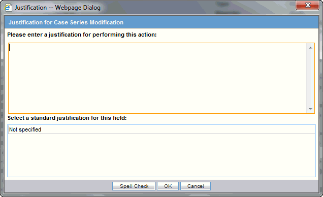

While you delete or add cases to the case series (single or multiple), the system displays a standard justification dialog requesting the reason for case series modification.
Figure 2-13 Justification Dialog Box
Description of Figure 2-13 follows
Description of ''Figure 2-13 Justification Dialog Box''
The justification text for case series modification follows the list of case numbers displayed after the report cover page. The system displays all actions performed on a case series separately in the order they were performed. For example, actions performed on a case series are displayed in the following order:
Action Performed: Case Addition
Action Performed By: <User Name>
Justification Text: <These cases were not part of last report submission>
Case Numbers: US2010ABC, US2010XYZ
Date Modified: 12-Oct-2013 12:40:33
Action Performed: Case Deletion
Action Performed By: <User Name> Justification Text: <These cases are already reported to regulatory authorities>
Case Numbers: US2009ABC, US2009XYZ
The Effective Start Date column displays effective start dates corresponding to all cases available in the case series. Values in this column are available only when periodic reports configuration is set to run on the DLP schema instead of current data. The column populates aggregate temporary tables corresponding to a case series during BI Publisher report execution.
Date Modified: 13-Oct-2013 16:22:00
This screen displays only the current data for all available columns, irrespective of whether the case series is being generated on DLP. The system displays an asterisk against the Effective Start Date column and also displays a note as a legend.
This screen displays only the current data for all the case attributes irrespective of the effective start date of the case.
When a case series is being used, you cannot modify it as the system locks the case series. The system disables the Delete and Add buttons on the advanced conditions case series dialog during the time it is used. It also disables the Create Case Series button on the Periodic Reports page if the case series corresponding to that report configuration is being used.
When a report is being executed, the system disables the Create Case Series for the corresponding report configuration.
When you click the View link for an existing case series for selected report configuration, a warning message appears indicating that the case series cannot be modified as it is currently under modification or is being used for a report.

You can execute BIP periodic reports as a one-step or two-step process. The Report Batch Print screen provides this option.
The screen provides the following options if you have enabled the BIP Aggregate Reporting module:
  • Run Using: This drop-down list lets you choose between the BI Publisher and Argus Native options.
  • When you select BI Publisher, the system provides the following additional options for running the report:
    Table 2-2 Options for Running the Report using BI Publisher
    Report Template
    This drop-down list is populated with all available BIP report templates that can reuse the configuration for the PSUR or other periodic reports.
    Use Generated Case Series
    This checkbox is enabled only if a case series has been generated using the selected report configuration.
    It is selected by default if a case series already exists for the selected report configuration.
    If the Use Generated Case Series checkbox is checked, the system generates the report on already existing case series.
    The Use Generated Case Series checkbox is checked when a final report that was generated for the selected report configuration is pending submission.
    The Print operation works in same way for BIP reports as it works for Argus Native reports.
    After a case series is generated for an associated report configuration, any existing case series associated with that report configuration is replaced with that case series. The system keeps only one case series for a report configuration at a time.
    Figure 2-14 Report Batch Printing
    Description of Figure 2-14 follows
    Description of ''Figure 2-14 Report Batch Printing''
    All reports executed through Argus Safety UI are tracked using the Argus Safety application. The status for all BIP reports is available in the Background Periodic Status screen of Argus Safety.
When you select Argus Native from the Run Using drop-down list, the system hides the Report Template option. Any case series generated as part of Argus Native report execution is not saved in the system by default.
If you select Run Now, the system immediately generates a report for the selected configuration. If you specify a date and time in the Run At field, Argus Safety schedules it for the provided date and time.
For every BIP report generated from Argus Safety or the BIP scheduler interface, the system adds an entry into the Argus database.
2.7 Running Reports through BIP Console
You can execute all BI publisher reports through the BI Publisher console.
  1. When you log into the BI Publisher, click Catalog.
  2. Select the tree entry for a report, and select Reports.
    Figure 2-15 Reports Tree Entry Screen
    Description of Figure 2-15 follows
    Description of ''Figure 2-15 Reports Tree Entry Screen''
    The system displays the available reports on the screen.
  3. Click the Open link for the report you selected.

2.11 Viewing Aggregate Reports from Argus Safety
After Draft or Final periodic reports are generated, you can view the generated reports through the Periodic Reports Library screen.
This UI screen shows all reports generated on a report configuration, irrespective of whether the report was generated using Argus Safety UI or BI Publisher scheduler. All reports generated through the BI Publisher console are not available for viewing from Argus Safety.
When you click the Draft or Final link, a context menu appears with all available report templates that have been generated for a report configuration. When you click a report template, the system opens the selected report in the format that was used to generate the report.
For every report template corresponding to a report configuration, only the last generated draft or final report is available to you.
Figure 2-18 ICH PSUR Line Listing Reports
Description of Figure 2-18 follows
Description of ''Figure 2-18 ICH PSUR Line Listing Reports''

2.12 Background Periodic Report Status
You can view the status for all the BIP periodic reports run through Argus Safety or from BIP Scheduler in the Background Periodic Report Status screen.
The following are the possible status options for reports scheduled using BIP scheduler:
Table 2-3 Status Options for Reports Scheduled through BIP Scheduler
Status Description
Executing
When execution for a scheduled BIP report starts, its status is tracked as Executing.
Generated
After a report is generated, the output is stored in the Argus Safety database, and a corresponding entry is made available in Argus database with a report link, the status of the report is marked as Generated.
Error
If an error occurs during the scheduled report execution, the system marks the status of the report as Error.

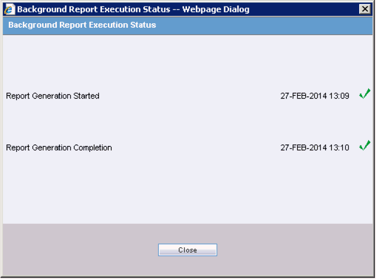

The system displays the status in the following format when you click the Generated link.
Figure 2-19 Background Case Series Execution Status
Description of Figure 2-19 follows
Description of ''Figure 2-19 Background Case Series Execution Status''
The following are the possible status options for reports executed using the Argus Safety user interface:

The following are possible status options for a report executed when a user when a user generates a case series by clicking Create Case Series:
Table 2-5 Status Options when User clicks Create Case Series
Status Description
Pending
When a Case Series is generated from Argus Safety, a corresponding entry is available in the background periodic screen showing the case series status as pending. The case Series remains in this status until it is picked by AG Service for execution.
Executing
When execution for a periodic configuration is started for case series creation, its status is tracked as Executing.
Generated
After a case series is generated, the status of background request is marked as Generated.
Error
If an error occurs during case series generation, the system marks the status of the background request as Error.
The system displays the status in the following format when you click on Generated link for case series.
