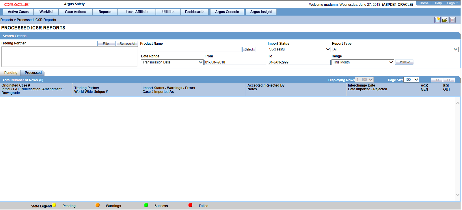

Incoming ICSR Reports can be viewed from the Incoming ICSR Report screen.

The Duplicate Search Dialog for E2B report allows you to search for possible duplicate cases in the Argus Safety system. You can select different combinations of search criteria. When more than one criterion is selected, only cases that satisfy all criteria are listed. By default, only the fields that are present in the E2B Report are checked for the Duplicate Search.
Use the following procedure to perform a duplicate search.
Select Reports -> ICSR Pending Report.
When the system opens the Incoming ICSR Reports Dialog, right-click a case to perform a duplicate search.
The system displays the search results at the bottom of the Dialog box.
The following table describes the fields present in the Duplicate Search Dialog.

The search output is displayed in the Total Number of Rows section. You can click the Action icon to view the Case Summary Dialog.The View Differences Report enables you to view differences between the following:

The Processed ICSR Reports screen contains a list all processed ICSR reports. Click the Processed ICSR Reports tab on the Incoming Reports screen to view the Processed ICSR Reports screen.
The Processed ICSR screen contains the following:
Search Criteria
The following table lists and describes the fields in the Total Number of Rows section on the Processed ICSR screen.
| Field | Description |
| Originated Case# | Displays the Originated Case Number of the case. |
| Initial/F-U/Nullification | Displays the Initial/F-U/Nullification status. |
| Trading Partner | The name of the trading partner. |
| World Wide Unique# | The World Wide Unique # for the case. |
| Import Status - Warnings/Errors | The import status of the case and any associated warnings/errors. |
| Case # Imported As | The Case Number used when importing the case. |
| Accepted / Rejected By | Identifies who accepted or rejected the case. |
| Notes | The case notes. |
| Interchange Date | The Interchange Date. |
| Date Imported/Rejected | The date the case was imported/rejected. |
| ACK Gen | Yellow indicates the case is still pending
Orange indicates the case is accepted with warnings / errors Red indicates the user or system rejected the case. Green indicates the case has been successfully imported. |
| EDI Out | Yellow indicates the system is waiting to send the report out of the EDI / XML or PHY out folders
Green indicates the report is already sent out of the EDI / XML or PHY out folders Red indicates that the EDI gateway failed to send the report out of the EDI / XML or PHY out folders. |
