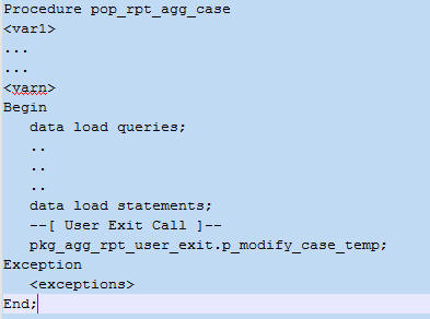

There is also a user exit for each RM table.
Figure 6-1 Extending with User Exits
Description of Figure 6-1 follows
Description of ''Figure 6-1 Extending with User Exits''

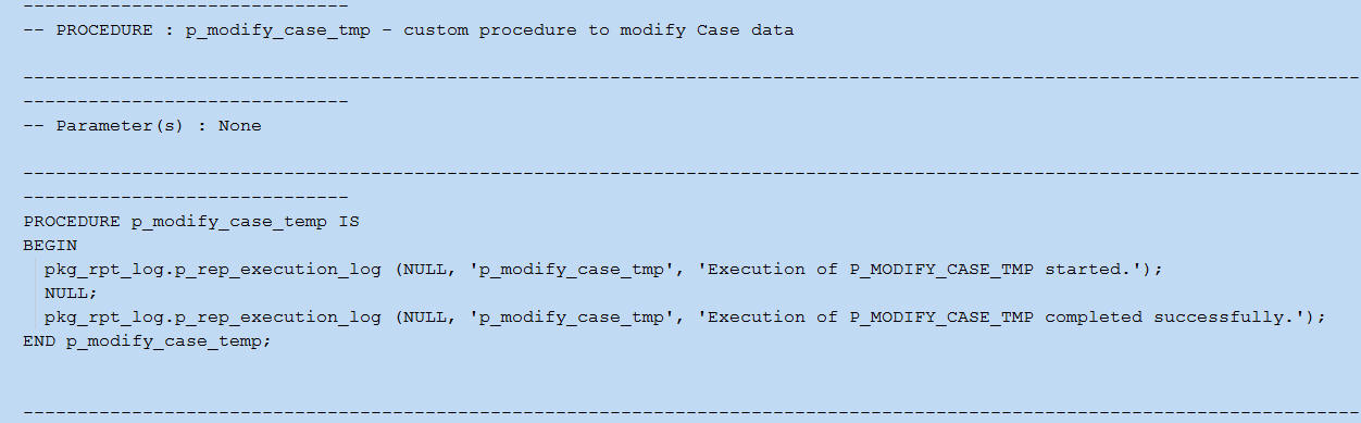

Figure 6-2 displays the structure of an out-of-the-box user exit.
Figure 6-2 Structure of an Out-of-the-box User Exit
Description of Figure 6-2 follows
Description of ''Figure 6-2 Structure of an Out-of-the-box User Exit''
An out-of-the-box user exit only has a null statement between the log handlers. You can add logic (as necessary) to insert, update, or delete rows from corresponding or related tables.
A sample extension requirement is shown below:
Requirement
Update the CUSTOMCASE01 column using truncated or formatted study name value based on a condition.
Solution
Modify the p_modify_case_temp user exit. Write the following update statement within the p_modify_case_temp procedure:
Update GTT_RPT_AGG_CASE
Set CUSTOMCASE01 = Uformat(studyname)
Where <condn>

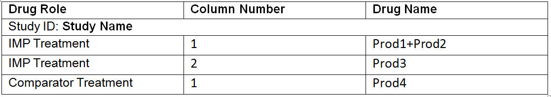

  3. G3_DRUGKEY is the third group which prints Study and Comparator drugs in a table format.
    Figure 6-3 Study and Comparator Drugs Format
    Description of Figure 6-3 follows
    Description of ''Figure 6-3 Study and Comparator Drugs Format''
    In the summary tabulation, IMP 1 is printed under IMP Treatment1 and IMP 2 is printed under IMP Treatment2. The titles are configurable (flexible code list: BIP_PROD_CATEGORY).

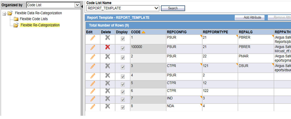

  1. Go to Argus Safety UI -> Argus Console -> Code Lists -> Flexible Data Re-Categorization.
  2. Select the code list ID as REPORT TEMPLATE and click Search.
    Description of codelist.jpg follows
    Description of the illustration ''codelist.jpg''
  3. Enter a new row by clicking Add New and entering the necessary details.
    Description of addrow.jpg follows
    Description of the illustration ''addrow.jpg''
    The REPPATH value must be entered correctly. For the REPTEMPLATE value, enter whatever must appear in the UI (Report Configuration, such as CUST).

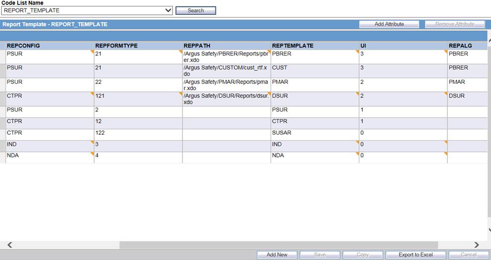

  4. Once this entry is made, the details can be seen in the database under code_list_detail_discrete table.
    Description of cldistab.jpg follows
    Description of the illustration ''cldistab.jpg''

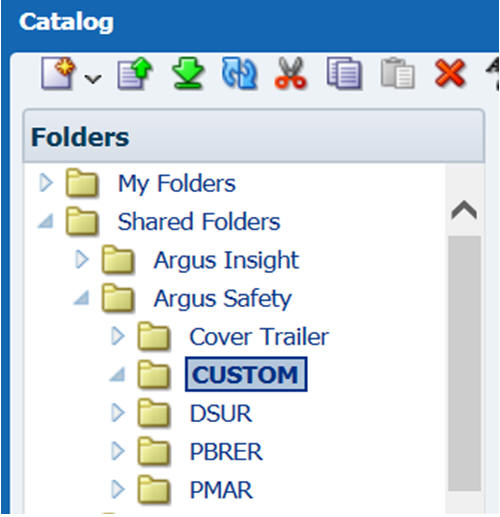

  5. Log in to BI Publisher and create a new folder under Argus Safety as per the value you entered in the REPPATH. In the example used, it is mentioned as CUSTOM and so the folder created is called CUSTOM.
    Description of customfolder.jpg follows
    Description of the illustration ''customfolder.jpg''

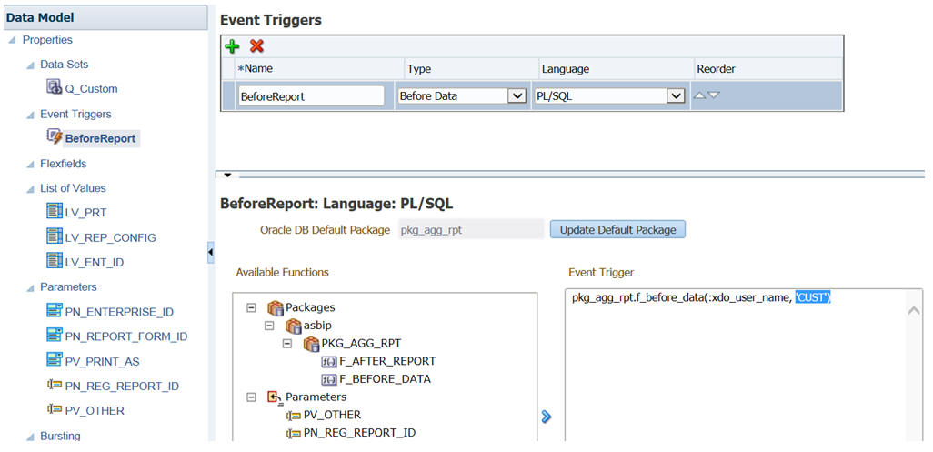

  6. You can prepare the custom data model and report template as per your requirements. You must ensure that the Before Report Event Trigger under Data Model contains the same value as mentioned in the REPTEMPLATE (such as CUST).
    Description of enttrig.jpg follows
    Description of the illustration ''enttrig.jpg''

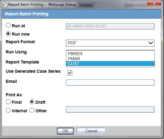

  7. Apply the changes and Save. Configure/create a report under Argus Safety Report configuration section and print/run the report. The new REPTEMPLATE value appears in the drop-down list.
    Description of repbtchprnt.jpg follows
    Description of the illustration ''repbtchprnt.jpg''
  8. Once the report is generated, you can take the output from the Argus Report Configuration.
    Description of genrep.jpg follows
    Description of the illustration ''genrep.jpg''
