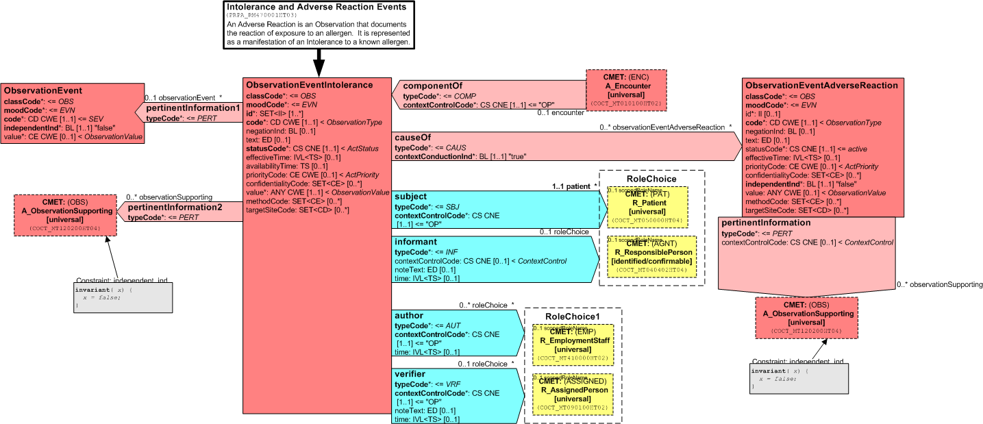

The Intolerance Observation Event RMIM documents a patients intolerance and reaction to an allergen. An Observation Intolerance Event Act is used to communicate both the allergy and adverse reaction information that is collected as part of the registration process. It includes information about the staff who documented and verified the intolerance, and the informant, either the patient itself or another responsible person. This data is modeled separately from the Patient Encounter so that it can be sent individually.
The following figure diagrams the Intolerance Observation Event RMIM:
Figure: 4.14.2-1 Intolerance Observation Event RMIM
