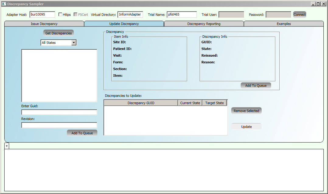

On the Update Discrepancies tab, you can display all discrepancies in a study, or only those discrepancies that are in a particular state.
  1. Start the Discrepancy Sampler tool and connect to a study.
  2. Select the Update Discrepancy tab.
    Update Discrepancy
  3. From the list of states, select the state of discrepancies to display, or select All States.
  4. Click Get Discrepancies.
    A list of discrepancies in the state you specified appears, listed by discrepancy GUID.
    Alternatively, you can use the Enter Guid and Revision fields to update a specific discrepancy.
  5. From the list of discrepancies, select a discrepancy GUID.
    Information about the item and its discrepancy appears.

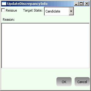

  6. To make changes to the selected discrepancy, click Add to Queue.
    The UpdateDiscrepancyInfo window appears.
    Embedded GIF File Template - 60%
  7. Make the changes you want and provide a reason, then click OK.
    The discrepancy appears in the Discrepancies to Update queue, listed by discrepancy GUID.
  8. For discrepancies in the queue, you can:
    • Make additional changes to a discrepancy—Double-click the discrepancy in the queue. The UpdateDiscrepancyInfo window reopens, where you can make your changes.
    • Remove a discrepancy from the queue—Right-click the discrepancy in the queue and click Remove Selected.
  9. To add more discrepancies to the queue, repeat steps 3 through 8.
  10. To update all the discrepancies in the queue, click Update.
    The Update response XML appears in a tab in the results pane, and the Discrepancies to Update queue becomes empty.
  11. Repeat the procedure to update additional discrepancies. All the discrepancies in the queue are processed and appear in a new tab in the results pane.
