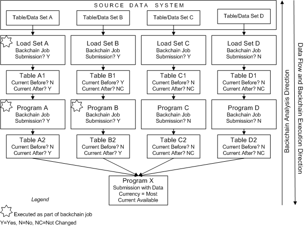

When at least one of the Programs or Load Sets that writes data to a Table instance that a Program instance reads from has a backchain Execution Setup defined and submitted, Oracle LSH displays "Most Current Available" as an allowed value for the Data Currency system parameter in the Execution Setup for the Program instance. When a user submits a job with the Data Currency parameter set to Most Current Available, the system invokes a backchain process that does the following:
  • The backchain process checks each Program or Load Set instance that writes to the job's source Table instances, looking for a job submission with the Submission Type system parameter set to Backchain. This is a backchain job submission. (To create a backchain job submission, create an Execution Setup with Submission Type set to Backchain and submit it for execution.)
  • For each Program instance with a backchain job submission, the backchain process checks each Program or Load Set instance that writes to its source Table instances to see if those Programs or Load Set instances also have a backchain job submission.
  • The backchain job continues to look farther and farther upstream each branch of the data flow until it reaches either the source data system or a Program or Load Set instance that does not have a backchain job submission.
  • On each branch, when the backchain job has gone as far upstream as it can, it compares the data currency of the source and target data of the last Program or Load Set that has a backchain job submission.
  • If the source data is more current than the target data, the backchain process executes the Program or Load Set instance to refresh the target data. The backchain job then executes the next Program to refresh its target data, and so on. Each job submitted by the backchain process uses the blinding and priority system parameter values set in the job submitted by the user with the data currency set to Most Current Data Available.
  • If the target data is already as current as the source data, the backchain job does not execute the Program or Load Set instance, but instead checks the source and target data currency of the next Program downstream, and so on. When it finds a Program whose target data is less current than its source data, the backchain job executes that Program instance and each subsequent Program instance.
  • When all branches with backchaining enabled have the most current possible data, the backchain job triggers the execution of the original job submitted (with Data Currency set to Most Current Available). See Figure 13-1, "Backchain Example".
Figure 13-1 Backchain Example
Description of Figure 13-1 follows
Description of ''Figure 13-1 Backchain Example''
In the example shown in Figure 13-1, the user submits Program X with the Data Currency system parameter set to Most Current Available. This submission starts a backchain process that checks all the Programs that populate the Table instances that Program X reads from for a backchain job submission. In this example, the backchain process finds that Programs A and B have backchain job submissions, but Programs C and D do not. The backchain process then checks the Load Sets that populate the source Table instances of Programs A and B for a backchain job submission. Load Sets A and B both have backchain job submissions.
The backchain process then checks the data currency of the Load Sets' source and target data. Load Set A's target data is less current than its source, but Load Set B's target data is current. The backchain process checks the data currency of Table B1 compared to Table B2, and finds that B2 is less current.
The backchain process executes Load Set A, and Table A1 becomes current. The backchain process executes Program A, and Table A2 becomes current. The backchain process executes Program B, and Table B2 becomes current. The backchain process then executes Program X, which then has the most current data available. However, because Programs C and D did not have backchain jobs submitted, Program X does not have the most current data from the source system for those streams. This is true even for stream C, where Load Set C has a backchain job submission but Program C does not.
Note that even if Table A2 is current in relation to its source Table before the backchain process, it becomes noncurrent after the execution of Load Set A updates Table A1. However, Program A then runs and Table A2 becomes current again.

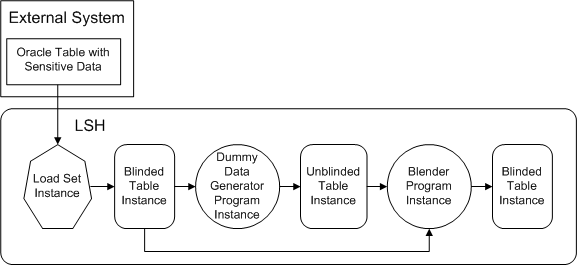

  • Create a Load Set to load all data from the source table, defining the target Table instance with its Blinding flag set to Yes and its Blinding Status set to Blinded.
  • Create a dummy data generator Program that reads from the Load Set's target Table instance and writes to a nonblinded Table instance with the same structure. The Program should retain the primary key column values but replace the data in all columns that contain sensitive data with dummy data. The target Table instance must have its Blinding flag set to No and its Blinding Status set to Authorized; see"Exception Authorization".
  • Create another Program that simply reads data and writes the data—with no changes—into another Table instance with the same structure, but with its Blinding flag set to Yes and its Blinding Status set to Blinded. Map the Program to two source Table instances: the blinded Load Set target Table instance and the nonblinded target Table instance of the first Program. Use a Parameter to determine which Table instance the Program reads from.
    To load real data into the blinded partition of the target Table instance, run this Program with its Blind Break system Parameter set to Real (Blind Break) and the Parameter you created set so that it reads from the blinded Table instance.
    To load dummy data into the dummy partition of the target Table instance, run this Program with its Blind Break system Parameter set to Dummy and the Parameter you created set so that it reads from the nonblinded Table instance.
    Blind Break privileges are required to run both Programs.

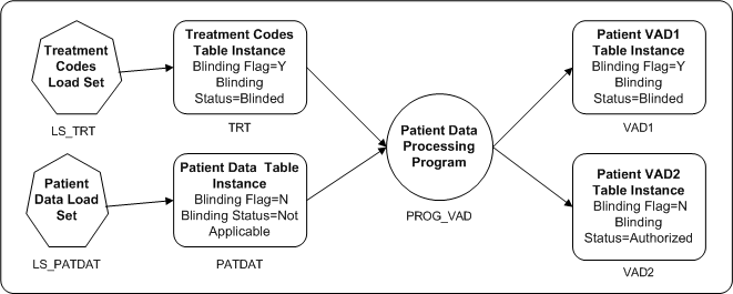

Normal Usage Oracle LSH requires that downstream Table instances have the Blinding flag set to Yes, but you must set the flag manually. Oracle LSH enforces the rule at runtime. If you attempt to run a Program that writes real data from a Table instance whose Blinding flag is set to Yes (with a Blinding Status of either Blinded or Unblinded) into a nonblinded Table instance (with its Blinding flag set to No and its Blinding Status set to Not Applicable)) the submission fails.
Exception Authorization There may be cases where you need to create a Program that reads from one or more blinded or unblinded Table instances and writes to one or more nonblinded Table instances; for examples, see "Loading Real and Dummy Data" and Figure 13-3 below.
In this case you must set the nonblinded target Table instance's Blinding flag to No and its Blinding Status to Authorized. The system then allows users with special privileges on the blinded or unblinded source Table instances to run the Program after confirming that it is safe.
Figure 13-3 Reading from a Blinded Table and Writing to a Nonblinded Table
Description of Figure 13-3 follows
Description of ''Figure 13-3 Reading from a Blinded Table and Writing to a Nonblinded Table''
In this example, one source Table instance contains treatment codes and is blinded. The other contains patient data and is not blinded. A Program reads from both Table instances, transforms data, and writes to two Table instances. One target Table instance, VAD1, combines patient data with treatment codes and must be blinded. However, target Table instance VAD2 does not include any treatment code information and does not need to be blinded.
Only users with Blind Break privileges can run PROG_VAD on real data as long as either Table instance TRT or VAD1 has a Blinding Status of Blinded. If the Blinding Status of both of Table instances changes to Unblinded, then users with Read Unblind privileges as well as those with Blind Break privileges can run PROG_VAD.
