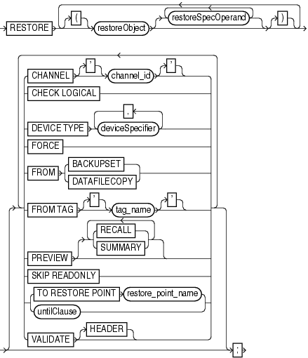

restore
This clause enables you to select which files you want to restore and specify parameters that control the behavior of the restore operation.
Syntax Element Description
restoreObject
Specifies the files to be restored.
restoreSpecOperand
Specifies options for the restoreObject clause.
CHANNEL channel_id Refer to the restoreSpecOperand clause.
CHECK LOGICAL Tests data and index blocks that pass physical corruption checks for logical corruption, for example, corruption of a row piece or index entry. If RMAN finds logical corruption, then it logs the block in the alert log and server session trace file.
If the total number of physical and logical corruptions detected in a file is less than its SET MAXCORRUPT setting, then the RMAN command completes and the database populates the V$DATABASE_BLOCK_CORRUPTION view with corrupt block ranges. If MAXCORRUPT is exceeded, then the command terminates without populating the views.
When restoring a backup data file, RMAN honors the DB_BLOCK_CHECKSUM initialization parameter setting. RMAN clears the checksum if DB_BLOCK_CHECKSUM is set to false. If set to typical, then RMAN verifies the checksum when restoring from the backup and writing to the data file. If the initialization parameter DB_BLOCK_CHECKSUM=typical, and if MAXCORRUPT is not set, then specifying CHECK LOGICAL detects all types of corruption that are possible to detect.
Note: The MAXCORRUPT setting represents the total number of physical and logical corruptions permitted on a file.
DEVICE TYPE deviceSpecifier Allocates automatic channels for the specified device type only. For example, if you configure automatic disk and tape channels, and issue RESTORE ... DEVICE TYPE DISK, then RMAN allocates only disk channels. You must have configured a device type by using CONFIGURE (except for DISK, which is preconfigured) before specifying the DEVICE TYPE option.
Note: You cannot manually allocate channels within a RUN block and then run RESTORE with the DEVICE TYPE clause.
See Also: deviceSpecifier
FORCE Overrides the restartable restore feature and restores all files regardless of whether they must be restored. If you do not specify FORCE, then RMAN restores a file only if its header information does not match the information in the control file.
FROM BACKUPSET Specifies that RMAN should restore from backup sets only. By default RESTORE chooses the file copy or backup set that needs the least media recovery.
If you use the FROM BACKUPSET option, then channels for the appropriate type of storage devices must be allocated for the backup sets that must be restored. For example, if needed backups are only available on tape, and no sbt channels have been allocated, then RMAN cannot find a candidate backup set to restore, and the RESTORE command fails.
FROM DATAFILECOPY Specifies that RMAN should restore data file copies only. By default RESTORE chooses the file copy or backup set that needs the least media recovery. If you use the FROM DATAFILECOPY option, then the allocated channels must be of DEVICE TYPE DISK.
FROM TAG tag_name Refer to the restoreSpecOperand clause.
PREVIEW Reports—but does not restore—the backups and archived redo log files that RMAN could use to restore and recover the database to the specified time. RMAN queries the metadata and does not actually read the backup files.
The RESTORE ... PREVIEW output is in the same format as the LIST BACKUP output (see Example 3-24).
Some media managers provide status information to RMAN about which backups are offsite. Offsite backups are stored in a remote location, such as a secure storage facility, and cannot be used without retrieving media.
Offsite backups are marked as AVAILABLE in the RMAN repository even though the media must be retrieved from storage before the backup can be restored. If RMAN attempts to restore a offsite backup, then the restore operation fails. RESTORE ... PREVIEW can identify backups needed for a RESTORE operation that are stored on media that requires retrieval. The output indicates whether backups are stored offsite.
If a needed backup is stored offsite, but the media manager does not support offsite backups, then your options are:
  • Use CHANGE ... UNAVAILABLE to prevent RMAN from selecting the needed offsite backups, and attempt the RESTORE ... PREVIEW operation again to determine whether RMAN selects another offsite backup. When RMAN does not select any offsite backups, you can perform the restore operation.
  • Use RESTORE ... PREVIEW with the RECALL option.
See Also: LIST, specifically the BACKUPS and SUMMARY options, and the RECOVER ... VALIDATE HEADER command
   RECALL Instructs the media manager to retrieve the backup media needed for the specified restore operation from offsite storage (see Example 3-25).
Note: This option only works if your media manager supports this functionality. You can use RESTORE ... PREVIEW periodically to monitor whether the needed backups are stored locally again.
   SUMMARY Summarizes the backups that RMAN would restore. The output is in the same format as the output of the LIST BACKUPS ... SUMMARY command.
SKIP READONLY Does not restore read-only files.
TO RESTORE POINT
restore_point_name
Specifies a restore point, with the SCN at which the restore point was created as the upper, inclusive limit. Because the limit is inclusive, RMAN selects only files that it can use to restore files up to and including the SCN corresponding to the restore point.
untilClause
Limits the selection to backup sets or file copies that are suitable for a point-in-time recovery to the specified time, SCN, or log sequence number.
In the absence of any other criteria, RMAN selects the most current file copy or backup set to restore. The time specified in the UNTIL clause must fall within the current database incarnation.
See Also: untilClause
VALIDATE Specifies that RMAN should decide which backup sets, data file copies, and archived redo log files must be restored, and then validate them (see Example 3-26). No files are restored.
For files on both disk and tape, RMAN reads all blocks in the backup piece or image copy. RMAN also validates offsite backups. The validation is identical to a real restore operation except that RMAN does not write output files.
Note: If you use RESTORE with the VALIDATE option, then the database can be open with data files online.
See Also: VALIDATE
   HEADER Reports and validates—but does not restore—the backups that RMAN could use to restore to the specified time.
When you specify this option, RMAN performs the same functions as when you run RESTORE with the PREVIEW option. However, in addition to listing the files needed for restore and recovery, RMAN validates the backup file headers to determine whether the files on disk or in the media management catalog correspond to the metadata in the RMAN repository.
See Also: The descriptions of the RESTORE PREVIEW option and the RECOVER ... VALIDATE HEADER option

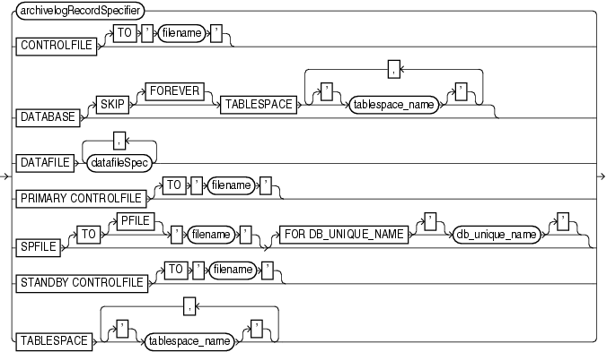

restoreObject
This subclause specifies the objects to be restored: control files, data files, archived redo log files, or the server parameter file. RMAN does not support backup and recovery of the change tracking file. RMAN re-creates the change tracking file after database restore and recovery; the next incremental backup after any recovery can use the file. Thus, restore and recovery has no user-visible effect on change tracking.
archivelogRecordSpecifier
Restores the specified range of archived redo log files.
The default restore location is DB_RECOVERY_FILE_DEST (if one of LOG_ARCHIVE_DEST_n is configured to USE_DB_RECOVERY_FILE_DEST either implicitly or explicitly). Otherwise, the default restore file names are constructed with the LOG_ARCHIVE_FORMAT and LOG_ARCHIVE_DEST_1 initialization parameters of the target database. These parameters combine in a port-specific fashion to derive the name of the restored log. You can override the default location with the SET ARCHIVELOG DESTINATION command.
Because the RECOVER command automatically restores archived redo log files as needed, you seldom need to restore logs manually. Possible reasons for manually restoring archived redo log files are to speed up recovery, to stage the logs to multiple destinations, or to analyze the log contents after a point-in-time recovery. To restore logs from a previous incarnation without shutting down the database, you can use RESTORE ARCHIVELOG with:
  • ... FROM SCN
  • ...SCN BETWEEN... AND
  • FROM SCN ... INCARNATION <integer>
  • FROM SCN... INCARNATION ALL
Note: The database can be started, mounted, or open for this operation.
See Also: archivelogRecordSpecifier.
CONTROLFILE Restores either a standby or backup control file depending on the target database role.
If the control file is lost, then restore the control file (see Table 3-9) and restore the database after mounting the restored control file. You must always run the RECOVER command after mounting a restored control file and you must open the database with the RESETLOGS option.
Note: If the target database is not mounted, and if RMAN is not connected to a recovery catalog, then you must specify the FROM AUTOBACKUP clause with RESTORE CONTROLFILE. If the autobackup is in a nondefault format, then first use the SET CONTROLFILE AUTOBACKUP FORMAT command to specify the format. If the target database is mounted or open, then you must specify the TO filename clause with RESTORE CONTROLFILE.
When you run RESTORE with a backup control file while connected to a recovery catalog (see Example 3-20), RMAN automatically updates the control file to reflect the structure of the restored database based on the metadata in the catalog.
   TO 'filename' Restores the control file to the specified file name.
Table 3-9 explains RMAN behavior when restoring the control file with the TO clause.
DATABASE Restores all data files in the database except those that are offline. By default, RMAN restores data file in read-only tablespaces.
Unlike BACKUP DATABASE, RESTORE DATABASE does not automatically include the control file and the server parameter file—you must issue additional RESTORE CONTROLFILE and RESTORE SPFILE commands to restore these files.
Note: To restore offline data files you must use RESTORE DATAFILE or RESTORE TABLESPACE.
   SKIP [FOREVER]
   TABLESPACE
   tablespace_name
Excludes the specifies tablespaces from the restore operation. This option is useful to avoid restoring tablespaces containing temporary data.
Specifying the FOREVER keyword does not change the behavior of SKIP. The FOREVER keyword exists solely to maintain compatible syntax between RESTORE SKIP FOREVER and RECOVER SKIP FOREVER.
DATAFILE datafileSpec Restores the data files specified by file name or absolute data file number (see Example 3-19).
Note: Do not specify a data file more than once in a restore job. For example, the following command is invalid because data file 1 is both specified explicitly and implied by the SYSTEM tablespace:
RESTORE TABLESPACE SYSTEM DATAFILE 1;
See Also: datafileSpec
PRIMARY CONTROLFILE Restores a control file for a primary database in a Data Guard environment.
RMAN restores either a normal or standby control file as appropriate, depending on the most recent database role known to the recovery catalog (RC_SITE.DATABASE_ROLE) for the target database. The purpose of this option to override the default setting in cases where the most recent database role is out-of-date.
Assume that you perform a switchover from primary database dgny to standby database dgsf, so that dgsf is the new primary database. You want to restore a control file on dgsf, but the recovery catalog was not resynchronized and still shows dgsf as a standby database. In this case, you can specify PRIMARY CONTROLFILE to override the default RMAN behavior and restore a normal control file.
SPFILE Restores a primary or standby server parameter file to the location from which it was backed up. RMAN cannot overwrite a server parameter file currently in use by the target database.
By default RMAN restores the most current server parameter file. Specify the UNTIL or TAG options to restore older versions of the server parameter file.
If the server parameter file is lost, then connect RMAN to the target database (and recovery catalog if used) and run SET DBID. Run STARTUP FORCE NOMOUNT before running RESTORE SPFILE. Then run STARTUP FORCE to restart the database instance with the restored server parameter file.
Note: If the target database is not mounted, and if RMAN is not connected to a recovery catalog, then you must specify the FROM AUTOBACKUP clause with RESTORE SPFILE. If the autobackup is in a nondefault format, then first use the SET CONTROLFILE AUTOBACKUP FORMAT command to specify the format. If the target database is started, mounted, or open, and if the database was started with a server parameter file, then you must specify the TO filename clause with RESTORE SPFILE.
   TO [PFILE] 'filename' Restores a primary or standby server parameter file to the location specified by the TO clause. Specify PFILE to save the server parameter file as a text-based initialization parameter file.
   FOR DB_UNIQUE_NAME
   db_unique_name
Specifies the DB_UNIQUE_NAME for the target database when the instance is not started. This parameter is only useful in a Data Guard environment.
When FOR DB_UNIQUE_NAME is specified, RMAN can locate the correct RMAN configurations for the host on which the SPFILE is being restored and use them to access backup devices. Otherwise, RMAN cannot choose the correct channel configurations and returns an RMAN-6758 error.
In a Data Guard environment, the primary and standby hosts may have different channel configurations for communicating with their associated SBT backup and disk devices. If both the primary and standby databases are known to the recovery catalog, then the configuration settings for both databases are recorded in the recovery catalog. Because the two databases have the same DB_NAME, the records in the recovery catalog can only be distinguished with the DB_UNIQUE_NAME initialization parameter.
Note: Using RESTORE SPFILE when the DB_NAME is not unique in the recovery catalog produces an RMAN-6758 error.
See Also: Oracle Data Guard Concepts and Administration for a detailed procedure for restoring the server parameter file in a Data Guard environment
   TO 'filename' Restores the standby control file to the specified file name. Table 3-9 explains the RMAN behavior when restoring the control file with the TO clause.
STANDBY CONTROLFILE Restores a control file for a standby database. RMAN can transparently restore a normal control file backup and make it usable for a standby database.
RMAN restores either a normal or standby control file as appropriate, depending on the most recent database role known to the recovery catalog (RC_SITE.DATABASE_ROLE) for the target database. The purpose of this option to override the default setting in cases where the most recent database role is out-of-date. Assume that you perform a switchover from primary database dgny to standby database dgsf, so that dgsf is the new primary database. Later, you make dgny a standby database for dgsf. You want to restore a control file on dgny, but the recovery catalog was not resynchronized and still shows dgny as a primary database. In this case, you can specify STANDBY CONTROLFILE to override the default RMAN behavior and restore a standby control file.
If you restore the control file of a database whose DB_UNIQUE_NAME is known to the recovery catalog, then RMAN updates all file names in the control file to file names known to the recovery catalog. Any file names explicitly renamed with ALTER DATABASE RENAME FILE take precedence over the file names in the recovery catalog.
See Also: Table 3-9 for restrictions and usage notes
Note: You must always run the RECOVER command after mounting a restored control file, and must also always open the database with the RESETLOGS option.
TABLESPACE tablespace_name Restores all data files in the specified tablespaces (see Example 3-18).
RMAN translates the tablespace name internally into a list of data files. If you rename a tablespace (for example, from users to customers), then so long as an additional tablespace with the old name (users) has not been created, you can use either the old name (users) or the new name (customers) for the tablespace. RMAN detects that the tablespace has changed its name and updates the recovery catalog on the next resynchronization.
Note: RMAN can back up and restore dictionary-managed temporary tablespaces, but it cannot back up locally managed temporary tablespaces. However, RMAN automatically re-creates locally managed temporary tablespaces after restoring the database.
restoreSpecOperand
This subclause specifies options for the restoreObject clause. These parameters override the parameters with the same name at the RESTORE command level.
CHANNEL channel_id Specifies the case-sensitive name of a channel to use for this restore operation. If you do not specify a channel, then RESTORE uses any available channel allocated with the correct device type.
FROM AUTOBACKUP Restores a control file autobackup (see Example 3-21).
This option is only valid on the RESTORE CONTROLFILE and RESTORE SPFILE commands. When restoring either type of file in NOCATALOG mode, the FROM AUTOBACKUP clause is required.
RMAN begins the search on the current day or on the day specified with the SET UNTIL. On the first day searched, the search begins with sequence number 256 (or the sequence number specified by MAXSEQ, if provided) and counts back to sequence 0. If no autobackup is found in the current or SET UNTIL day, then RMAN checks preceding days, starting with sequence 256 and counting back to 0. The search continues up to MAXDAYS days (default of 7, maximum of 366) prior to the current or SET UNTIL day. If no autobackup is found within MAXDAYS days, then RMAN signals an error and the command stops.
See Also: Table 3-9 for restrictions and usage notes.
   autoBackupOptList
Specifies parameters that control the search for a control file autobackup.
   'media_handle' Specifies the name of the control file copy or backup piece containing a control file. The media_handle can be any backup piece that contains a backup of a control file: the control file backup does not need to be an autobackup.
FROM TAG tag_name Overrides the default selection of the most recent backups or file copy available. The tag restricts the automatic selection to backup sets or file copies created with the specified tag. If multiple backup sets or copies have a matching tag, then RMAN selects the most recent one. Tag names are not case sensitive.
See Also: BACKUP for a description of how a tag can be applied to an individual copy of a duplexed backup set, and for a description of the default file name format for tags.
autoBackupOptList
This subclause specifies parameters that control the search for a control file autobackup.
DB_NAME database_name Provides a DB_NAME to be used in searching for control file autobackups. See Table 3-10 to determine when to set this parameter.
The default value of the DB_UNIQUE_NAME initialization parameter is the DB_NAME initialization parameter setting. If no DB_UNIQUE_NAME initialization parameter is set for a target database, then use either RESTORE ... DB_NAME or RESTORE ... DB_UNIQUE_NAME. If the DB_UNIQUE_NAME initialization parameter setting for a target database is different from DB_NAME, then use RESTORE ... DB_UNIQUE_NAME.
MAXDAYS integer Limits the search for a control file autobackup within the specified number of days earlier.
MAXSEQ integer Specifies the highest sequence number for the control file autobackup search.
RECOVERY AREA 'pathname' Specifies a path to the fast recovery area to search for autobackups. RECOVERY AREA and DB_RECOVERY_FILE_DEST are synonyms. See Table 3-10 to determine when to set this parameter.
'pathname'
   DB_NAME
   database_name
   DB_UNIQUE_NAME
   db_unique_name
Specifies the DB_UNIQUE_NAME of the database in the specified fast recovery area that is the target of the restore operation.
