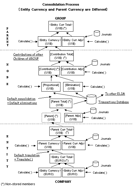

The first example shows the process when the entity currency and the parent currency are different.
Overview of the consolidation process, described in the text preceding the image.

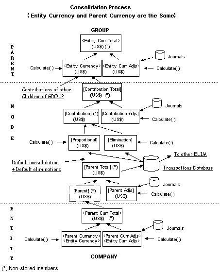

The following example shows the process when the entity currency and the parent currency are the same.
Example of consolidation process where entity and parent currency are the same.
