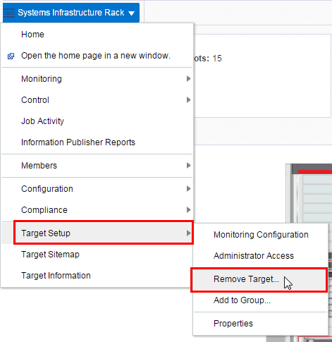

36.7.4 Delete a Rack
The rack can be removed in Enterprise Manager without targets placed in it. If the rack target is deleted and the rack contains targets placed in it, you will be asked if you want to remove the targets from Enterprise Manager.
Perform the following steps to delete a rack:
  1. In the rack landing page, click the Target menu drop-down list.
  2. Click Target Setup, then click Remove Target.
  3. If you want remove targets placed in rack along with the removed rack, select “Remove all targets associated to target Rack”. List of targets placed in rack will be shown.
  4. Some targets cannot be removed. Such targets have a red cross in the column Removal Details including a reason as to why target cannot be removed. Unremovable targets will not be removed when rack target is removed.
  5. Some targets provide a custom removal flow (like SNMP monitoring unsubscription). Such targets have a yellow exclamation mark in the column Removal Details. If you want to remove a target with a custom removal flow, go to the target’s landing page and remove the target from there. If you don't remove targets with a custom removal flow, they will be removed along with rack without custom removal options available in their removal flows.
  6. Click Yes to confirm. The rack is deleted with or without the assigned targets depending on your selection.
